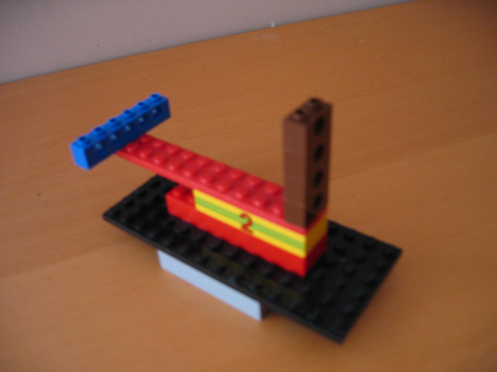

I just builded this 5 minutes ago and it is pretty simple:
4 degrees of angle and 2 of wind deviation
To aim in front of you, look in the first stage of the brown"tower" and in the middle of the blue lego piece.
To aim far, look in stage 2,3 or 4 of the brown "tower"
To calculate wind deviation, look in stage 1,2,3 or 4 of the brown tower(depends of situation)and one of the left or right hole of the blue lego piece.
If you dont understand just ask.
The trajectory calculator.

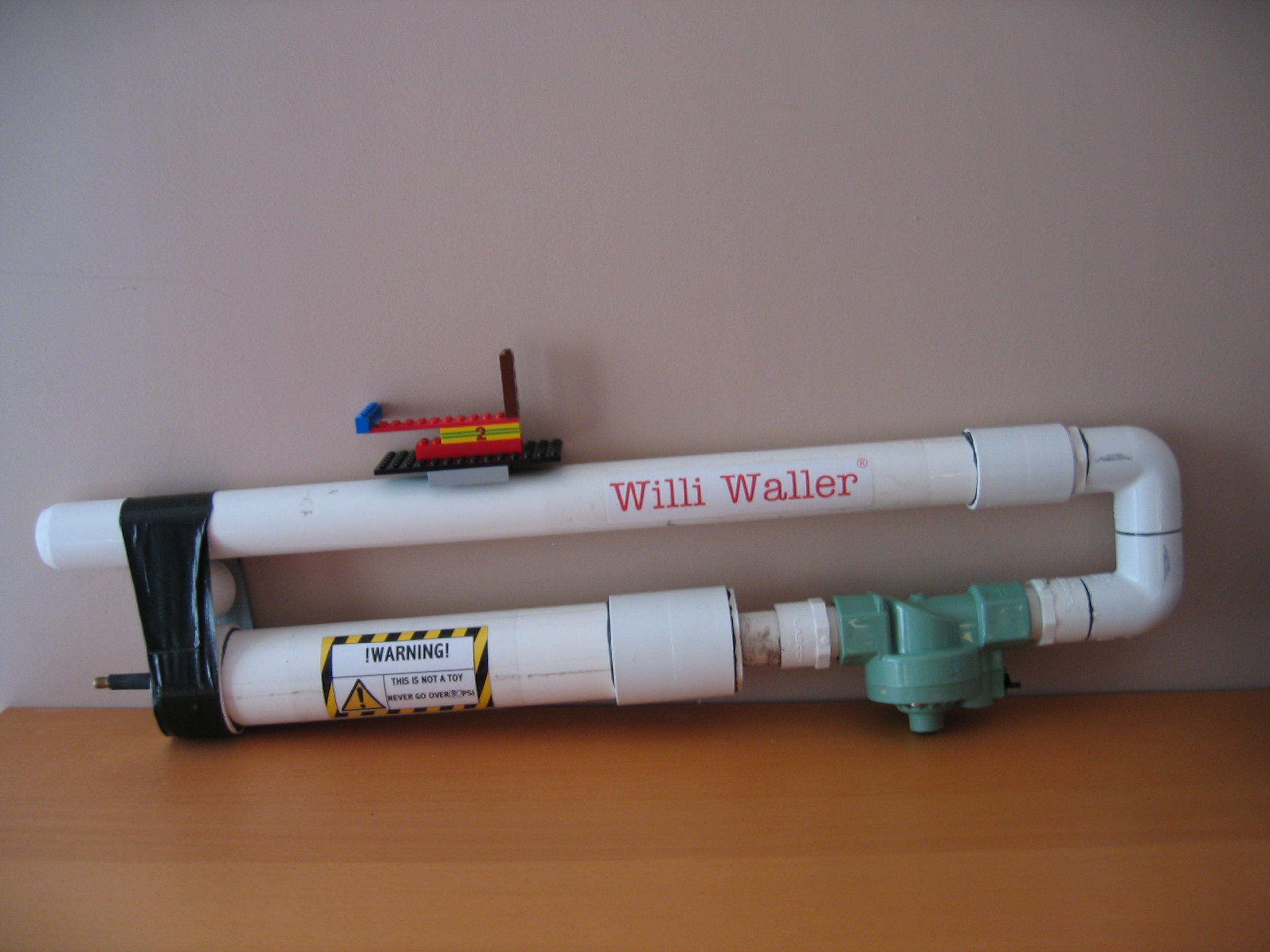

The potato trajectory calulator on my Willi Waller.(the valve is broken).

Why not call it "lego sight"? I was thinking you had built some mad contraption of slide rules and indece markers using legos...

Interesting, however the front and rear elements are too close together for the system to be practical.

Fair enough, though there you have around 30º range of windage, and the sort of elevation that one would find on a grenade launcher :roll: unless you're shooting lead bricks in a hurricane I think one would appreciate greater separation that would allow for finer adjustment of aim.

What you see is the "old version",now i had added a movement so you can pull down or up the rear sight, like in real guns 8)

Oh, and Demon, booo! to all the dead space in your cannon! And what exactly does the suspiciously double entendre moniker signify?
Ok so how can i reduce the dead space without making it too long?
And the ratio, elbow included is 1:1.
The valve could be up behind the barrel, rather than behind the chamber - this makes the elbows part of the chamber volume instead of dead space.
Alternately, as the flow of a sprinkler is limited anyway, lower bore elbows would reduce the dead space, but without noticeable flow loss (provided their size was above a certain lower bound) - which would probably improve performance.
It's probably not feasible to rebuild your cannon now anyway, but they are things to consider should you build another.
