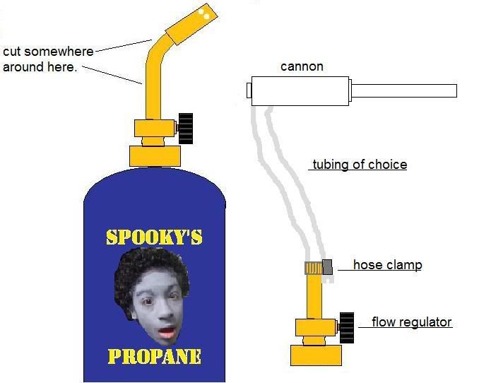

they way i do it is saw off the top half of the brass torch fitting that comes with it. sand the rough, sharp edges to a smooth surface. push one end of some plastic tubing over it and secure it with a hose clamp. secure the other end (also with a hose clamp) to what ever u want to pressurize. i usually get the tall blue cylinder but the torch fitting should still fit perfectly on the short green one.
<a href="http://s90.photobucket.com/albums/k273/ ... ankmod.jpg" target="_blank"><img src="http://i90.photobucket.com/albums/k273/ ... ankmod.jpg" border="0" alt="Photobucket"></a> if u want more flow from the flow regulator i can find some old pic of mine to show u how. i hope this was helpful.
WHY PAY FOR IT WHEN U CAN MAKE IT?

i-will wrote:they way i do it is saw off the top half of the brass torch fitting that comes with it. sand the rough, sharp edges to a smooth surface. push one end of some plastic tubing over it and secure it with a hose clamp. secure the other end (also with a hose clamp) to what ever u want to pressurize. i usually get the tall blue cylinder but the torch fitting should still fit perfectly on the short green one.
You don't have to saw it off. You can use 2 pipe wrenches and unscrew that pipe out of valve unit. It will be stuck in there really well so be prepared to grip hard and muscle the wrenches...you here the adhesive "snap". Use a 1/4" male tube compression to 1/4" male NPT brass adapter to screw into the valve (with teflon tape of course). Works great!!
