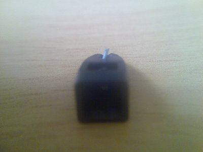

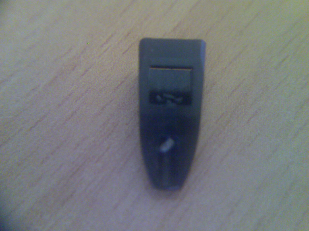

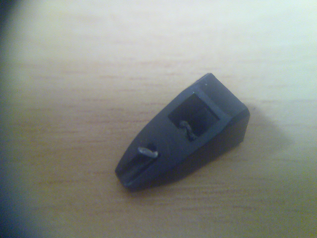

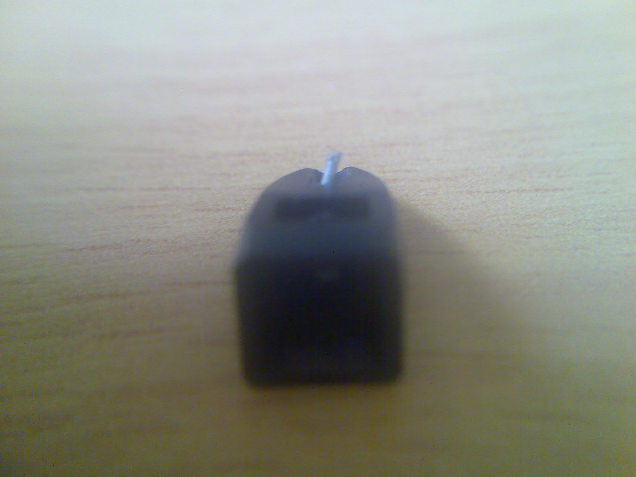

I'll get a picture up later on. It looks bent or out of alingment to me, but then again I don't know a helluva lot 'bout turntables.

Here's some pictures, my camera ran out of batteries so I used my phone and a pocket knife magnifying glass :P
