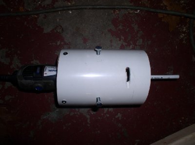

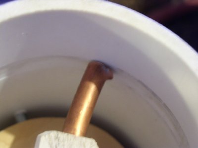

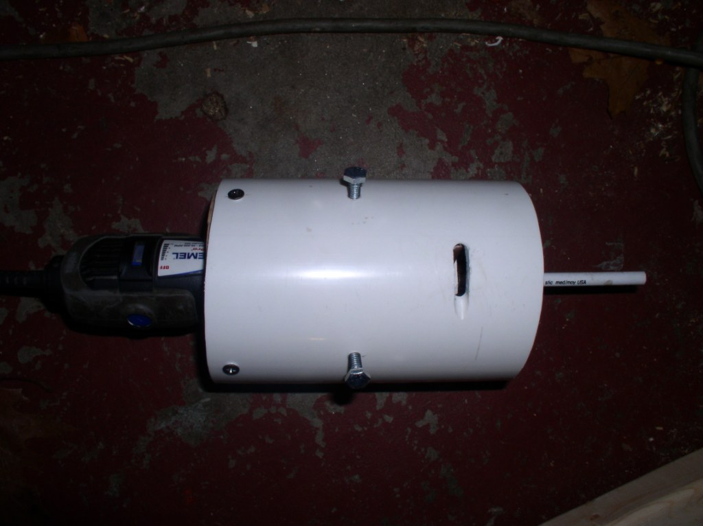

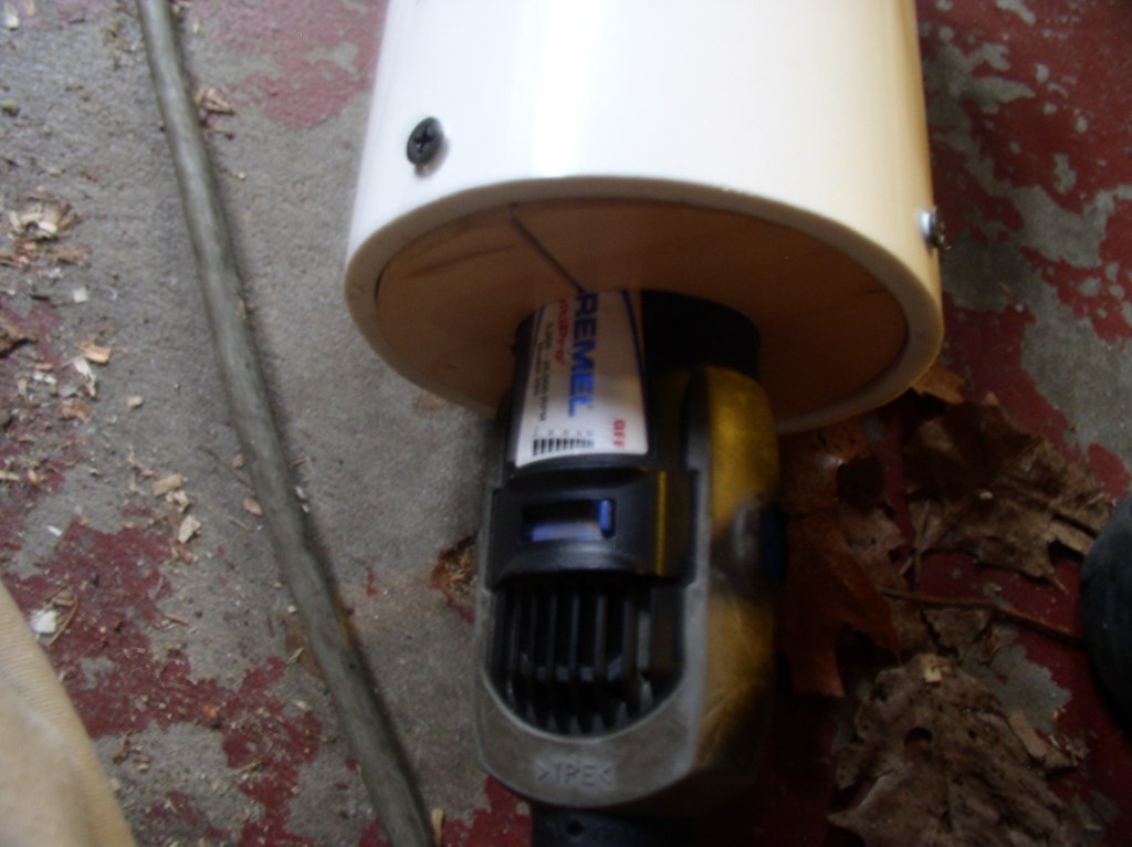

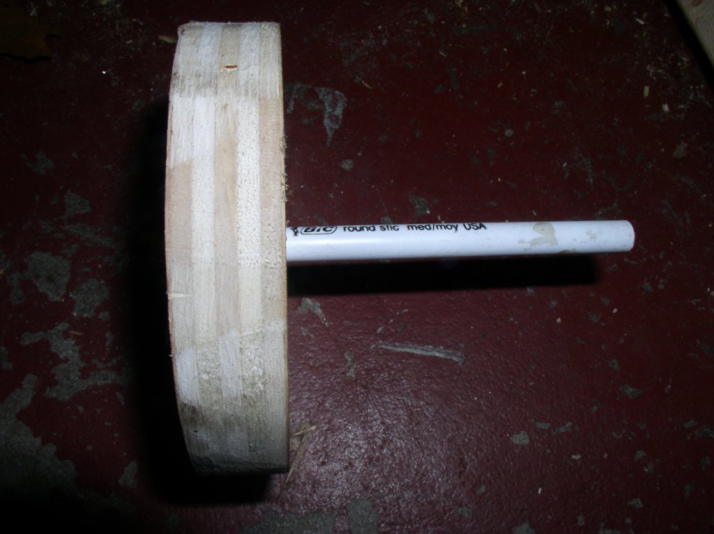

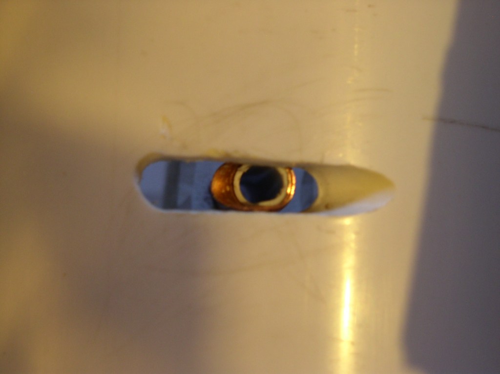

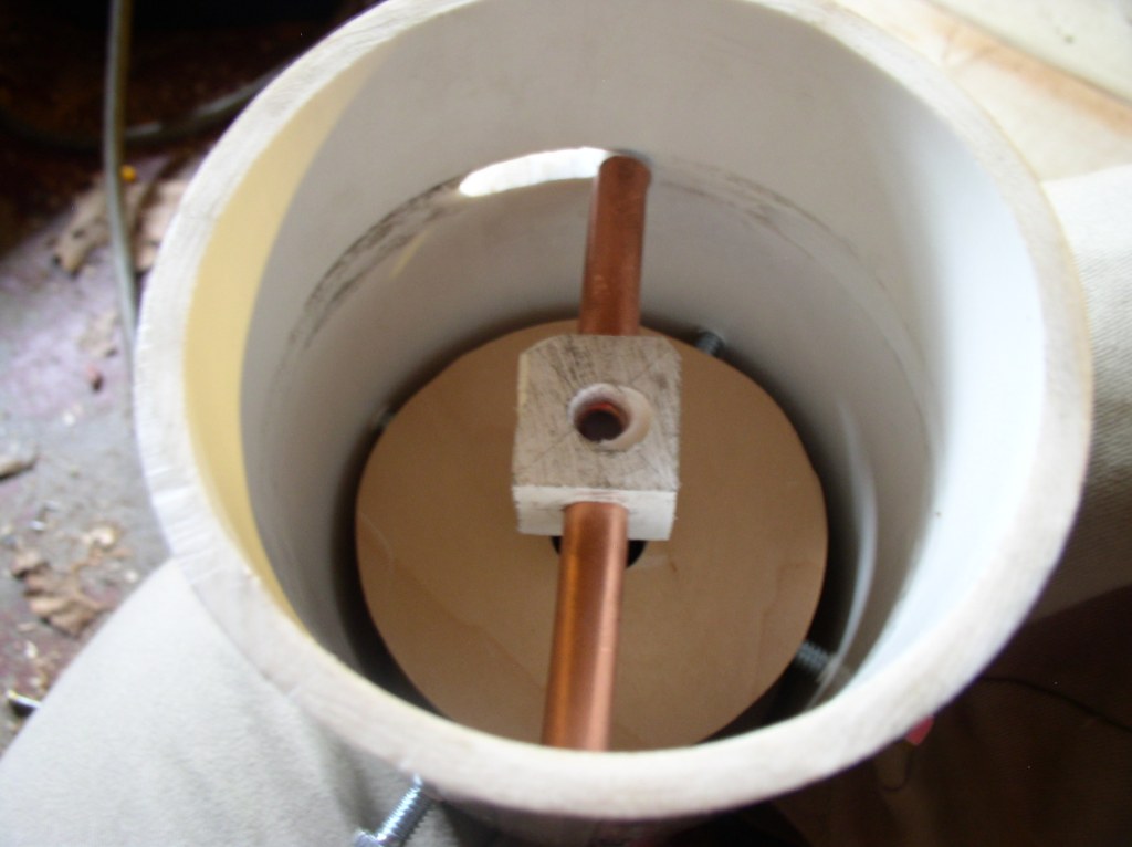

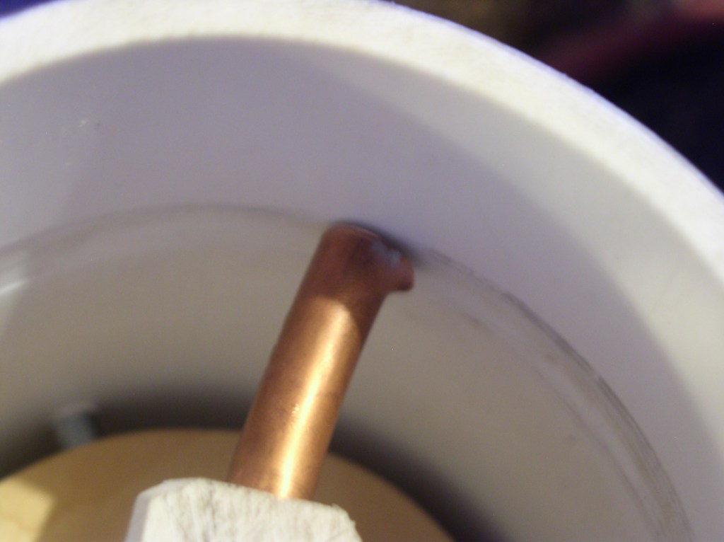

After seeing the Mythbuster's confederate steam machine gun I considered the idea for a airsoft gun using the same principal. First of all I have condemned this idea temporarily because it is horribly inefficient and would chew through a battery pack pretty quick. It's powered by a Dremel rotary tool that has a max no load speed of 35,000 rpm, but the gun starts to destroy itself when pushed beyond 2/3 throttle. The barrel is made of copper tubing sleeved over a bic pen body. The drive block is made of Azec PVC outdoor molding (it's like a really dense PVC foam). Those four bolts push on a collar the goes around the neck of the Dremel to center it and stop the barrel from rubbing on the guard. One problem is that BBs hit the exit slot and destroy the end of the barrel but for some reason the gun never stops running even when they get jammed. All in all is has lots of flaws but it's current state is what it will stay for some time.

-------velocity: about 100 fps at 2/3 throttle
---rate of fire: as fast as I can put them in but each shot slows the rpms down
power source: 120v AC (limits mobility to the longest extension cord)
-----accuracy: poor and has hopside
barrel length: 3 in total 1.5 that the BB travels through
the gun
the gun
Demel attachment
Demel attachment
gun internals
gun internals

damage done by BBs getting stuck in exit slot
damage done by BBs getting stuck in exit slot <br />note:normally the barrel and exit slot are aligned

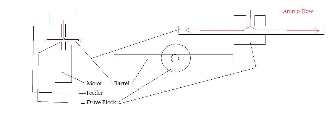

Sorry, but how exactly does fire the BBs?

newbmatic:
like this
like this
Centri Dra.jpg (31.4 KiB) Viewed 6821 times
