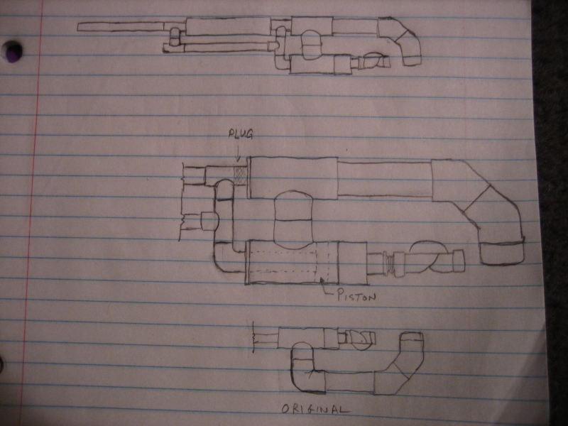

I'm working on a new spud cannon design and was wondering something. Is there any disadvantage of putting bends in your barrel vs. a straight barrel? I'm planing on putting a couple 90 degree bends in my barrel and was wondering if this would decrease its performance.

Lol, if you plan on shooting the projectile through the two 90 ° (which i wish you good luck with) , you'll end up with two unuseable elbows. If in the contrary you just wanna do this for a design matter, it will work, but it will add dead space between the valve and the projectile. This is not bad in itself, but it will decrease the performance.
Bends in your barrel or in your chamber? Your little drawing there is useless.
The over and under design is common and uses some 90 bends out of the chamber to the valve or piston, which then powers a straight barrel.
Not going to work, the projectile will just slam through the first elbow. At best you can get away with a gentle curve, like the krummlauf:

I think he's talking about introducing air into the barrel through elbows, not firing the actual projectile through the elbows. I may be wrong.
But if you plan on shooting a projectile through elbows, forget it.
If you plan on redirecting air using elbows, it will work but with reduced power.

yeah, you hit the nail on the head. So the dead space between the valve and projectile is the main issue. Are we talking about a significant decrease in performance or something that would hardly be noticeable by the naked eye? So lets say a straight barrel is 100% efficient, then what would you say a barrel with 2 90 degree elbows in it be (85-90%) ????CpTn_lAw wrote:If in the contrary you just wanna do this for a design matter, it will work, but it will add dead space between the valve and the projectile. This is not bad in itself, but it will decrease the performance.

Both the dead space and the way the air has to redirect itself twice will reduce performance a little, but it shouldn't be too bad.
The reason people got confused was because you kept calling the whole thing, elbows included, the barrel. Generally we think of the barrel as the part the projectile actually travels through, and any other piping attached between it and the valve is just additional piping.

Here's a quick sketch of my design. The top picture is the overall concept. You can see in the blow up the valve is at the bottom. When the piston opens, the air travels through the pipe taking a 90 turn up and then through the 'T' which is plugged at the back to direct the air forward where the projectile will be waiting. The bottom picture is my original design which you can see here
The new design is basically my original turned upside down, thus the need to redirect the barrel to bring it back up to the top. The only reason for this change is to bring the solid part of the chamber to the top so I have a place to rest my cheek when the gun is at my shoulder. Before, I would have to place my cheek on the sprinkler valve and when it opened, the air coming out would be right at my ear which is very loud.
The rail you see under the barrel will be used as a guide for my pump action reload I am working on.
Any comments or suggestions on the new design would be greatly welcomed.

About your design:
There COULD be flow restriction if your valve porting and "dead space" is less in diameter then your barrel.
About your design:

looks okay by me...
dead space is not as bad a thing as most people make it out to be, a lot of old powder burner howitzers had an air chamber behind the powder area to allow the gasses a place to expand a bit before acting on the projectile, which allowed for a full force hit rather than a push.
and while air cannon and their powder burning brothers have little internal ballistics in common, I've had problems with my zero dead space cannon shredding projectiles rather than shooting them.
what's the projectile this cannon is being designed to shoot, or did I miss that?

No you didn't miss it. My plan is to shoot marbles with it. Using a 1" barrel for large marbles and a 1/2" barrel insert for smaller marbles. So there should be no fear of shredding the projectile as you had mentioned.judgment_arms wrote:looks okay by me...
