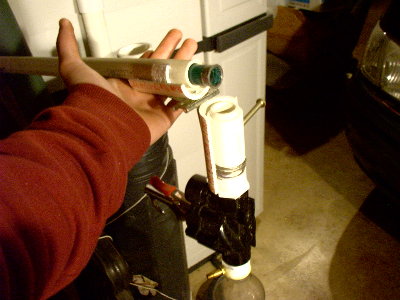

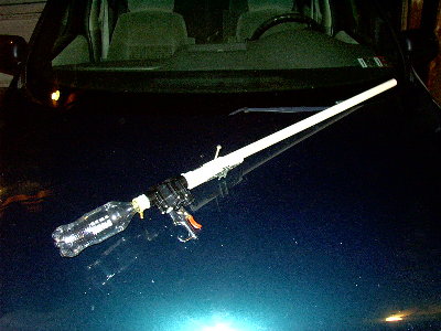

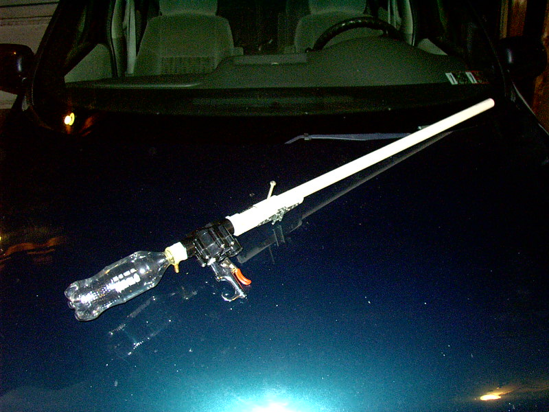

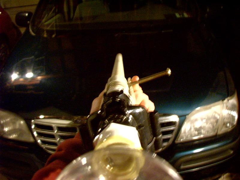

i made this for airsoft since i didnt have money for a new gun. it uses empty shotgun shells with the backs drilled out full of bbs and some wadding. im pretty proud of my engineering on the break barrel system. it is spring loaded and well-greased so i could get reload time down to about 4-5 seconds.
i use it at only about 30 psi because any more and my friends said it started to hurt. i had a simple backpack air supply that i could get about 8-10 shots with. it gets some good range and a decent grouping of bbs i think cause the barrel is pretty long. definitely worth the $20 i spent on it. questions/comments?

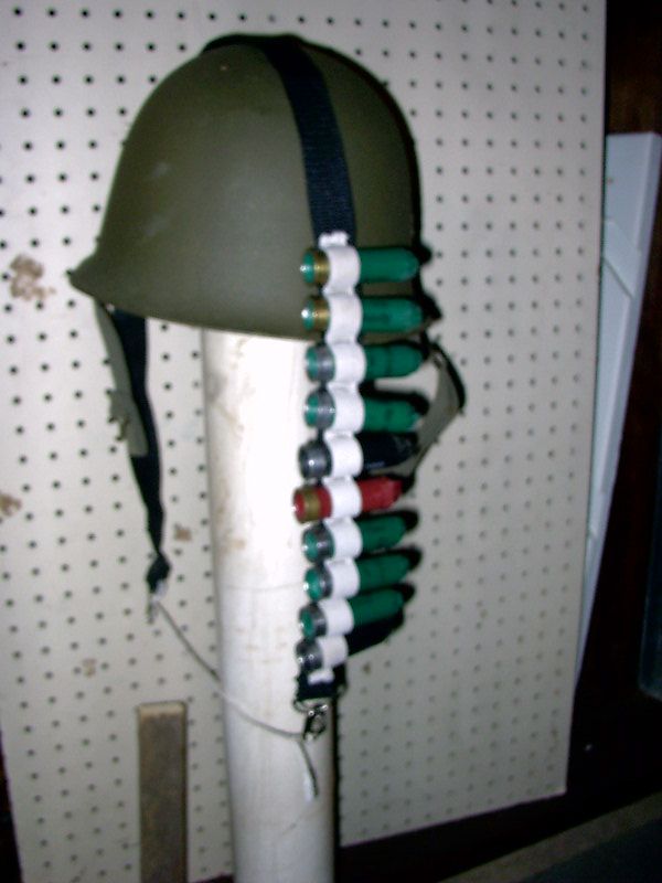

homemade bandolier
homemade bandolier

i filled it up from an old fire extinguisher tank at ~120psi regulated to 30 with a hose connected to the gun. i had to pump up the tank between rounds of airsoft.
its 3/4" pipe with 12 gauge shells.
the body of the shell fits perfectly but the rim at the back is slightly larger so it keeps the whole shell from shooting out.
