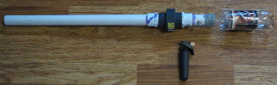

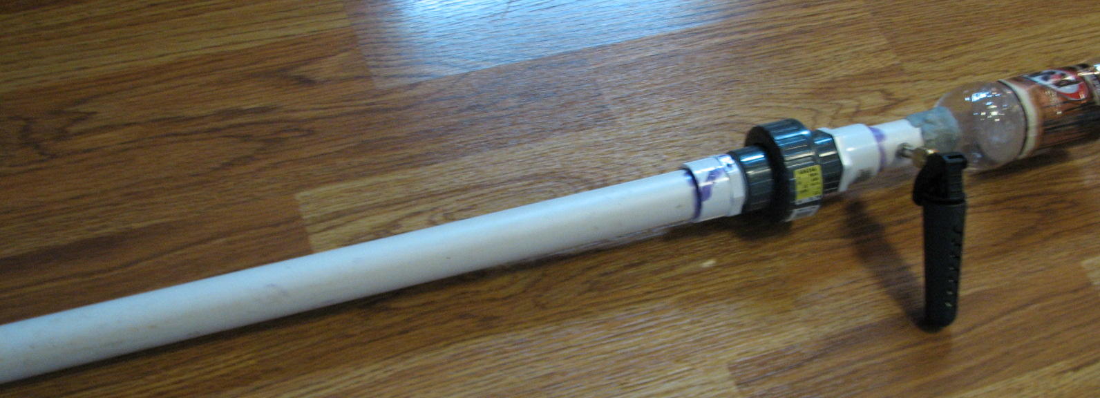

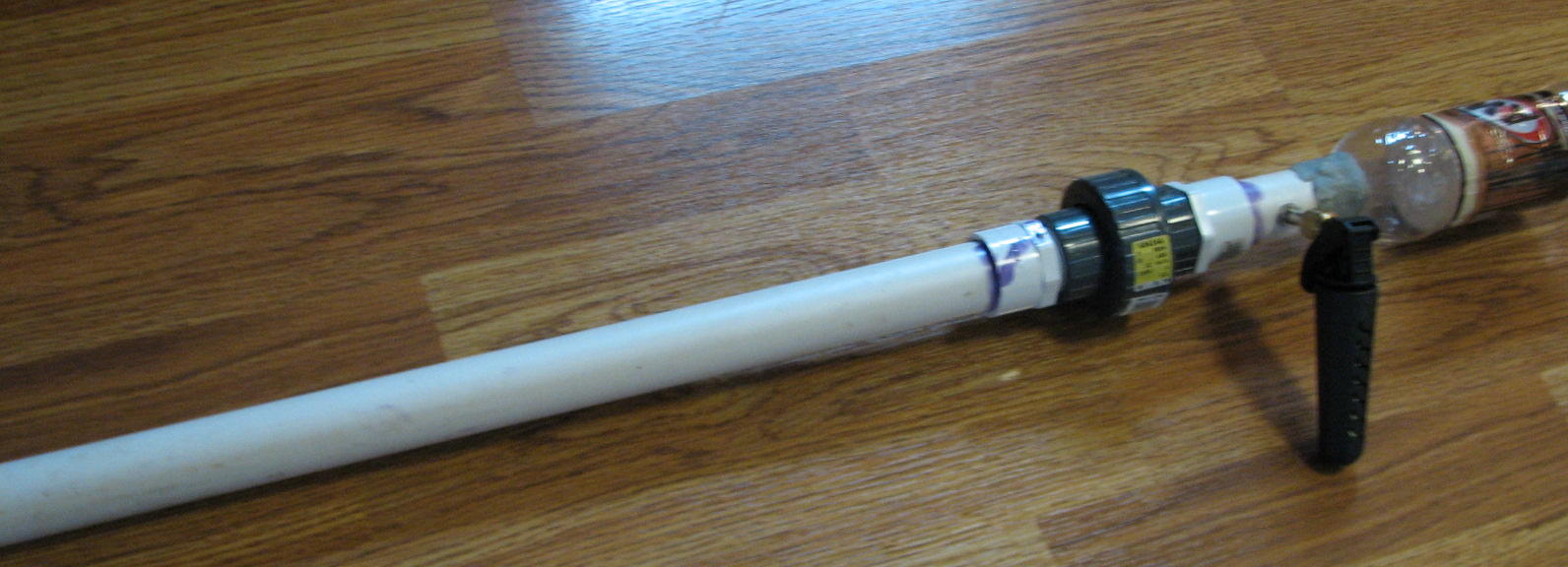

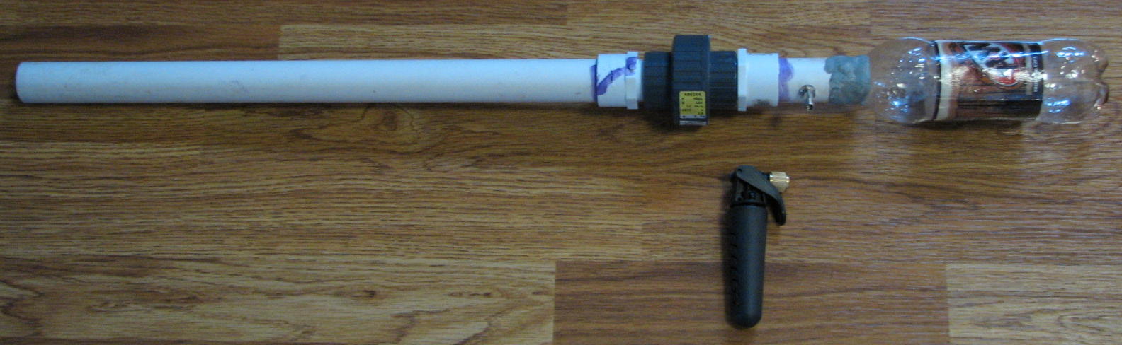

I made this gun because I was bored and had most of the parts lying around. I trigger it with a 12g CO2 tire inflater. The whole gun cost under $5 all i had to buy was the union and the 1" male adapters. Right now I am using 5 layers of aluminum foil as my burst disk. They generally burst around 65 psi. Don't get onto me for using a soda bottle as a chamber. I just used it because it was available . They can hold 125 psi, and I only go to 65 psi.
Specs
Valve: Burst Disk
Barrel: 18" x 1" barrel
Chamber: 16.9 oz. A and W bottle
Fill valve: Schrader valve
Trigger: 12g CO2 tire inflater
Burst Disk Cannon
My compliments on your choice of A&W root beer... 8)
However I will get on to you for using it as a pneumatic chamber. Spend another $5 (or less) and replace it with some 2" sched 40, bushing and endcap.

Does this mean that the soda bottle chamber is temporarly?Don't get onto me for using a soda bottle as a chamber. I just used it because it was available
Would love to see the bottle replaced with a chunk of PVC on its rear end.
On 125 psi this thing will pack a good punch.
Actually, I've heard that if you just take some chicken wire, or gutter mesh, you can wrap it around the bottle a few times, and cover it in duct or electrical tape.
This would help prevent the risk of shrapnel by a lot in case the thing ever explodes.
Not saying that you shouldn't get a pvc airtank (that's the FIRST thing you should do), but in case you don't have the money right now or other unknown reasons, it is an excellent alternative.
Not necessarily, a stronger burst disk for the same chamber size will definitely give you more power however. For a given quantity of air, small volume/high pressure will give you more power than large volume/low pressure, there's some data in this thread.ilovetoblowthingsup wrote:You can make the chamber bigger, and thus more power
Shrapnel isn't really an issue when PET bottles explode, they tend to tear as opposed to shattering. The best protection you need in that situation is a good set of earplugsThis would help prevent the risk of shrapnel by a lot in case the thing ever explodes.
