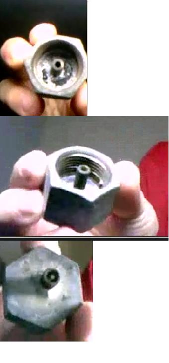

Last night while making my chamber i brazed a tire valve into a hole at the end cap of my iron chamber. When i was done and everything had cooled i inspected the valve and noticed it was broken, i fixed the problem with a checkvalve from a pump which screwed on but i would like to know why the sharder broke and if i could fix it:
The sharder is brazed onto a tapped iron end cap. there is white and black residue on the inside which i noticed after brazing. The rubber at the bottom of the sharder has bin removed and i used a silver based brazing rod with a melting point of 690°C. There was some smoke while soldering but i suspected it was simply the rest of the rubber burning off, which in turn happened. The part which has to be pressed does inoreder to release the pressure inside the bike(or inorder to fill it) moves around freely when i shake it. When i blow into the valve it is slightly easyer to blow than to pull. Pictures will be attached, note it is night time here and i am in underwear incase some one might be disturbed by this i mentioned it now before things being too late:

- These are a few pics i took using my web cam, i hope they help.

The schrader valve is a metal tube threaded inside and out with a small sprung poppet valve that screws down inside it.
The metal outer tube will not take notable damage from being brazed, the poppet valve insert will however, the spring inside may lose its strength and the seals will certainly melt or burn.

No, it probably can't be fixed, although you could try again with another schrader, but this time, extract the internal parts before you braze it, then put it together after it's all cooled.
If you get a set of long nosed pliers, then you should be able to reach into the end of the valve and unscrew/remove the heat-vulnerable parts. Screw them back in again when you're done.

Because you exposed it to the heat of brazing - there are rubber parts in those that can and will be destroyed by high temperatures.john bunsenburner wrote:but i would like to know why the sharder broke and if i could fix it.

If you have a second schrader, you might be able to swap the internals of them over and fix the first one.john bunsenburner wrote:@rag: Is there something besides a checkvalve, like a second sharder or something that i could screw ontop of the broken sharder and have a funtioning valve or not?

EDIT: Dang I type slow! The internals unscrew by turning the flat sides of the pin. once you unscrew it it's pretty self explanatory.

You obviously melted the rubber sealing parts inside the schrader. Most of the non-tire type schraders are threaded so you should plan to drill and tap or cement (JB Weld) and not braze your schrader.
