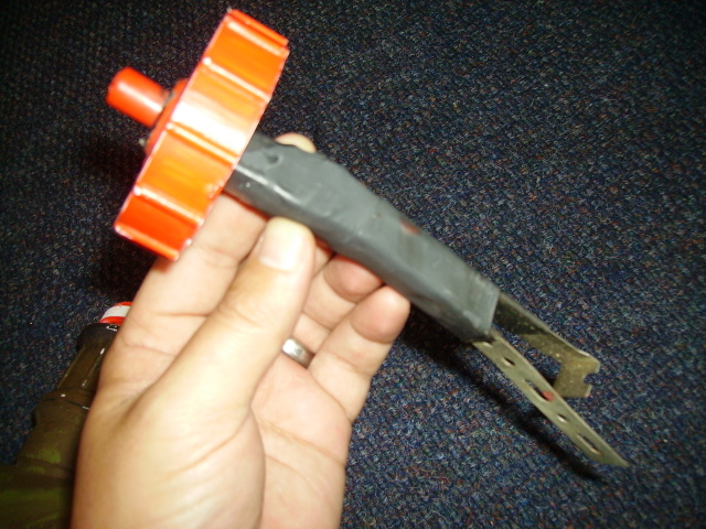

The trigger is a barbeque gas ignitor which i modified. added some longer electrodes and covered the lot in heat shrink to seal it. The trigger is also removable for servicing.

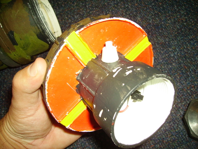

rear cover with external battery compartment(with switch) for fan

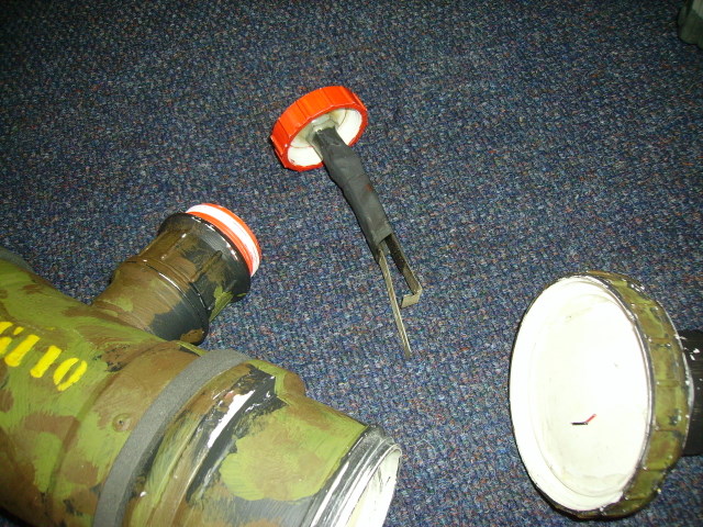

trigger mechanism. covered and sealed with glue and heat shrink
trigger removed and back cover. can still see the fan wires(fan blew to pieces)

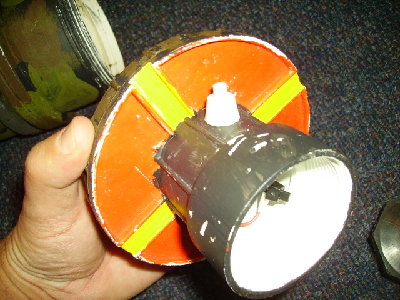

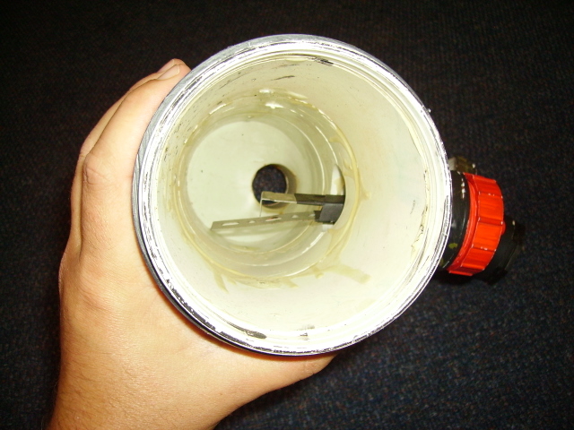

trigger inside
trigger inside

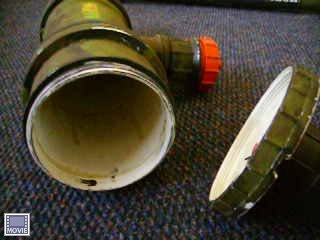

rear view of chamber(open) and cover

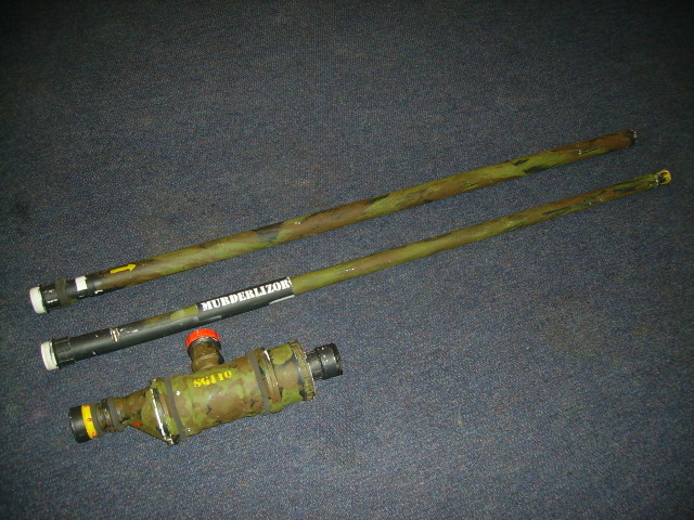

overall view
overall view

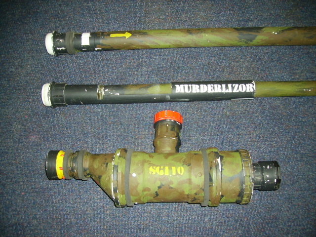

components . <br />top : 50mm barrel (great for golf balls!)<br />middle : 40mm breech loading barrel<br />bottom: chamber &amp;amp; trigger
components .
bottom: chamber &amp; trigger

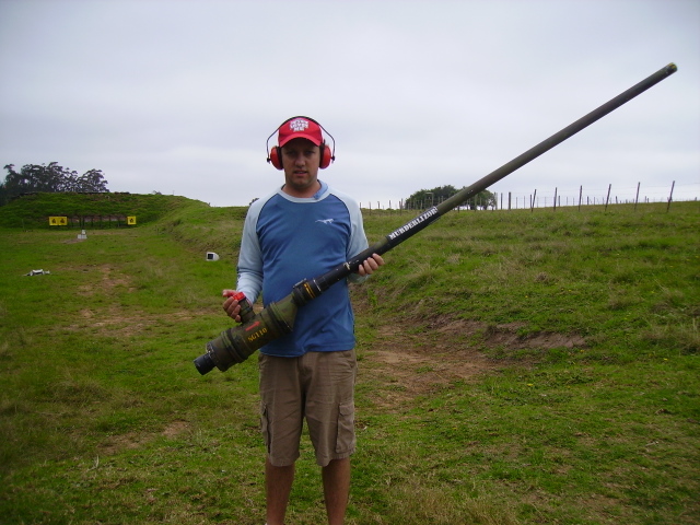

testing at the shooting range. 40mm barrel attached

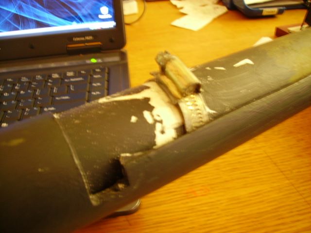

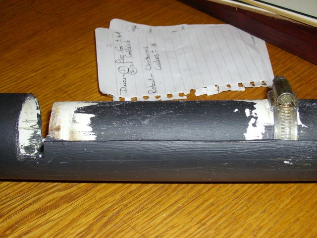

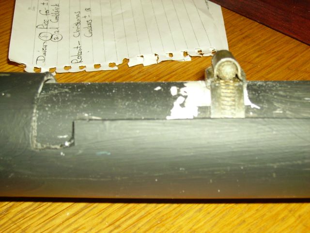

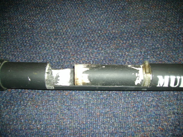

side view of closing breech. you can see the locking slot into which the clamp fits.
sliding the barrel back, closing the breech

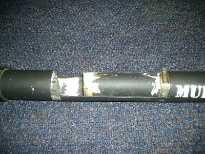

side view.breech open. its a very simple design. the pipe clamp is the lock. the barrel slides back, twist it,  and it locks. the clamp locks into a slot at the back. its a tight fit so there is no movement when fired.

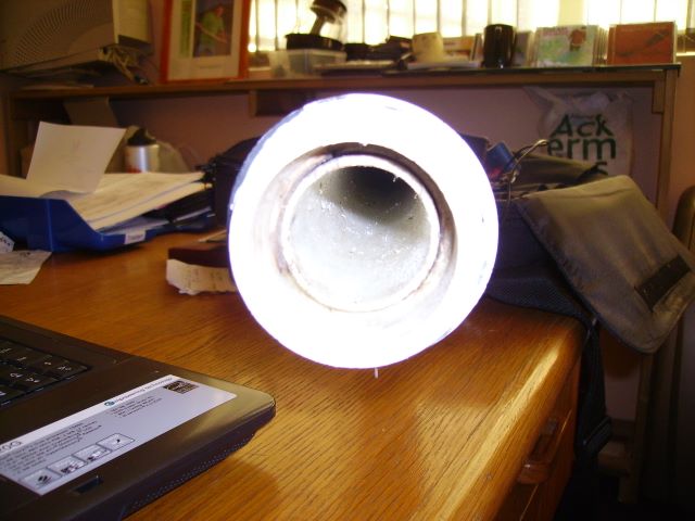

inside barrel breech closed. you can see how the bush seals it off. i'v considered using a rubber washer but it seals pretty good like it is and i get great results.

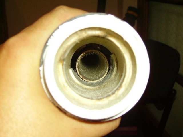

inside barrel from back. breech open. there are 3 bushes which act as spacers to allow the 40mm barrel to slide within the 50mm barrel. the 3rd bush is right at the back of the barrel and also acts as a seal.

I love it. Especially the name. :D Interesting breech load, any insight as to how it works? I didn't see a bolt or anything. Great gun!

Good work here. I like the ignitor "radiator cap" a lot actually.
Work on getting your fan replaced and adding a metered propane system and air inlet valve where that battery box is in the back.

Cool cannon, but could you please explain the breech design a little more thanks.

thanks for the comments. i've added some more pics and explanations of the breech design. busy uploading a quick vid i made of the breech action. i'll post the link as soon as its done

the radiator cap was a very good idea they can take heat and pressure so it makes sense to use them in a spud gun
