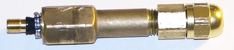

Inspired by jsr's idea http://www.spudfiles.com/forums/burst-d ... 10647.html, I thought I would start my own thread as I will hopefully be able to give it a go over Christmas.

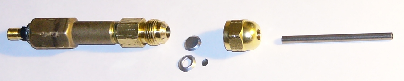

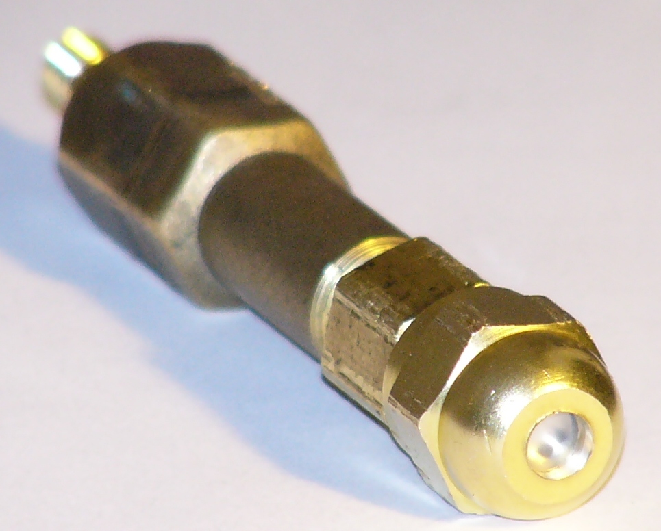

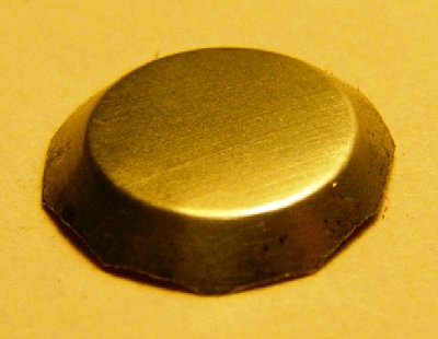

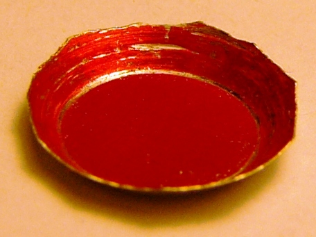

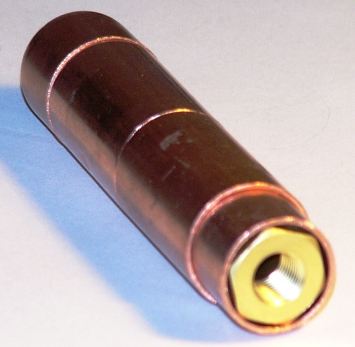

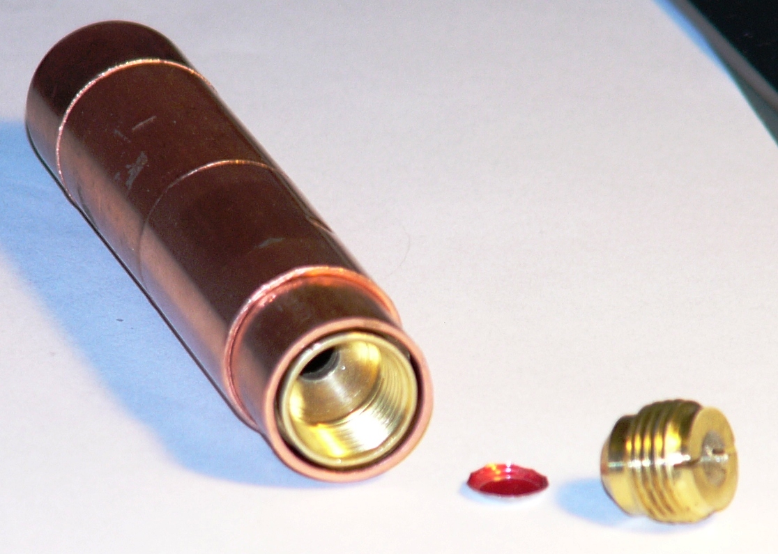

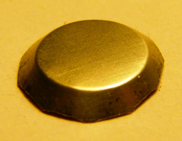

I was perusing the plumbing isle today and realized flare fittings might make good burst disk holders so I picked one up. This is just thrown together with the limited parts I had on hand, but it appears to hold pressure with a disk made from a piece of coke can.
The only modification required is to drill out the cap to the barrel size and the other flare fitting to the barrel inside diameter. The little barrel there isn't the right size, I just used it to see how hard it was to puncture the disk.
Any input on the viability of the flare fittings?

I don't see much of a difference as far as performance goes. It is just a different fitting. However, I think this will work well for a burst disk holder because of its shape.
Also, concerning your last two pictures, are they of the burst disk?
Nicely done. (good camera btw)
Maybe a coke can is too thick for such a small diameter.
Tried it with aluminium foil yet?
How much pressure did it held?
I believe my bike pump goes up to ~160 psi, though the gauge broke off the first time I used it. You get what you pay for
The can material may prove too tough, just thought I'd try as fiddling with a bunch of tiny pieces of foil wasn't appealing.

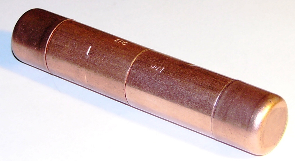

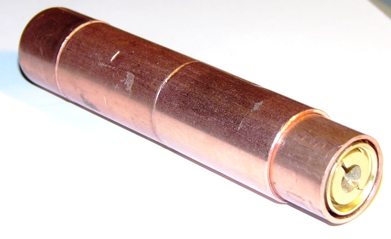

Edit: Some progress, see pictures. Pretty self explanatory. The caps aren't drilled out because I don't have a big enough bit on hand. The bushing will have a check valve inside. The fittings will be epoxied in.
Looking very good, my one concern would be the excess weight if you come to making a self-cycling system.
Also, you definitely need a thinner burst disk, at 6mm I found that a single layer of simple adhesive tape will hold in excess of 350 psi.
Good point. I was planning on self-cycling.
If I keep the length the same with no couplings or caps and replace the bushing with the (lighter) 1/4"f end of the flare fitting I cut off, it drops the weight from 213g to 114g.
Should have thought of that - I let aesthetics get the best of me
. But no use in a pretty paperweight.
That would also allow for a series of couplings to form the breech. I was scratching my head over how to make one the right size.
Good to know on the burst disk material. At least that's easy to adjust once the rest is designed and built.

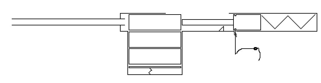

I was going to work on the breach this weekend, so hopefully I can get some input on the layout pictured here. Specifically, how far forward or back relative to the magazine to position the ejection port.
Not asking for hand-holding, just trying to minimize the number of versions I have to try to get this to work. Still have to buy christmas presents

What has a thin disk to do with accidental firing?daccel wrote:but there should probably still be somewhat of a safety factor to prevent accidental firing.
The only thing I can imagine is a thin disk being damaged faster, so it will be more prone to leaking and will have to be handled carefully.
