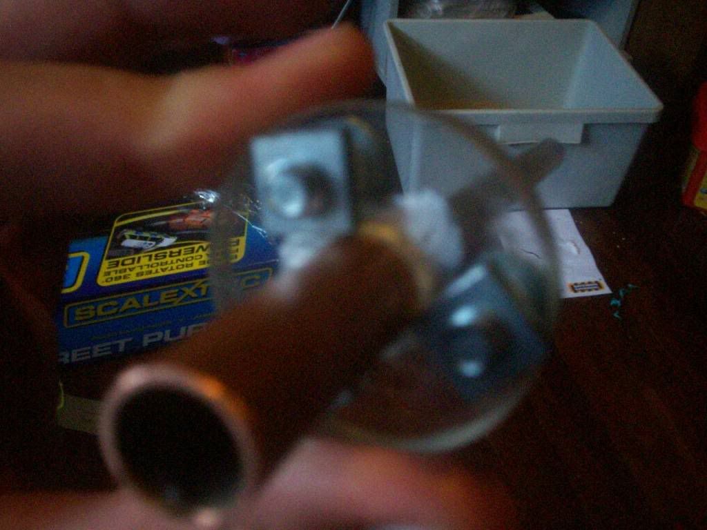

And anyway..onto the present. Here's the current progress and plans of my new micro hybrid.
Disks bolted together and a burst disk loaded into position. Taken from barrel side.
Disks separated, showing where the burst disk clamps and bolt holes.
Copper disk half. This is the flat side, copper pipe on the other side is attached to barrel.
Disks bolted together. This is the barrel side, a burst disk is not inserted.
Copper side of the disk (joins barrel) with a burst disk inserted.
Flat barrel side of the disk. Barrel on the other side.
Barrel, burst disks and chamber joiner:
This is what's complete so far (barrel and burst disk breech). The barrel is epoxied into one of the disks, and the copper pipe (which attaches to the chamber) is epoxied into the other. The flat side of each disk was smoothed with a high grain sandpaper, to provide a tight fit. The burst disk is placed inbetween the two disks, then the short bolts (about 1.5-2 cm) and nuts are tightened with a screwdriver and a wrench. This provides an airtight seal between the chamber, burst disk and the barrel. The burst disks are made from layers of aluminium/tinfoil (a very fine metal sheet used in cooking), amount depending on x used. The barrel's are ideal. I found a huge amount of them at school. They are fairly stiff, minutely flexible. They have thick walls, a slight interior rifling. They cut well, and are not brittle. I have pressure tested them to 150 psi, at which point the cap (homemade) in the end burst out (i think they might be slightly oily/greasy). Also because they are not brittle, they will not shatter and make a heap of harmful shrapnel. They also seem to be moderately heat resistant.
The copper pipe is just plain copper pipe. It connects one of the disks to the chamber.
Chamber:

A threaded fitting would have provided a burst disk holder that is much simpler to work with and probably a good deal stronger too.
inonickname
Posts: 2606
I'm not sure on that part. My last one used something like that, and it had a heap of problems.
1) due to parts available, I had to use heaps of fittings on the last one. Expensive.
2) it's two sheets of 5mm perspex, and there wont even be a mass of force on it. Strong enough I think.
3) due to having to use a bunch of parts it extended the barrel far too much. Hence why it took me half an hour to get a shot out of the first one.
4) the bolts are the ideal length, only takes a few seconds to screw/unscrew.
Sure, if I lived in a city and had a huge range of parts available, I'd probably find a decent setup. But due to where we live, it's a tiny range of stuff. As in tiny, they don't stock solenoids, banjo fittings or cow bells. It's a very poor range.
Thanks for weighing in though JSR :wink:
If it works it works ;) hope you have quality epoxy available though.
