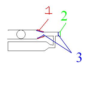

I am curious about where the force of recoil is actually applied. I am curious because I will be building a piston hybrid and if I could get away with some sch80 fittings in some places, I would love to spend less.
Which of the 3 places in the craptastic paint diagram do you think the recoil force will be applied to? If 1 or 3, do you think a sch80 PVC bell reducer would be able to take the recoil from a max of 13,000 foot-pounds. The barrel will be 3".

Based on very limited knowledge of firearms shouldn't it be the point where the gas turns 180 degrees to the barrel?

yeah, I knew about the 3rd law. the question is where this recoil is transmitted. to. If there is recoil at the whole back, that is fine, it will be metal.
do you think a 3" sch80 pvc bell reducer can take 13,000 ft-lbs worth of recoil?
Or should I use cell core to take away some of the sectional density of the pvc shrapnel that will hit me as a result of trying?

Also, If i havent answered your qustion, the force will be applied at the point of contact with the object. So technically, there is a multitude of equal and opposing forces....
The force of recoil will be acting rearwards on any peice of the launcher also launching the projectile, AKA, part 3 does NOT count as where the recoil force originates.

Short answer is THE BARREL actually.
The recoil is a reaction to the linear motion of the projectile and escape of propellant gasses, this happens in the barrel and therefore it is where recoil forces are applied. The recoil is then transmitted to the rest of the launcher through wherever the barrel is attached.

The recoil is not a force that is applied somewhere, it is the counterpart of a force that is NOT applied somewhere.
The force acted out on the projectile does not act out on the gun, leaving all pressure on the opposite side act out on the gun without a counterforce.
In the case of your diagram, the recoil would be acted out on the areas marked by 3.
The force acting on those areas will be exactly the same as all other parts of the gun (pressure). Only difference is that this part has no counterforce to neutralize it.
If you want to know whether the sch80 bell reducer can take it just think: can it handle the pressure it will be subjected to if it was used in a pressure chamber?

I am not concerned with the pressure, just the shock/ moving force. I didn't count the launcher's inertia. and ALIHISGREAT, 3" metal pipe is rather expensive. sch80 pvc is cheaper, and sch40 has been used with no problems.
Psycix, that was a good answer.
