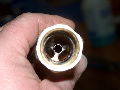

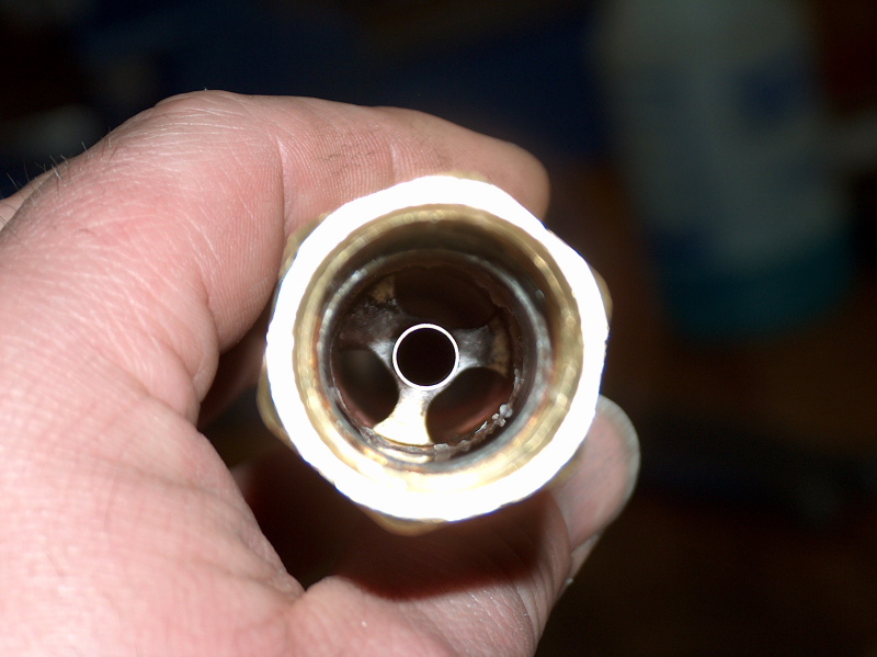

I made a barrel support for my coax by taking a 3" to 1.5" reducer bushing and literally sawing off the back face of it...you can see it here..
...looks like a 5 spoked wheel inside there. It then fit perfectly in 3" coupler I was using. It's all very tricky to cement/glue up though. I had to use epoxy on some of the joints because PVC cement cured way too fast to get everything lined up.

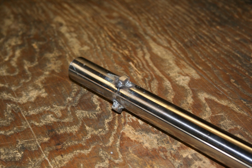

I used a reducer to bridge the difference, and then sliced the reducer up into well,..... pizza parts.
3 small parts were glued on the barrel and then it was all done!
