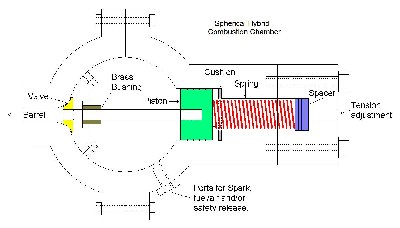

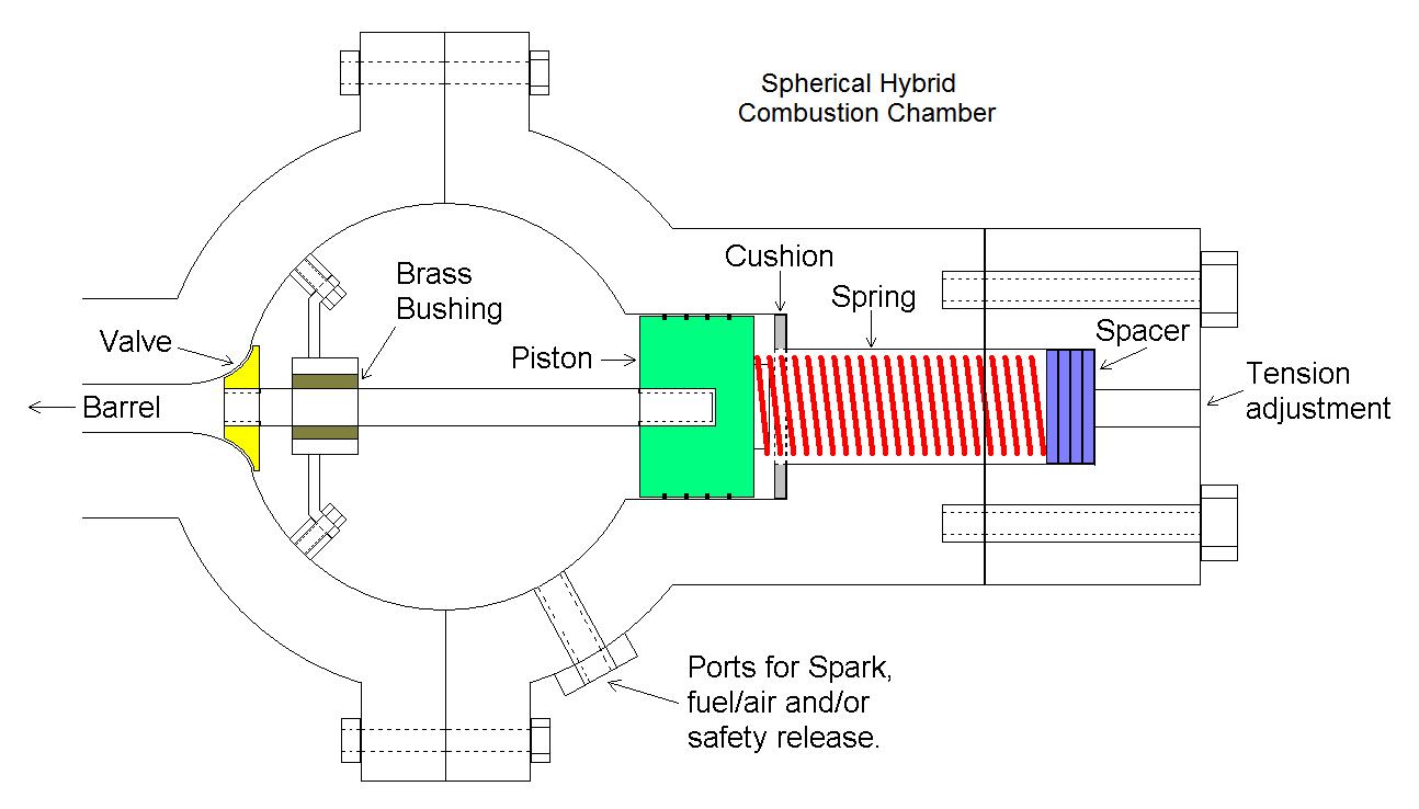

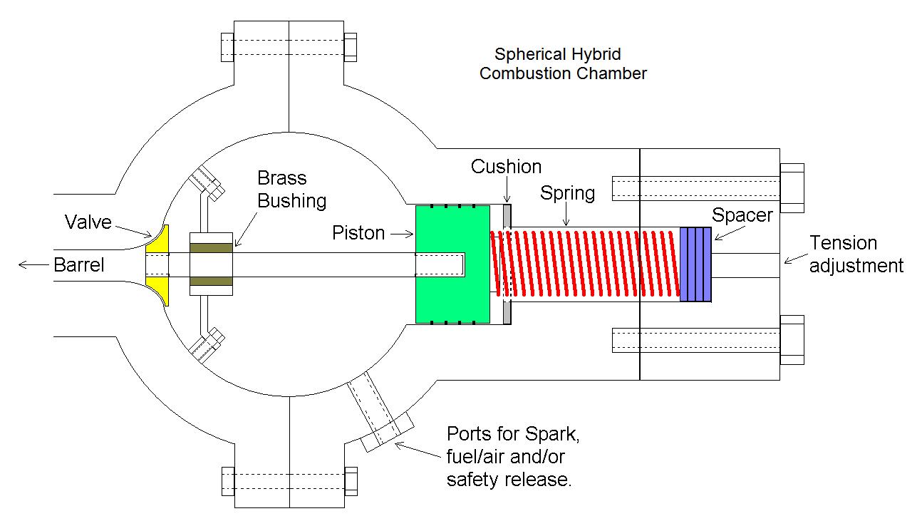

I've read in several posts that the optimal shape to prevent detonation would be a sphere. So that got me to thinking, if you had access to a CNC Mill what would be your conception of the perfect spherical hybrid combustion chamber for very high X combustion? I was doodling in MSPaint and came up with this rough concept.
that could be done, but it would be impractical and expensive. the max mix for hybrids using propane and butane is 320x. the corresponding pressure is over 4500 psi. the unbalanced pressure that you rely on to trip the valve will be applying craploads of force against the spring. It could be done with a pneumatic spring, but the pressure would have to be finely tuned. if the valve failed to trip, there would be very little left of the chamber. I would rather make something like Larda's hybrid, and use some beastly strong burst disk.
good design, though. the valve mechanism has been used on a certain, kick ass cannon

i would use a burst disc too... its just much simpler and there is less to go wrong...
Higher than Larda's 200x hybrid?JohnnyBOOM wrote:hybrid combustion chamber for very high X combustion?
Even that didn't detonate (although he suspects the 40x oxy/propane mix may have done), and got away fine with a cylindrical chamber.
Beating the pre ignition pressure of that would take some serious work (and in fact it's not really possible to go much further with propane), so you'd already have more challenges to face before you need to worry about special chamber shapes.
That said, a spherical chamber does indeed have the greatest volume for a given diameter, and would therefore be able get the most out of something within a given detonation distance, but that doesn't mean that it has to be needed, as it seems detonations are a much less likely event than older spudding wisdom would have had it.
As Larda's hybrid is unlikely to see an equal or better in pressure for a very long time (excepting of course anything Larda may have planned), and that I believe the runner up on pre-ignition pressure is barely more than a tenth of what the HyGaC20 uses, I doubt we need to be looking at spherical chambers yet, except when using other fuel combinations which have not yet seen popularity, such as my proposed propane/Butane hydrocarbon blend (to boost pre-ignition limits to 320x - but based on the results of 200x, it isn't likely to detonate anyway) or the He/H<sub>2</sub>/O<sub>2</sub> idea (which I proposed as a ultra-high velocity option) - or just anything oxygen enriched in general, which has a faster flame propagation rate, so is more likely to undergo DDT.
It would be a waste of material to machine a spherical chamber.
I'd stick to cylindrical if I were you.
If you want to prevent long distances of flame front (possible DDT runup) simply invest into multiple ignition points.
Yep I agree, the sphere would be way too esoteric to be practical. Multi-gaps is really no big deal to implement in a cylinder.psycix wrote:If you want to prevent long distances of flame front (possible DDT runup) simply invest into multiple ignition points.
