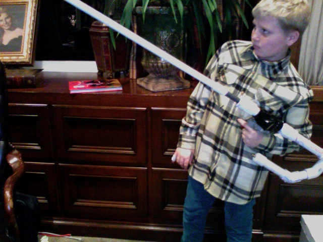

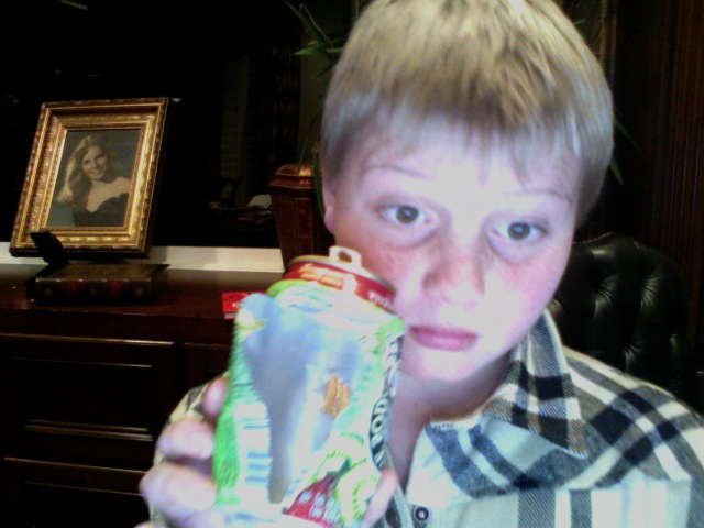

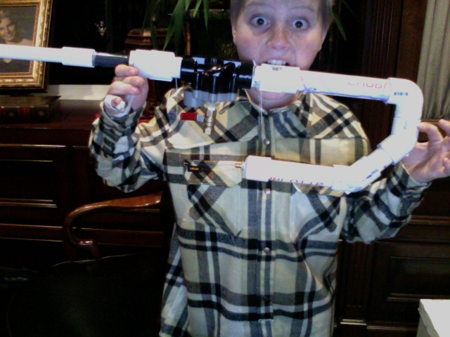

this is my sprinkler valve gun it is very powerful i named it the bone crusher because i actually broke my finger shooting it but i will now tell u how i broke it shooting it. it needs a paint job and i think i need a bigger chamber.

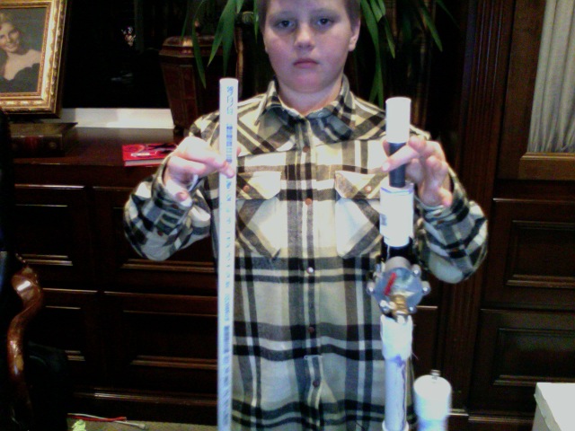

valve:1 inch sprinkler valve
pilot valve: 1/4 ball valve
barrel:3 feet of 1/2 inch barrel
chamber:1 inch sch 40 pvc 3 feet
fill valve:schrader valve
new sprinkler valve rifle

looks good anyway, just a suggestion tho :
replace that ball valve with a 90deg elbow and put a pistol grip blowgun on it. then it will really feel like a gun
plus it may improve your accuracy, because your not jerking the gun when opening the ball valve.
i cant see any resemblance to one.
it looks more like a rifle of some kind?
