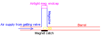

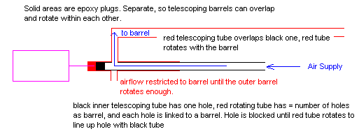

without a valve or perfect smooth, rotating seal it will just hemmorhage air at a massive rate. May as well just make a vortex/cloud. If your going to make a gatling the best way is using a valve (rotary). Which opens at a certain stage in the revolution cycle, like this:
It's difficult to explain, but isn't hard to make and is effective. Instead of the bb being picked up, just make an airtight grav or spring fed magazine for each barrel, with a magnet catch to hold the bb in place when it falls into the breech. It's actually easy, and I'm building a modified rotary valve for a micro gatling (or a new air/CO2 motor) next time I can get to the hobbyshop to pick up some telescopic tubing..

Here are the pics:
- Gatling/mingun barrel config digram
- gatling gun barrel setup.PNG (2.98 KiB) Viewed 6600 times
- Gatling/minigun valve diagram.
- gatling gun valve.PNG (7.41 KiB) Viewed 6600 times
