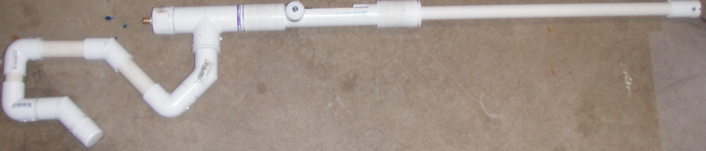

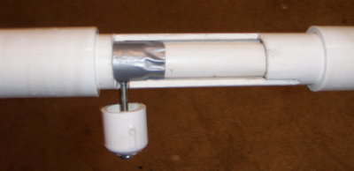

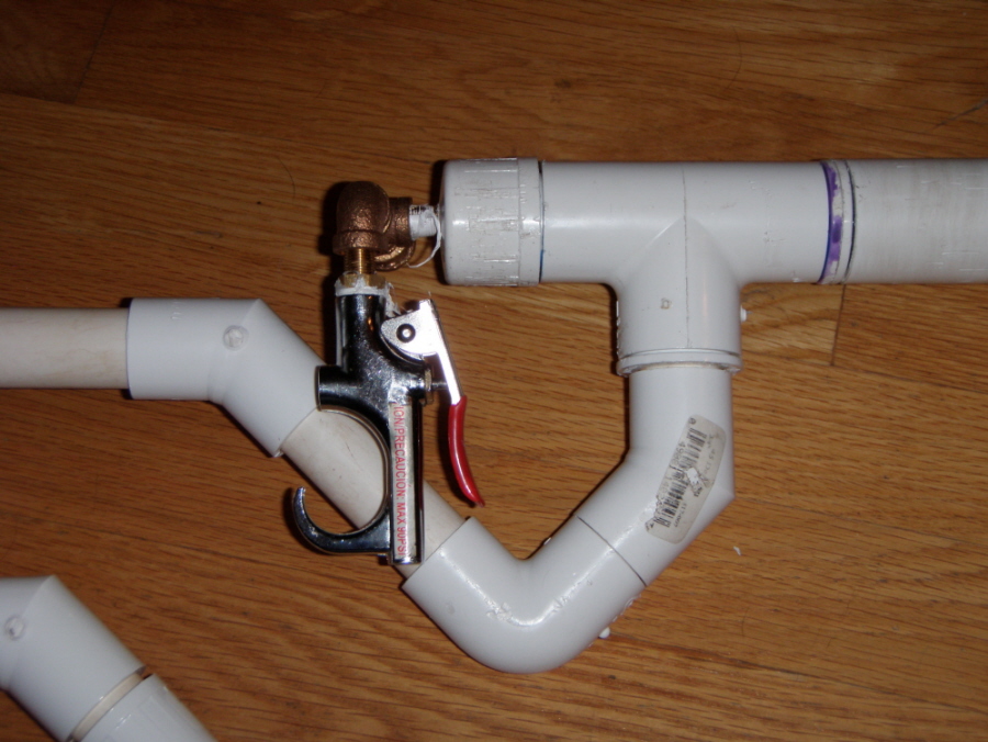

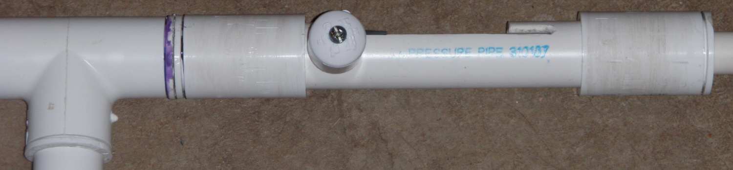

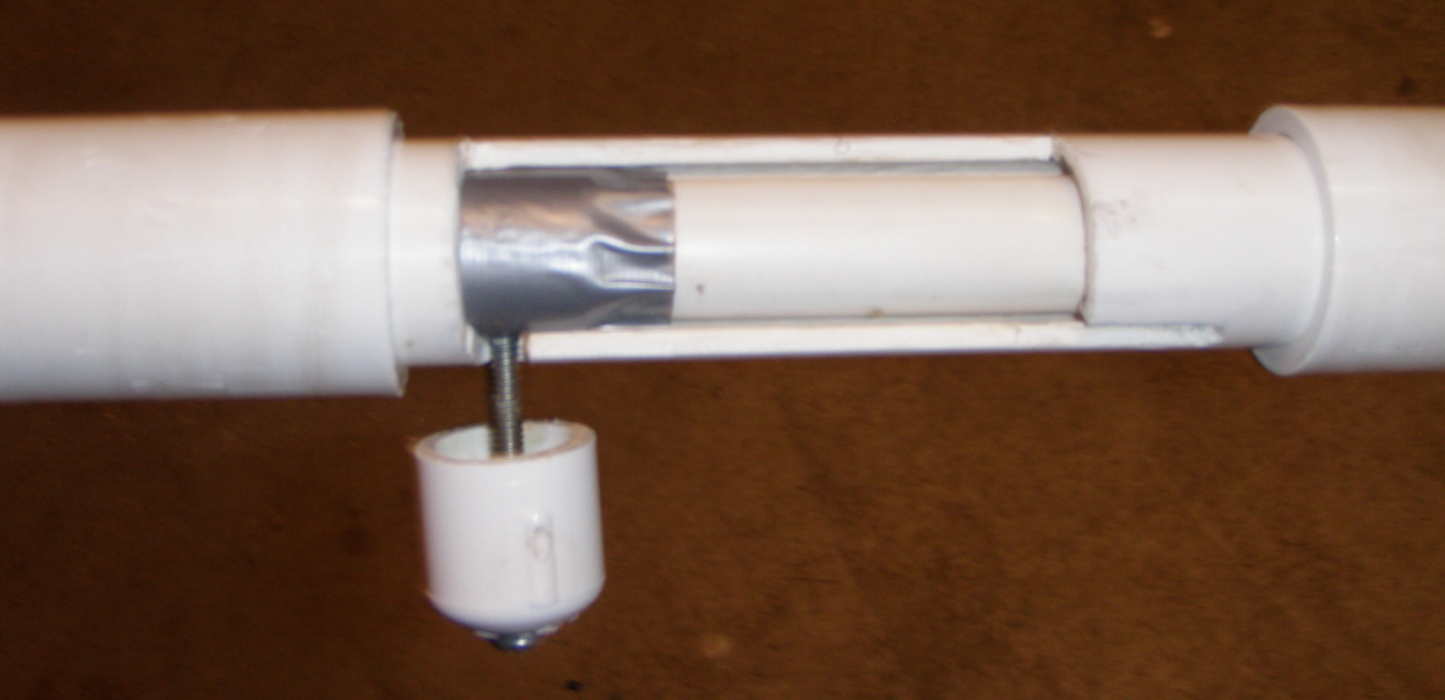

I've been working on a small/medium scale, 1 inch, Tee, piston rifle. The piston is made of solid pvc rod with neoprene to seal. It slides and seals nicely, however, it wont let the air through to the barrel. I think i might need a different pilot valve, but that is why I'm asking the experts. The barrel is 1/2 inch SECH40 pvc. (The barrel looks kind of bent in the pics, but it isn't.)

I use a modded blowgun to pilot a 2" piston valve, so I am inclined to look elsewhere for the problem.
How well does the piston actually fit? ie. If you were to remove the fitting on the back of the tee, and point the muzzle at the sky, would the piston fall out?
What does happen when you vent the pilot?
What is the surface area differential for your piston?
What is your pilot volume, and total piston travel?
And just because I've run into it before...Are you trying to vent your pilot through rolled up socks?

@sputnick, It's your basic tee-piston valve

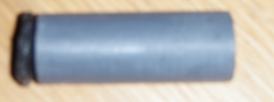

@Gippeto, This piston fits nicely, but isn't air tight. If it is pointed upright, it falls out. I still think that the valve cant handle the pilot volume. When the pilot is vented, the air just flows out the pilot. I haven't glued all the parts together. So it hasn't really been pressure tested yet. I have been trying to get the piston to seal the barrel. I finally just bought neoprene on Mc Master.
I'm not sure what you mean by the surface area differential.
The piston only travels about 1/4 - 3/8 of an inch. Most of the pilot volume is caused by the fittings.
HAHA I don't even know how that is possible.
Thanks guys for getting back to me on this. I've been working on this project for months and i really just want it to work.

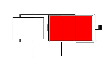

- This is a simple diagram of the valve.

Give the piston a couple wraps of tape until it won't fall out (just), and try it again.
Piston area differential explained simply.
If you do not have enough of your piston face exposed to chamber pressure, you can have problems getting the piston to actuate.
ie. If you have a 1" barrel and a 1" piston, you have no surface area for the chamber pressure to act upon, and the piston will not actuate.

Okay, thanks, I'll see what I can do. It happens to have a 1/2 inch barrel, but if the tape won't work, I'll try cutting a new sealing face.

A 1" blowgun should be enough (but not the best) to pilot a 1" barrel sealing tee piston. Since pilot volume looks minimal and your piston's surface area looks like a good ratio from your rough diagram, the problem is down to the piston's fit inside the tee.
Since it's a solid rod, you could try tracing a circle around it and then making an o-ring groove with a hacksaw and file, this will work and guarantee a great seal for the piston. Tape may work, but I wouldn't recommend it. Instead I would recommend copious amounts of lubricant and maybe a resin that you could 'paint' on to the piston evenly with a very fine layer to give it some more thickness.
If you put too much on, just sand it down. Best choice would be to make an o-ring groove, and do the resin, but if it's a tight enough fit already, lubricant can help fill in the gap. Though it may need to be replaced every now and then. Which doesn't seem like too much of a problem for you.

Well, I tried tape, it didn't work. I also cut a new sealing face. It is as big as I can make it and still get it to fit inside my T. It's still not working. I think I'll go with MrCrowley's idea. I just don't have the right size o-ring. Off to OSH I go...

MrC was leaning toward a more "permanent" fix, and has some very good suggestions.
I was leaning more toward identifying the problem/s first, using temporary fixes.(tape)
If you couldn't get it to at least work with the tape, the o-ring is not likely to help either.
Something else is amiss as well.
How true to scale is your drawing? Does the barrel actually protrude into the tee as far as shown?

After reviewing my drawing, and the weapon itself, I have come to the conclusion the I had a sucky memory at the time I made the drawing...
The drawing was a little out of scale. I am now thinking, Gippeto was right, the differential may still not be enough. I will go with the o-ring route, just to be sure, but I may have to move up to a bigger Tee to give me room to make the sealing face even bigger.

Yeah I had a 1 1/4" piston in a 2" tee sealing a 1 1/2" barrel and it actuated fine even with virtually no surface area. Aslong as the flow rate around the piston to the pilot is not to high, it should actuate, short of an unforseen problem not yet described.
