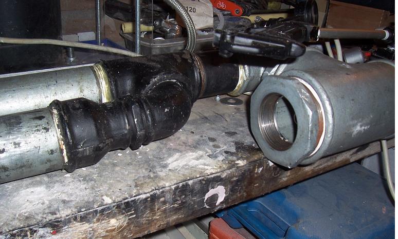

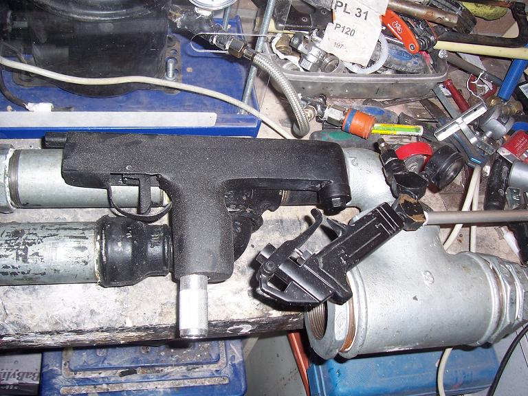

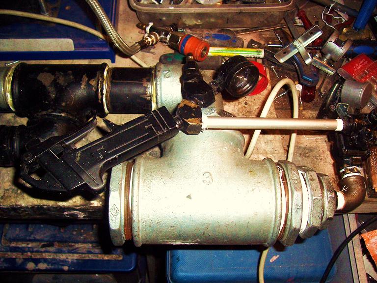

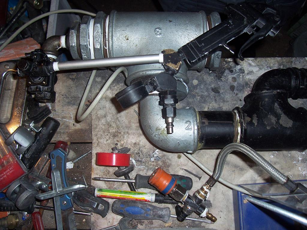

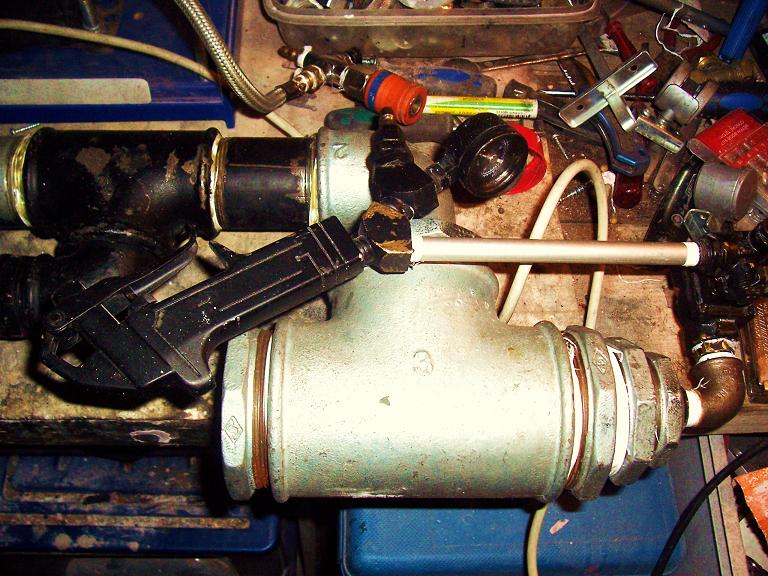

Well..I just tested the basic setup and at 50 psi it gave off quite a bang.
So, eventhough it´s not finished, I felt I had to share this ugly bugger with you guys.
I need to clean up the look, since some parts are taken right off of `Overkill`.
Need to sand it, paint it, fix the blowgun on a mounting point.
I need to get the 6 foot, 2 inch I.D. barrel threaded. ( hopefully this saturday)
And it needs a front grip.
Anyway.It's got twice the chambervolume of Overkill, and has about 4x the flow.You can see it has two chambers stacked on top of one another.I did this to both fill in the space between the " normal" chamber and barrel, and to get more volume without the length..
I recon it could be used up to about 500 psi.
The piston is as light as it could be, has lathed tapered rubber discs, and a cone shape ( lathed) in front of the sealing face, wich guides the air toward the barrel, without much turbulance.
I know it doesn't look like much now, but technically, it's a pretty darn good cannon.
My biggest and most powerful yet.
Oh and yeah.It's heavy, but not impossible...
Any comments?

That would require me to disassemble the valve..
When I do that ,I will take a picture.
It's not that revolutionary.Just an aluminium cone.
Big diameter at the sealing face, smaller towards the barrel.
Oh, the piston runs so smooth, I could move it forward by blowing and retract it by sucking on the pilot side....
No other way to put it, but yeah, that sounds weird..

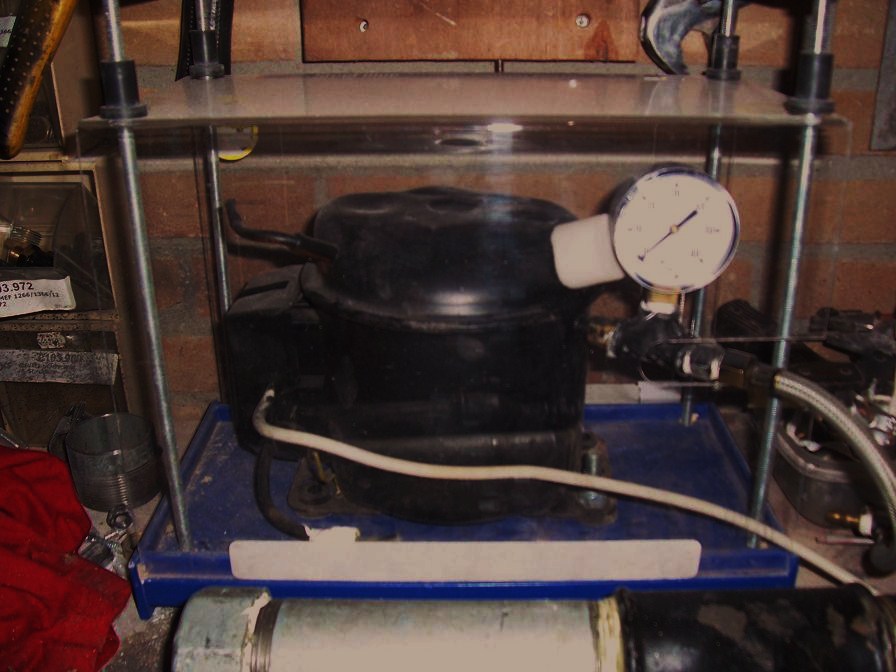

And you are trying to fill that with a single fridge compressor? My god! How long does it take to fill?

THe pilot valve is a 1/2" modded solenoid valve.

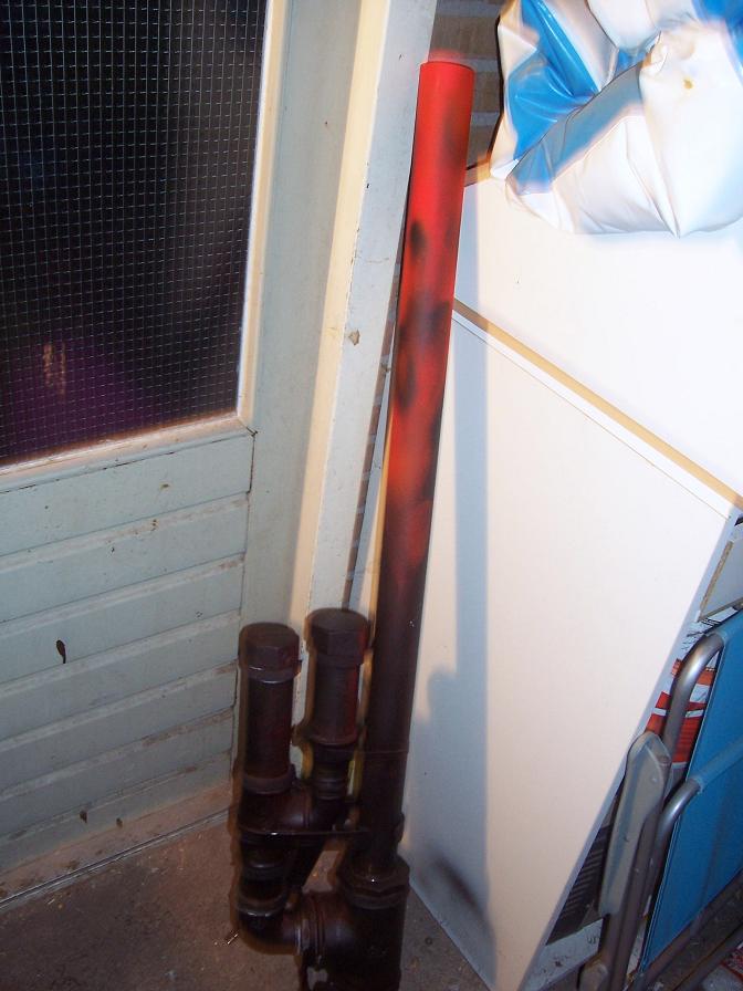

The barrel is treaded and attached, and I've shot it for the first time, at 5 bar.
Guess what? Red Bull can beats furniture.....
At 5 bar ( 70-80 psi) the damage is nothing we haven't seen before, so I didn't take pics.But still, it functions. My wife described the blast as a large firecracker going off inside a sea cargo container.She was on the opposite side of the house when I fired it.
I'll post some pictures later. It still needs a bracket to support the blowgun.But it's functional, and that's what counts.
Now I need a place to do some 400 psi tests...
