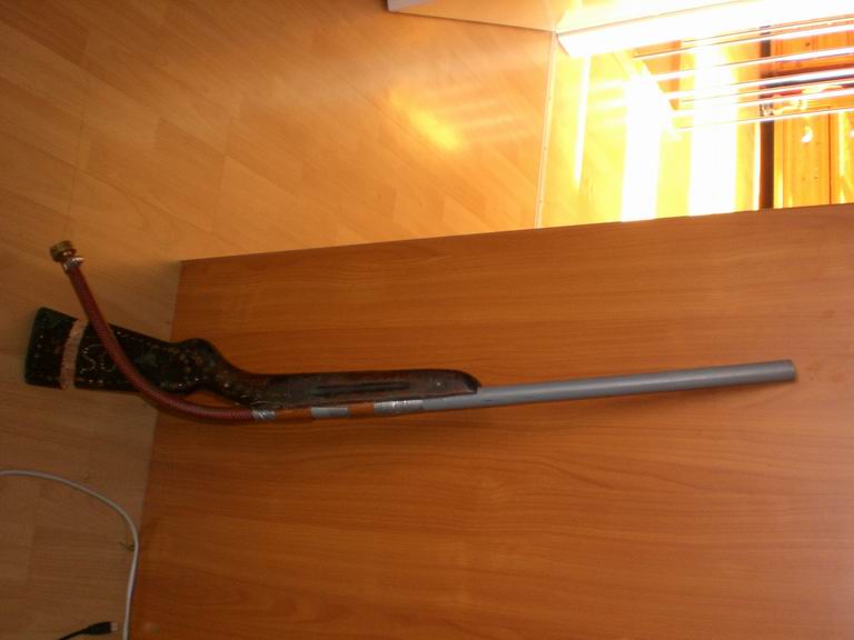

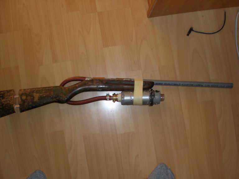

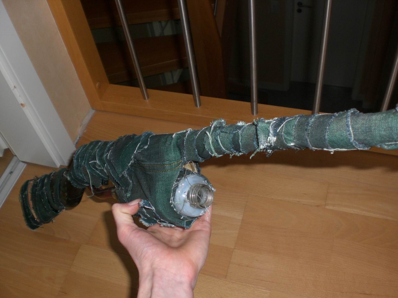

Hey there spudders,
I actually wanted to build a mini just for fun because I was bored :lol:

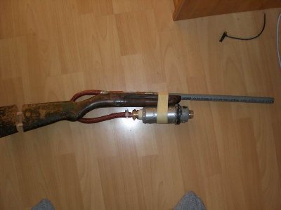

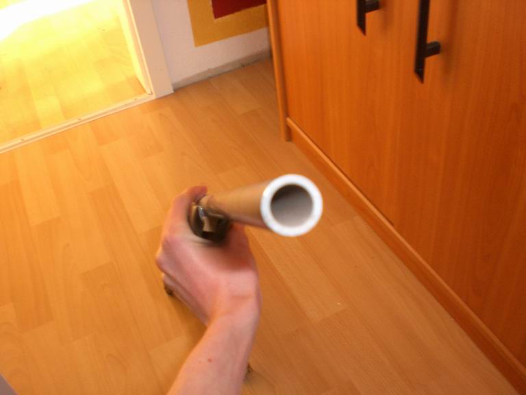

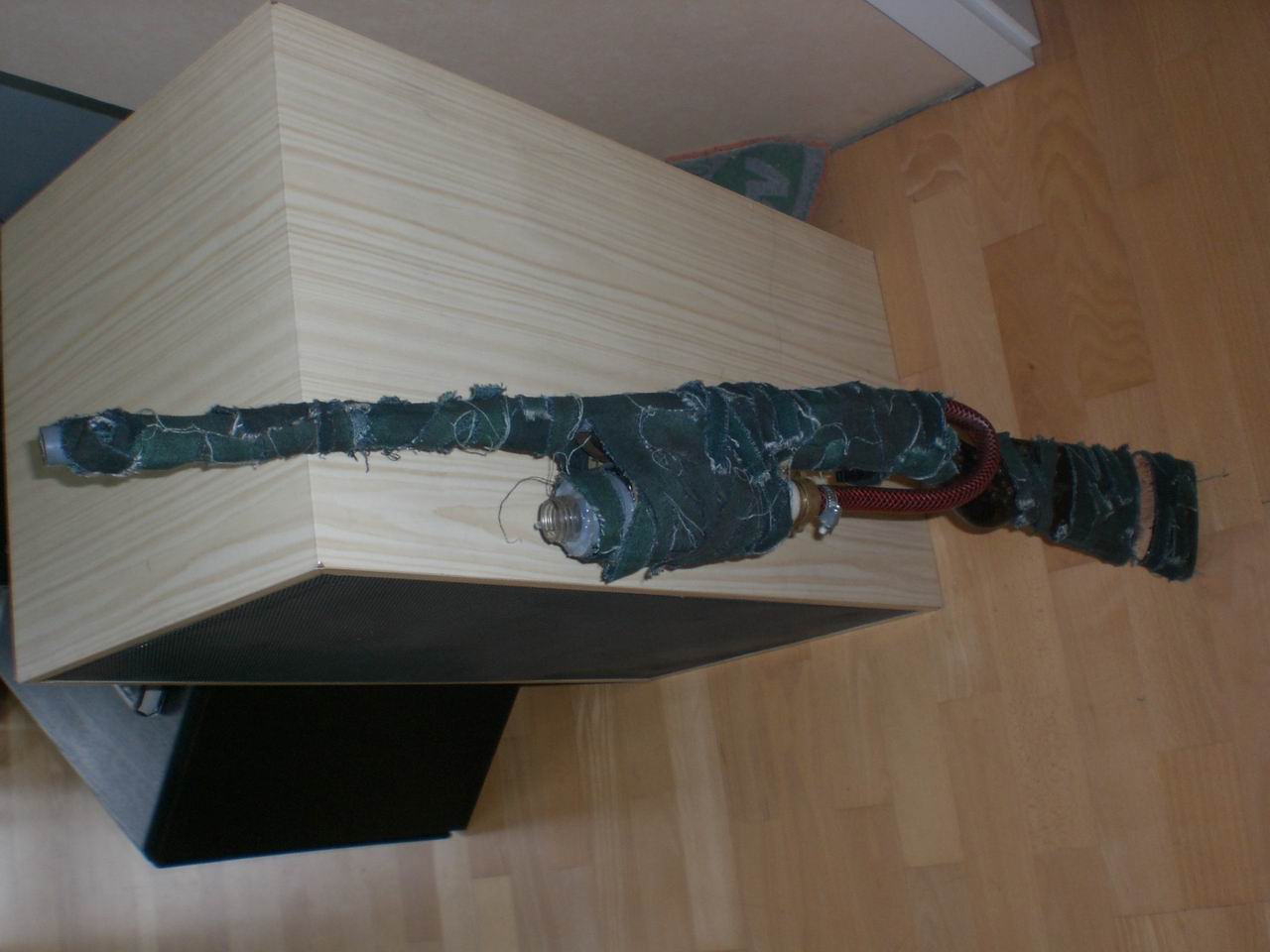

But it turned out a little bigger. So I gathered some stuff laying around and began to build this little spray & pray sniper. I have shot with it a few times already so it works :lol:
Specs:
Barrel - 15mm/ 42cm
Chamber - 250 ml

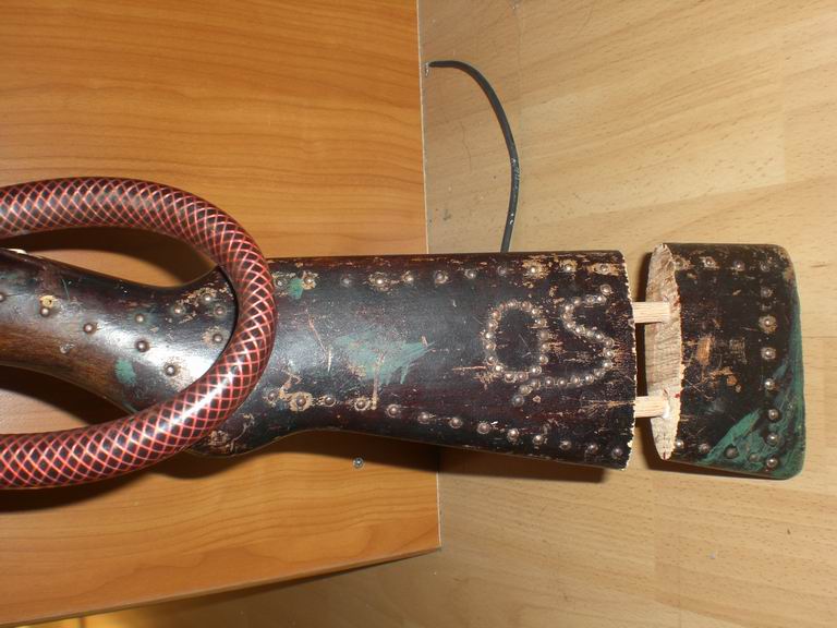

Stock - old woodn toy (modified a bit)
I think the pics will tell the rest!

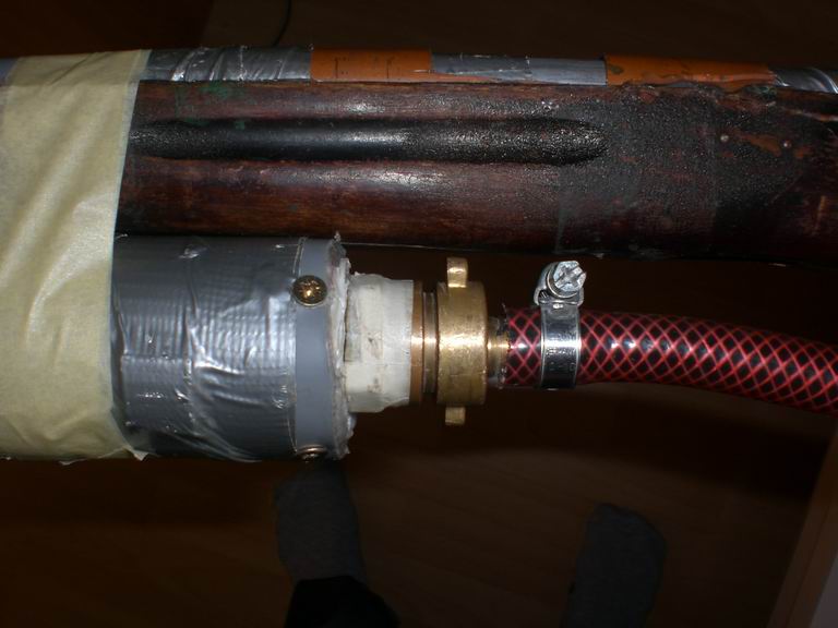

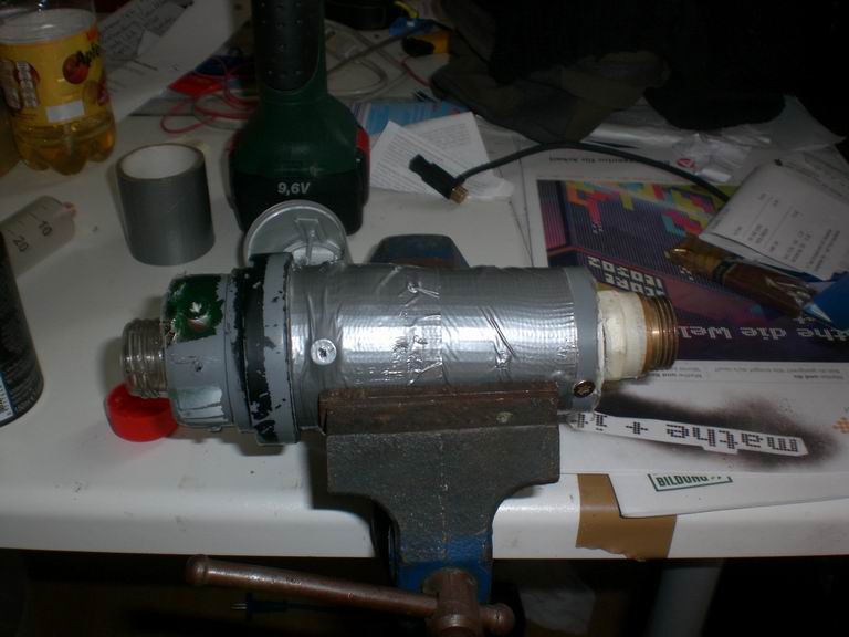

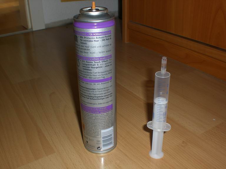

I do have a question about the fueling. If I´m right with this:
The Chamber has ~250ml so I have to add gas of ~10ml = 4%?
Is this okay?
Tell me if you´d change anything :wink:

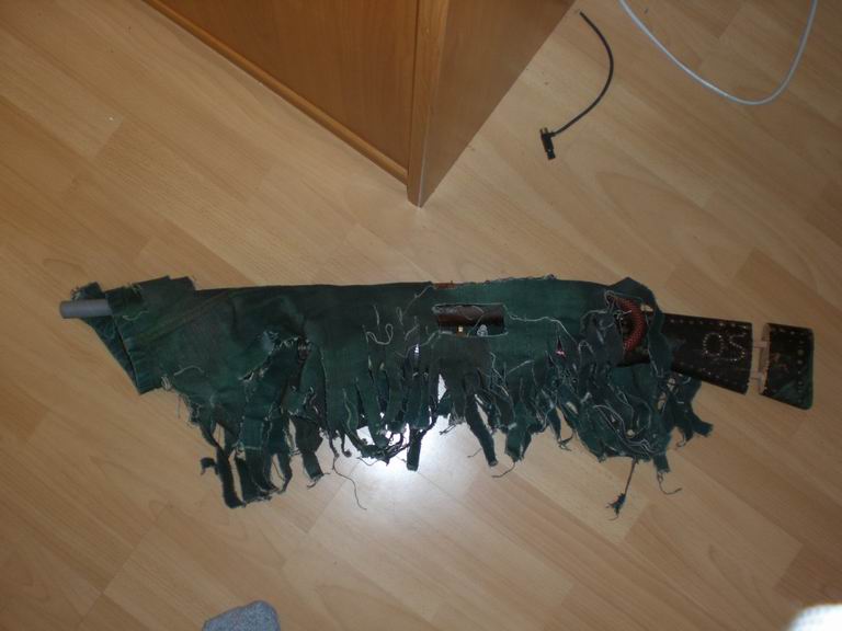

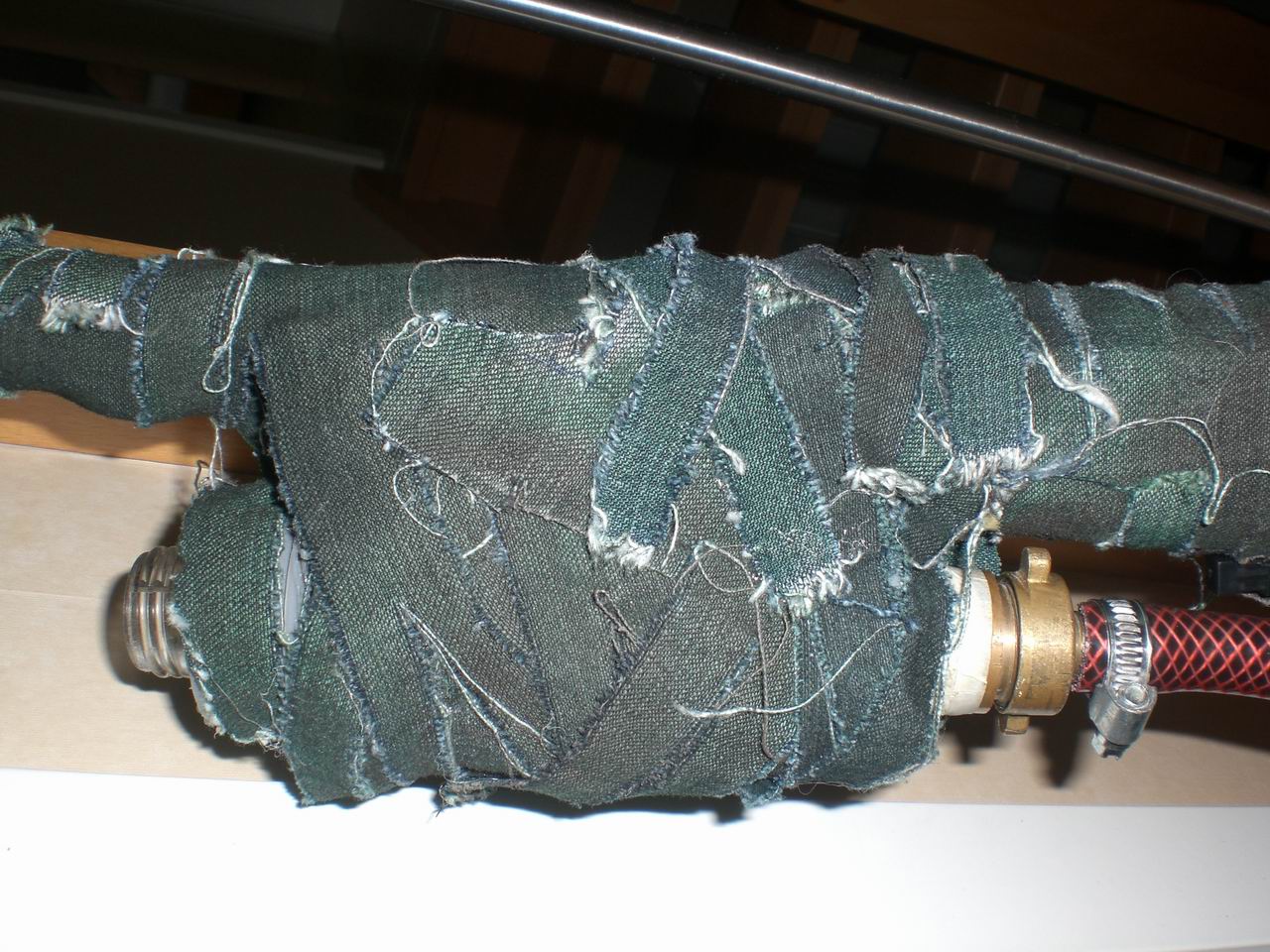

Edit:

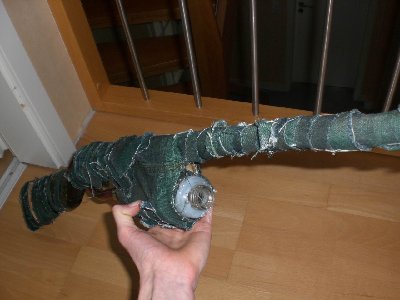

-I put some kind of guilly around it :lol:
-Added the piezo
-shortened the hose as much as possible!
+ I screwed it to the barrel
_____________________________________

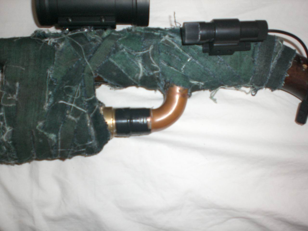

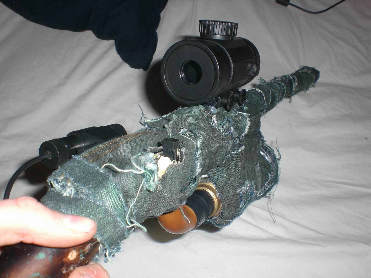

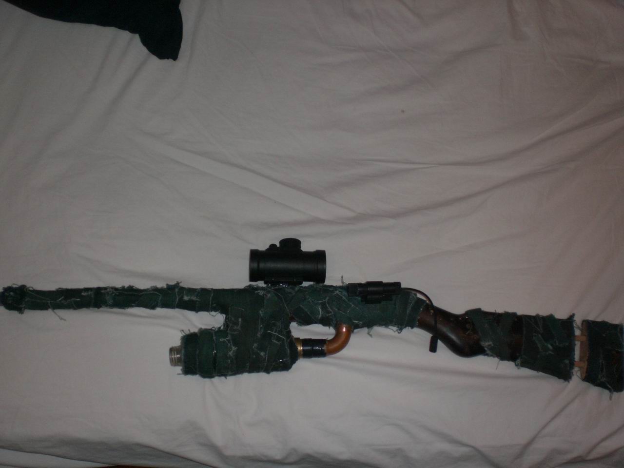

Another Edit :D

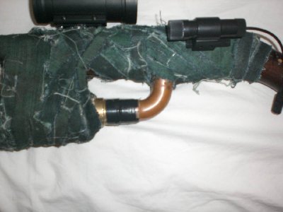

-took off the hose thing
-replaced it with 2x 90° copper pipes
-Softair Reddot
-Laserpointer (just for looks) 8)
I´d like to thank starman. You were right the hose thing was a bad idea. It works much better now. Thx :D :D

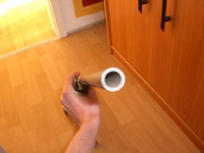

looking down the barrel of my gun

The sniper ( just taped the chamber on for foto)

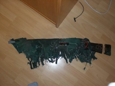

took the guilly thing apart and glued the pieces on

replacement for the hose

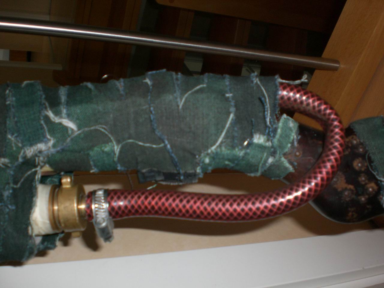

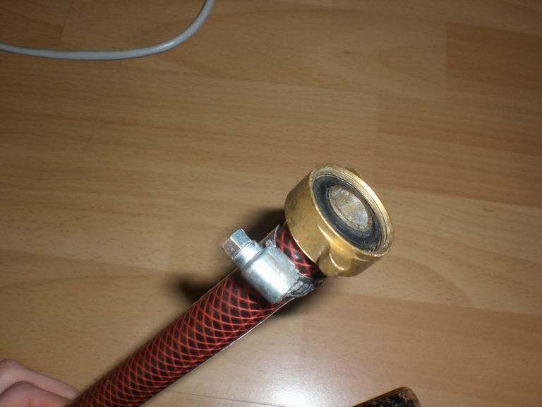

That rubber hose is rather dead spacey and long and soft and crooked so I believe it's going to eat up some of your performance. Also, I'm not sure I would want to shoot that thing with my eye and face so close to it....that hose only looks butt-spliced taped to the barrel.... :shock:
Looks like you are using butane fuel so 4% should be about right. With propane you would want to push that up to 4.2-4.3%, with MAPP 4.8-5.0% or so.

freder wrote:I´m going to try and see if I´d get more peformance with a brustdisk between the chamber connection and the gardenhose.
How about just completing a safe basic cannon before you start fooling around with a burst disk. There's a few fundamentals you need to attend to first.

starman wrote:Looks like you are using butane fuel so 4% should be about right.
Butane should be at 3.2% with air, so 4% is too much and will hit performance slightly.
It has been shown that a slightly rich mix from theoretically perfect actually provides a small bump in performance before falling off, thus all my numbers were bumped up a bit purposely. 4 is slightly higher than optimum but I would certainly be willing to guarantee the shot if everything else is in place.
Ragnarok
Posts: 5401
Location: The UK
starman wrote:It has been shown that a slightly rich mix from theoretically perfect
Slightly rich - 4% is a full quarter over ideal. I'd be aiming for 3.5% perhaps, but not 4%.

4%, the extra may be burnt in that hose. It will be hurting performance, try shorten it as much as possible. And dang at the chamber..I was worried about using DWV (non-pw) in a mini before... ( :shock: )

inonickname wrote:4%, the extra may be burnt in that hose.
No doubt, the hose IS acting like part of chamber in this configuration.

inonickname wrote:... And dang at the chamber..I was worried about using DWV (non-pw) in a mini before... ( :shock: )
I dont think its DWV. In Germany we have the orange tubes ( which I think these are the cheepe ones) and the grey tubes. These are "hard to enflame" and I also think they´ll take a bit of pressure :lol:
