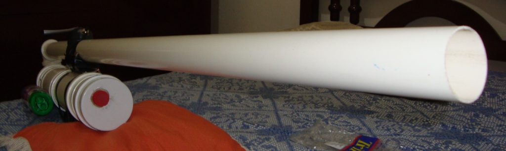

Here I show my first potato cannon, and I'm not sure if its possible to do it with a video, so if it is not allowed just tell me.
My cannon specs are:
100mm chamber x 600mm long
50mm barrel x 1500mm long
3x spark from a stun gun
2 ventilation holes
fuel used was Glade and ammo was regular potatoes
It shots in a distance of 200m
Whem I get some time Ill post some photos showing details and if I get the plumbing parts Ill make a new one using a ventilation fan.
Hope you guys enjoy it.

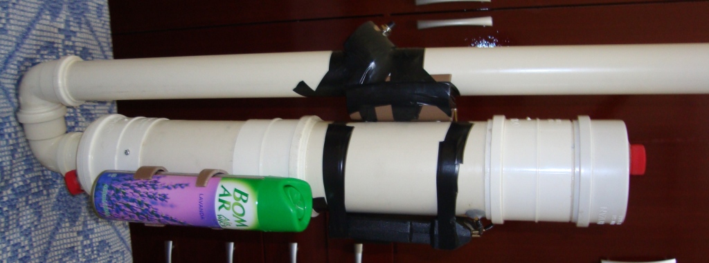

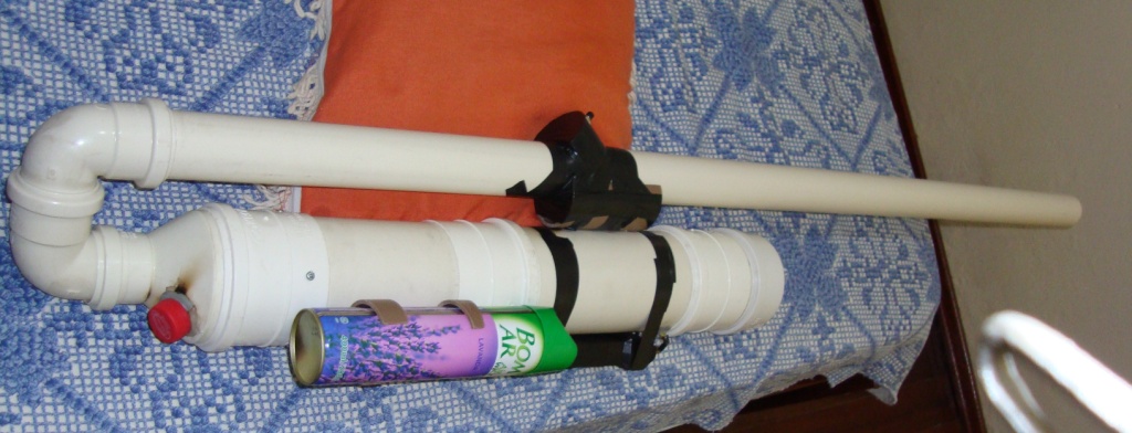

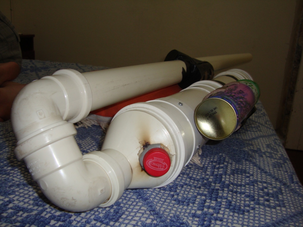

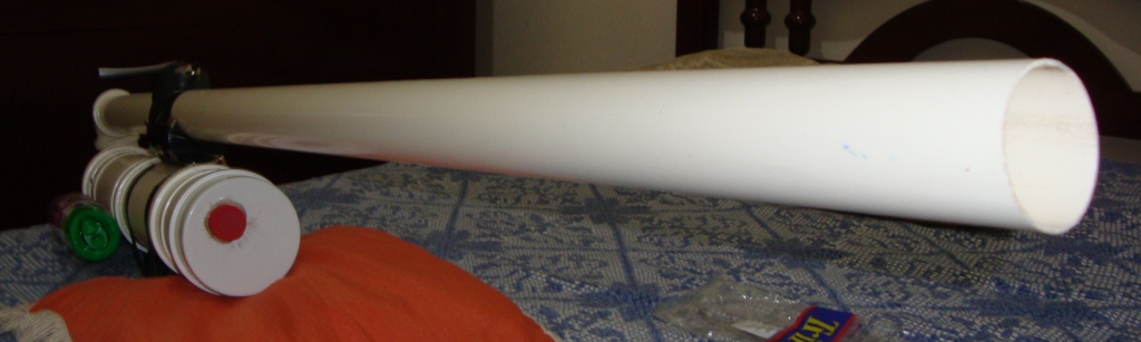

Just took some pics of my cannon that shows it from dif angles, they also show the 2 ventilation holes (1 @ the end cap and other @ the reduction).
I know theres some extra duct tape over there, but its a test version to see how it works, next one ill try to make a more "clean look"
My first potato gun and topic

Welcome to Spudfiles! It's a good start. I like the look of the gun. Generally over under designs are harder to get right and it looks like this gun functions very well!

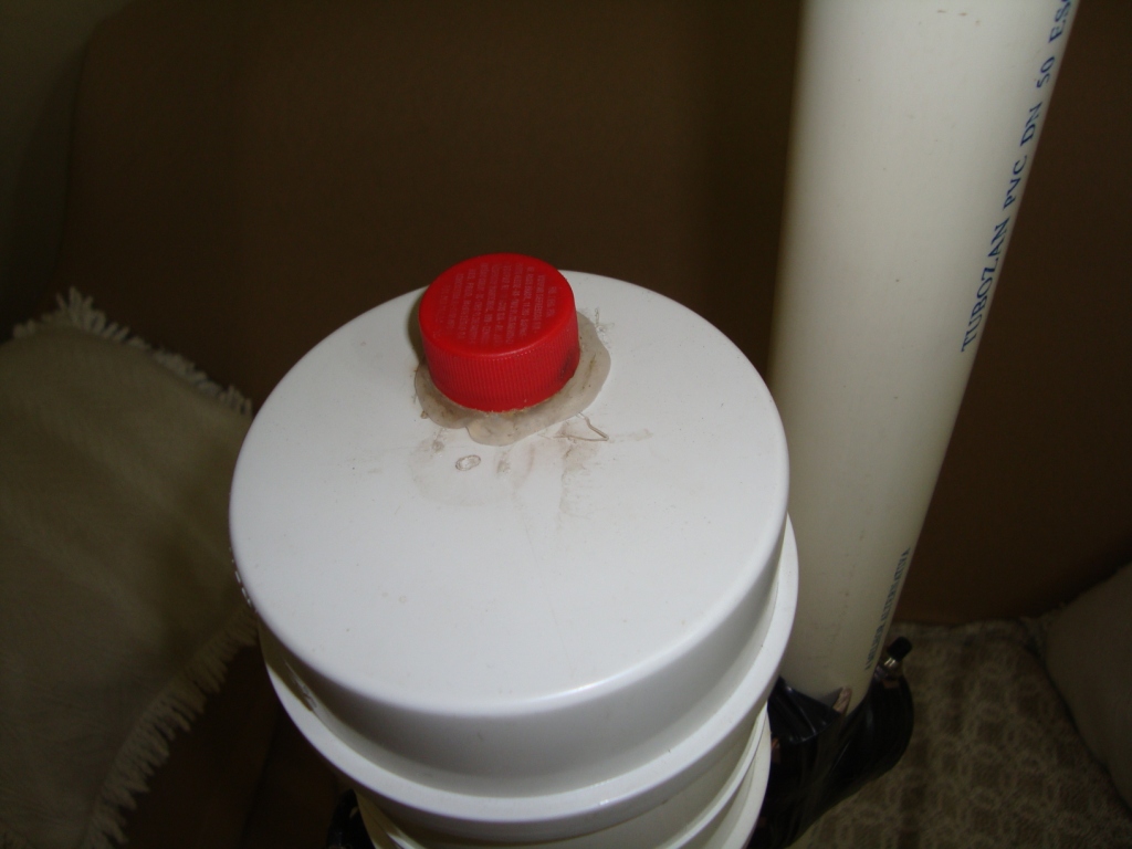

There are a few potential safety concerns. First This:
It is obvious that the hole you drilled and put in the bottle cap in is not sufficiently sealed (thus the burn marks) you are literally burning a larger and larger hole every time you light your gun off.
Second the very use of bottle caps as a ventilation system is poor practice as these caps are very weak, you are drilling through your PVC in a weak spot and putting in a weak cap... Well let's just say you are inviting a major blow out and hopefully nobody is in the way when it happens. (I can tell you based this gun off the Monkey Base guys design)
Last is that PVC pressure rated? Many accidents have happened resulting from people using none pressure rated materials.
Please don't take this as criticism, these are valid concerns for your safety and should be treated as such. This is a great start though, it is obvious you understand the concepts necessary to build a moderately complex gun! Great first post.
It is obvious that the hole you drilled and put in the bottle cap in is not sufficiently sealed (thus the burn marks) you are literally burning a larger and larger hole every time you light your gun off. Second the very use of bottle caps as a ventilation system is poor practice as these caps are very weak, you are drilling through your PVC in a weak spot and putting in a weak cap... Well let's just say you are inviting a major blow out and hopefully nobody is in the way when it happens. (I can tell you based this gun off the Monkey Base guys design)

Nice gun, but ditch the bottle caps and replace them the threaded pvc stuff. The bottle caps are bad, I think I've seen someone even use them as burst disk before.
Still, nice sweet work.
If you use somebody's design, always best to give credit.

Also, the bottle cap, properly attached (through a double layer of PVC) with the proper threads (probably part of an aluminum threaded bottle, which do exist), would be perfectly fine.

This pvc is none-pressure rated, thats why i covered it with that extra muffs on the middle of the chamber, the muffs are much stronger than the tube so theres no way for the tube explode there using simple fuel, It is easier to explode where the area is smaller because It creates more pressure (bottle holes for example)
The problem with that bottle cap, especially, happened because I barely sealed the hole inside the chamber that is the right place to do it. Luckily that problem appeared to this test version, now I can understand the forces and correct for the next versions. The same happened to the little holes I use to get the wires to the spark system and I'll fix using screws instead of pass the wires through a hole.
All these improvements will come in the next version and also I'll use a chamber fan and high pressure pipes that I'll get with a friend that works @ my city water department.

It is more likely to explode where there is a LARGER surface area! Pressure=Force/Area. The reason the bottle holes are unsafe is the fact that they are thinner then most PVC, and are glued in.It is easier to explode where the area is smaller because It creates more pressure (bottle holes for example)
Very nice cannon however. Glad you're taking our hints and learning from your design flaws. The cannon functions just fine, however!

Ok I'm glad you're open to suggestions. Ditch the pop bottle stuff all together, it's bad practice and quite honestly ball valves are much easier to use for the purpose of chamber venting and cheap to acquire. Never drill a huge hole like you have through a fitting such as a reducer. Use pressure rated PVC and, this is important, pressure rated fittings. The reducer you used does not appear to be pressure rated AND it has a giant hole drilled in it.
In fact theres no chance for the bottle caps fly out because I put them from inside to outside so the combustion press it against the chamber wall. What I made wrong was the silicone, I should have used something more powerful and designed to hold high temperature.
While I use simple fuel and no chamber fan @ this cannon it'll be safe i guess.
For the next cannon I found some pipes that hold 7.5 BAR or 110 psi. Do you guys know how much pressure one of these aerosols can make?
Silicone or hot glue cant seal presssurissed stuff. You'll need something like epoxy.

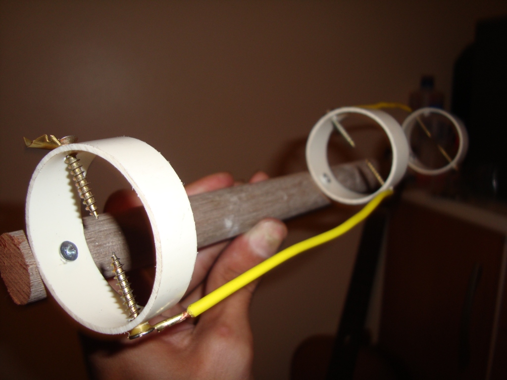

That spark gap is WAY to big. They should be less then a few mm added up to eachother. Im surprised that it actually works this way.
I bet that that air wick stuff gives the cannon a real flowery smell.

Now I added some epoxy to the bottle caps and where the wires get in the chamber, its working just perfectly and shooting around 200-250 meters.
That photo of the spark gap I took whem I made it, and it didn't work on first test. After that I replaced the screws and now it makes a huge and constant spark.
