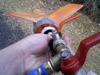

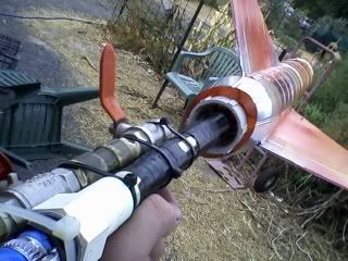

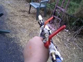

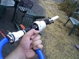

The launcher
Well, after the flogging the stationary launcher copped doing launch tube shots (large id cellcore guide) I decided to build a smaller, lighter, better handheld launcher and throw the larger launcher on the backburner until I have supplies for a booster launcher (1 main, 3 boost..).
It uses a clark cable design with a launch tube and o-rings to seal. A DWV fitting is used as the hold down collar. Originally, the design was going to use a pressure guage, but instead we decided to run the compressor air line through a high quality air reg and simply set that to the required pressure.
The air inlet is a quick connect, which can be replaced by a schrader valve if required. The first (RED) ball valve opens the airline and fills the rocket to the pressure the reg is set at. The second (ORANGE) valve is a safety. It's set to dump the pressure quickly in case of rocket fatigue/stress. If you wanted you could add a hose barb for remote fill, guage, second launch tube...whatever to the port. It's set up like that for safety. Pressure rated 1/4" id pipe connects the valve assembly to the launch tube.

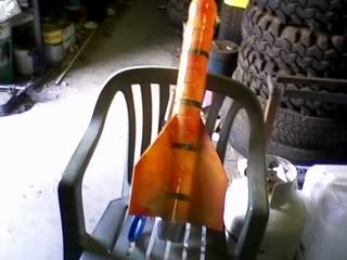

The new rocket
A new rocket was built after loosing my two best rockets to rooftops, each over 100m away (for reference, they had no chutes, were shot vertically and there was a fair amount of wind). This one is constructed from 1.25L bottles rather than the larger, draggier 2L bottles. (also, to what I've seen 1.25 resists more impacts/pressure). They were robinson coupled (bottom to lid) for maintenance/repairs. Another bottle was pressurised and thermalformed, then cut up and used as a nosecone. A shroud hides the neck, and streamlines the rocket. Large fins were cut from corflute (basically corrugated plastic-imagine plastic cardboard. Brilliant stuff.) and filament taped on for maintenance. The rocket was then finished up in red and yellow, with a silver shroud (spray cans).

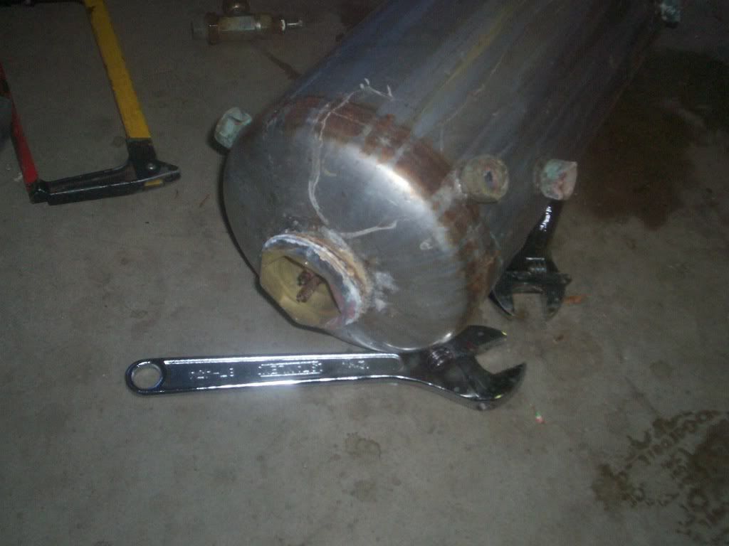

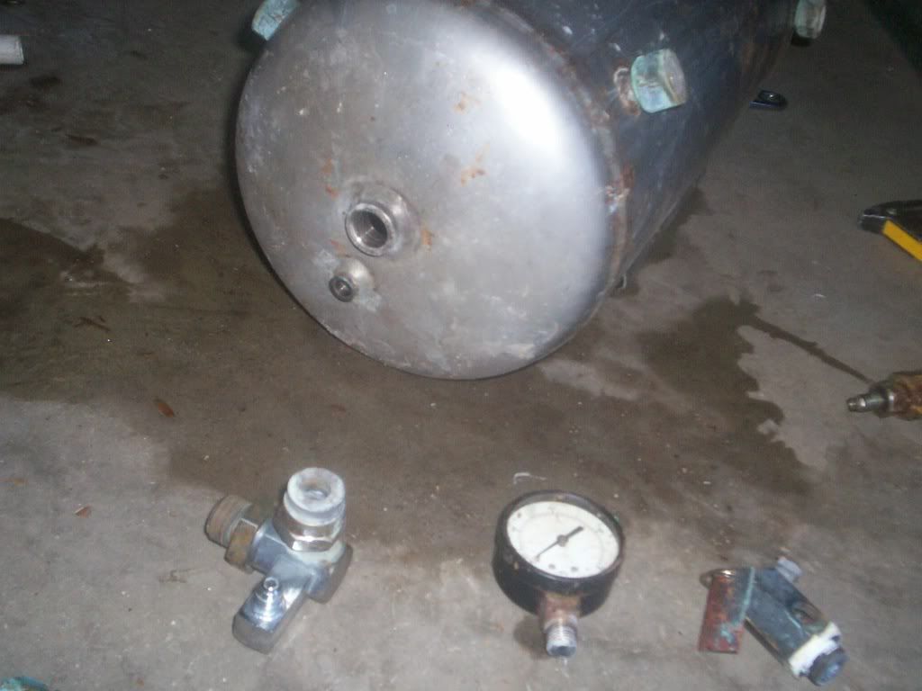

Well, following on from this thread I think I have a chamber. After tearing the coffee machine to pieces I got a huge stainless steel tank with extremely thick walls (I feel kind of sad that it will only be seeing below 150 psi...regardless it will be hydrotested.), a motherload of valves, pipes, nozzles, fittings etc..A pop off valve which is likely set too low for this, and a guage (unsuitable for this, will go into a propane fueling rig..).
Well, it has a lot of ports in it! hopefully I can find a use for each one.. Would be nicer than plugging them. All together, there's 8 ports! 6 Large ports, 1 medium and one small port. In the small port I'm going to screw in a tee and add a schrader and presta valve to it. One port will be used for a guage, one for an emergency valve (to purge pressure). It will have both a clark cable (or similar) and a quick-disconnect (water) launcher. One port will have a tee, with two ball valve leading to each of the launchers. Each one will have a pipe going to the bottom of the chamber (bottom half filled with water) with a tee and a ballvalve for each. Filling on the stand!. Needless to say two more ports will be used for either launcher, and a ballvalve for filling/removing water and then a quick connect to the compressor. The water filling may be given a miss.
As for the nice big stainless tube, I'm not sure. It will either be disposed of, used as a cover around the launcher (for firing rockets that have signs of damage) to reduce risk to the shooter or perhaps a guard for pressure testing. It's rolled, not drawn so a pressure application is out of the question.
The port near the bottom where the heating electrodes are will most likely be plugged with epoxy.
Any input? :twisted:
