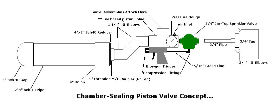

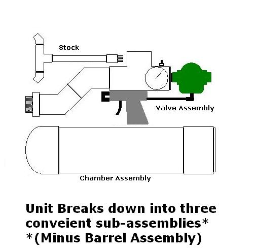

Just noticed I hadn't seen a design resembling the one I came up with this week. So far, I've acquired all the parts for it, aside from the sprinkler valve(which I have a three pack coming from Ebay). And I'll start building this darn thing tonight. Just wondering if anyone had any ideas or thoughts about it.[/img]

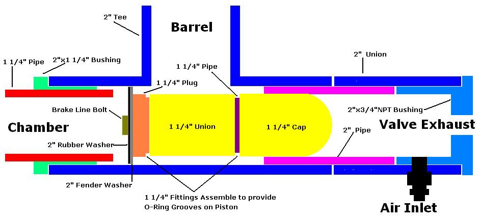

Here's a shot of the inside of the valve, minus the bumper and o-rings.
The launcher should be able to fit in a large suitcase when disassembled.
The assembled launcher, as viewed from outside.

A chambersealer.Boy, I havn't seen one in quite a while.
I suggest you plu the to 45 elbow in the stock.
No use venting air into your ear, now is there?
It seems like a fun project, because of the suitcase idea.
The cannon itself leaves.....room for improvement...
Next time, go with a barrel sealer.. :wink:

Oh, I guess I left out part of the butt, the top is going to be plugged, the bottom open so it'll vent into the armpit region. As far as barrel-sealing, I decided to do something a little different. This is my first piston gun, and I don't have access to as many tools as I'd like, since I'm building this in a hotel room as I work away from home quite a bit.
As a veteran, I'm surprised you didn't ask about how the air's going the pass the piston to fill the chamber.
As far as the suitcase thing, I just wanted modularity, which, with smaller chambers, could make it into something as small as a handheld.

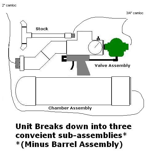

cool concept, have you thought of using camloc's for attaching chamber to valve, stock/exhaust to pilot valve/sprinkler, and barrel to valve... 10 second takedown... you can get camlocs from .5" up to 4"+....
edit: for adding diagram...
you didn't have the barrel or show where you're attaching the barrel, but you should get the idea...

If I could find a decent farm supply store here, I'd have gone that route, but as it is, looks like threaded joints are the best I'm gonna be able to do.

pharmboy wrote:If I could find a decent farm supply store here, I'd have gone that route, but as it is, looks like threaded joints are the best I'm gonna be able to do.
you should be able to find a plumbing supply house or tractor supply, they're all over the place...
What city are you in currently...?

using threads for assembly/disassembly might make for sealing issues, and with pneumatics, airtight between valves/pilots/chambers is a MUST...
Try using slic-tite instead of tape, might help the ease and airtightness of assembling/disassembling...

the only critical joint will be between the valve assembly and the chamber. I'll find some way to seal it up. I'm a bit disappointed w/ myself, it would appear I misspelled 'convenient' in my illustration

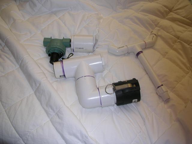

Made my way to Tractor Supply, got a pair of 2" cam-lock fittings. Also, found a lowed that has the 3/4 " sprinkler valve i wanted, so now I'm putting things together...

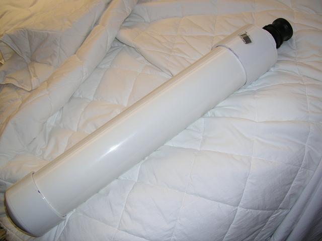

Got my chamber glued together last night. Gotta say, this thing might be a bit large to be shoulder-fired comfortably as planned.

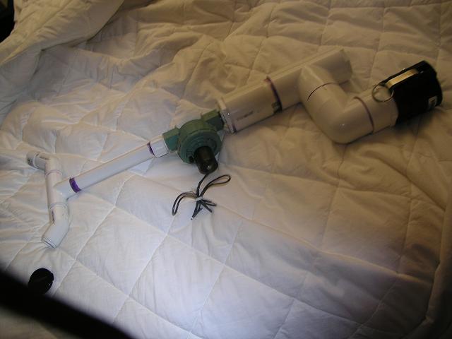

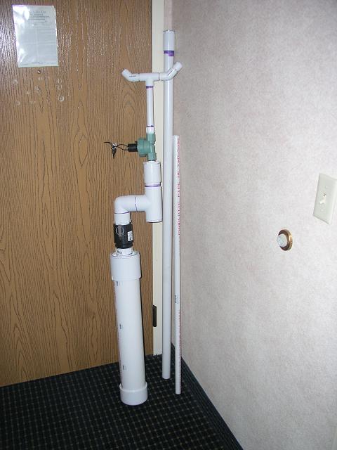

Managed to do a bit more assembly today, and it's shaping up quite nicely. Following suggestions from fellow members, I've decided to turn things around a bit and build it as a barrel-sealer.
Butt End.JPG (35.22 KiB) Viewed 3172 times
Working Parts.JPG (33.18 KiB) Viewed 3172 times
