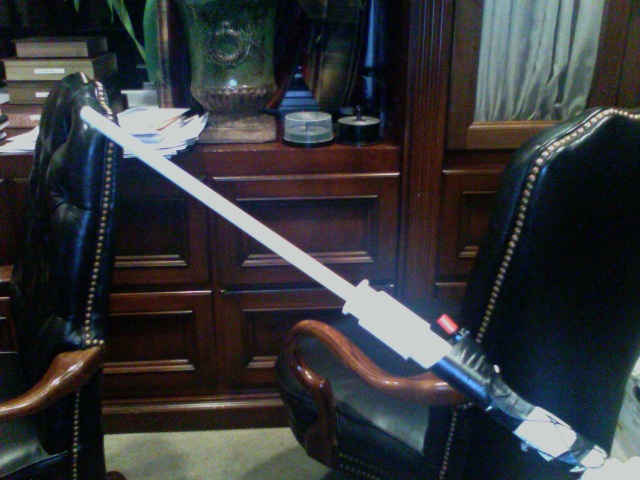

Hello there this is a simple gun that I was teaching my friend how to make.
Barrel: 1/2 metal piping 2 feet
chamber: 2 feet of 1 inch sch 40 pvc
ignition:piezo
Propellant: 5 seconds of propane
Combustion dart launcher

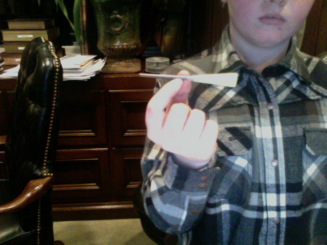

Do you use the nozzle to try get a good mixture (blowtorch)?. And also, a little tip for your darts. Forget paper, go down to a rural/farm surplus store and grab a heap of caulking cartridge nozzles (glue) for glue guns (not hot glue). Put one in your barrel, drag a sharpie round the excess and cut it off. Hole through the top, a nail and there you are..

sweet about the darts. Its just that I like building ghetto guns while I am building a nicer gun that just takes more time its just to let the time pass so i can put the finishing touches on my nicer one coming up. O i should have my nicer one up in a week maybe even monday. o and quick response

Dude... it doesn't look ghetto at all... You asked him to use PVC pipes and he used it!... Oh oh... there is electrical tape on it... it must be ghetto!... it's not. It's probably just cheaper to use tape. Give him a break man.
I think it's great! Is that pressure rated pipe btw?

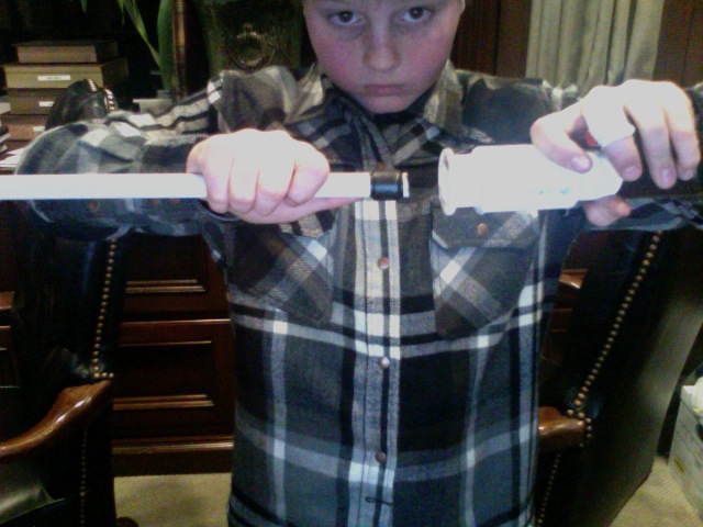

May I introduce you to this:
These things (but then for larger diameters) will look thousand times nicer then that tape.
Otherwise, try tie-wraps.
Is your barrel secured by friction? Like simply shoving the duct-taped barrel end into the coupler?
Thats NOT safe. Get a cam-lock, union or threaded fitting. One day the barrel will blow out and you've got yourself a harpoon gun.

psycix Yes my barrel is held in by the tape and I will fix that soon. I think that my gun bone breaker was much better than this gun.

not a bad build. I would be careful with the friction-held barrel, make sure to keep it clean and don't put anything on it that could act as a lubricant (if it's dirty, dry wipe it with paper towels or something). It's always fun to make small simple things like that, can't wait to see your "better one." Speaking of which, will it be pneumatic or combustion?
