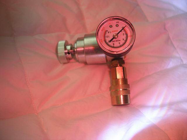

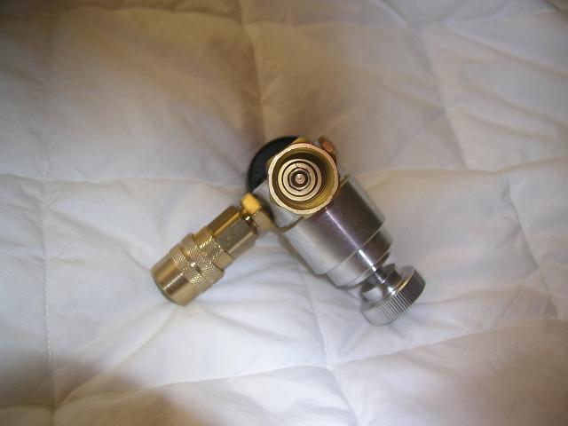

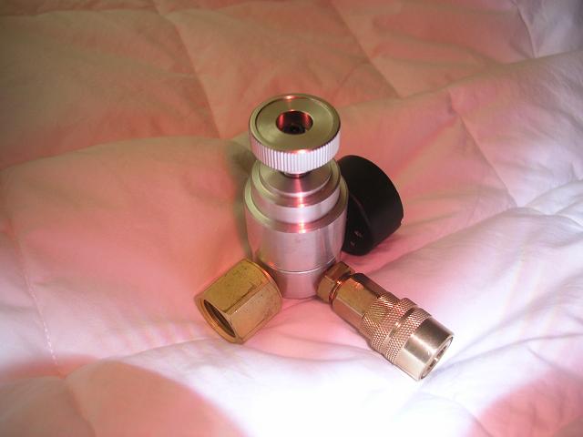

I got a bit curious. I know Harbor Freight isn't known for selling the highest quality products, so I took off the plastic casing to get a better look at the insides of this regulator. What I saw didn't look bad. Not quite as pretty as Palmer's, but it certainly appears solid and well made. The brass parts appear to be off-the-shelf, and the body is machined aluminum, probably 6061. I've posted pictures of the internals for your perusal.[/img]

Wow, it looks so much better without the covering!
daberno123
Posts: 594
Location: Ohio
I'll admit, that looks better than I thought it would. I wonder why they put that stupid blue plastic shell on it? :?
I still have to recommend the Palmers, but if money's an issue and you don't need any more than 150 psi then I suppose the Harbor Freight version would suffice.
@pharmboy
Any pros/cons you've found using this model?
pharmboy
Posts: 59
Joined: Fri Feb 20, 2009 6:25 pm
Well, the plastic shell includes a belt clip so you can hang it on your belt and use it to operate air tools w/ the included coil hose, plus it shields the sides of the gauge. I'm actually considering using this to run a mini-sandblaster to clean some things I've been working on.
Pros - Cheap, easy to use, warranteed for 3 years, solidly constructed, has a belt clip, should be easily modifiable
Cons - goofy looking in stock form, only rated to 150 psig, if you don't degas in the correct sequence, it will trash the tank O-rings when you disconnect the tank...
