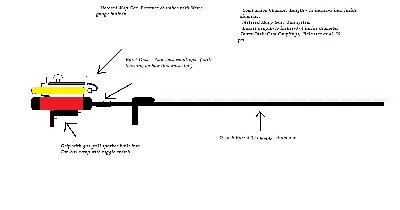

Hi I was wondering what the safest and strongest material to use as a combustion chamber is.
I was thinking of going 3 in schedule 40 steel pipng that is about 20 inches long and a 65 inch barrel. Its going to be a advanced combustion. Id like to be able to shoot marbles out of it using a very small barrel.
Could I use 3 inch Schedule 40 steel with a 3/4 outside diameter barrel >?? or whatever fits best for a marble. Or could I use 1 inch and shoot someother kind of projecile at very high speeds hopefully over 500 fps ?.
What is the safest material to use as a combustion chamber

Thanks... Ill prolly go schedule 80 just to be safe lol.
I want to have a fan, metered propane, and a burst disk that doesnt give away until like 50 psi or so.
How fast do you think it would shoot a marble with a 3 in chamber that is 15 inches long. and has a 60 inch 3/4 barrel ? or should I go 2 inch chamber at like 25 inches long to compensate a little bit ?
What setup would propell a marble at the fastest speeds
thanks
thanks

With a marble I'm guessing you'd easily get 750+ FPS.
Which setup would work the best ?
3 inch Chamber, 20 inches Long. Metered Mapp gas, a fan, Burst disk at 40-50 psi and a 3/4 outside diameter (or whatever barrel size is required for a marble) thats 60-70 inches long, and a gas grill sparker ?
Or 2 inch with the same setup ?
what Im afraird of is having a barrel to small, and when the fuel ignites it exerting alot of pressure on the chamber because of the small barrell size. Would I be fine with such a small barrell size ?
I don't know how fast it will shoot a marble. I hate marbles. Terrible ammo, inaccurate, poor penetration due to light weight and when they explode you basically get a cloud of glass dust. Not so fun to breathe in. Personally I have quit using marbles all together.
As far as your chamber question I have tried small chamber of about 2 by 6 inch. It works well, but my 3x14 works much better. Plus a small chamber is a pain to make advanced. Heck the 3x14 is a nightmare to construct.
