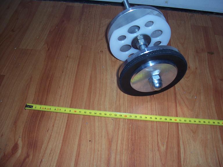

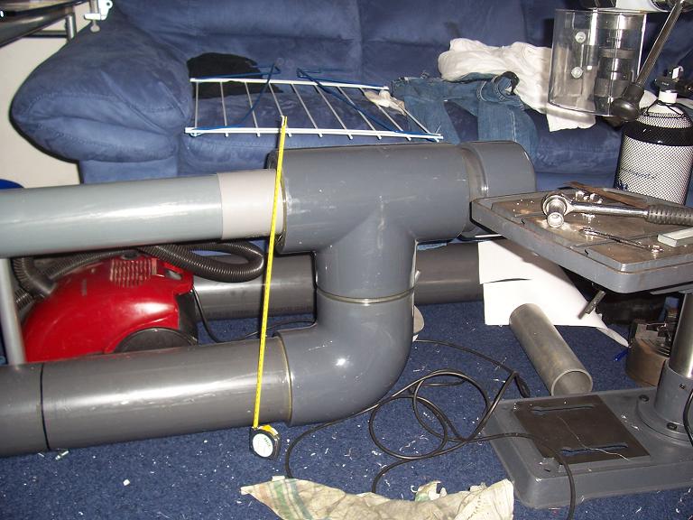

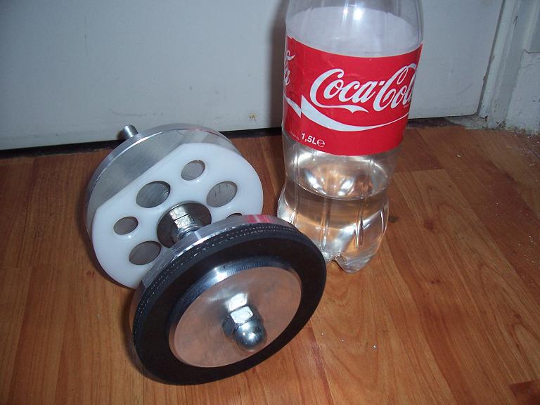

Ever wondered what a 4" porter looks like?
Built by Sam Tex, a.k.a, my brother:
6" reservoir, 6" Tee, 4" barrel
43 liter reservoir, all PN 16 Pressure rated PVC.
Piston was lathed.
Spot the spudrelated items!!<br /><br />The cannon is bigger than the couch..

What do you use for ammo for something this large!
With a piston like that (of that size) when it moves backwards, would it not droop in the time it takes to get into its "housing" pipe.
E.g. say the piston is in 60mm pipe, when it is actuated and moving between the barrel and 60mm pipe inside the tee, because the back disc is thin, does it droop and knock the60mm pipe as it's moving back?

Ammo is portrayed at the first picture... :D .A little loose fit though.
60 mm?? Try 140mm i.d.
The backplate is 10 mm thick aluminium, the middle is just to keep it straight.

I was gazing at the picture of the cannon and suddenly realized that the blue item in the background was a couch... :shock: And that piston looks like a dumbell from my gym... 8)
Is he going to mount that baby somehow?...yes...?..?
