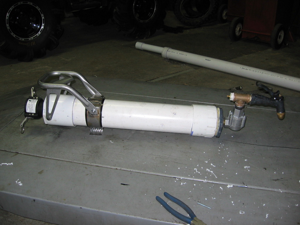

It's a Humphreys qev piloted 4"x24" toolie chamber, with 2" locking camlocks allowing 5 second barrel swaps...
The handle is the front bumper from a 4wheeler, the strap I built myself(who needs to BUY large clamps)...
The barrels are nothin' special but they are: 3"x 6ft(will launch a 32oz monster can well over a hundred yards filled with water, and no wadding), 2"x 10ft (will launch 10oz missils 1/4 mile), 1.5"x 66" (will shoot a water filled pingpong ball 1/4 mile), 2.5"x5ft (tennis balls go byebye), 2.5"x 2ft for playing fetch with the dogs using tennis balls...

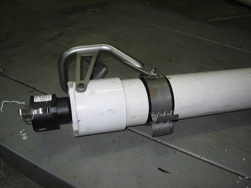

overall pic of the modular chamber..<br />layed out to shoot heavy stuff from large barrels...hence the orientation of the pilot sprayer and need of substansial handle.

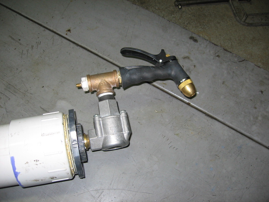

showing the pilot setup, the humphrey qev is so sensitive and quick you have to be carefull when removing the fill hose from the schrader, the schrader will pilot the humphreys...

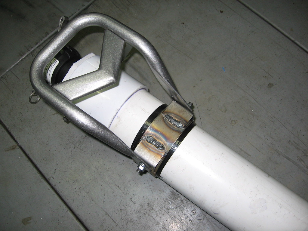

showing my handiwork of fabbing a clamp with mounting tabs....
showing the &amp;quot;clamping portion&amp;quot;, left the tag ends long as a base when not shooting.
showing the &quot;clamping portion&quot;, left the tag ends long as a base when not shooting.

Nice. Hows the weight balance?
jeepkahn
Posts: 747
Location: Triad, NC, USA
rp181 wrote:Nice. Hows the weight balance?
Quite well, except with the 2"x10ft barrel, and the 3"x 6ft barrel, but with the layout it's still quite easy to handle and fire accurately...

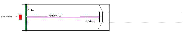

this is a toolie, I actually put a longer and radius taper into the endcap than what this diagram shows...

Oh yeah I thought that's what a toolie valve looked like.

If you put a check valve inbetween the schrader and tee then you wouldn't have the problem of the valve piloting when you take the pump off.
Badman
jeepkahn
Posts: 747
MaxuS the 2nd wrote:If you put a check valve inbetween the schrader and tee then you wouldn't have the problem of the valve piloting when you take the pump off.
FACEPALMHEADDESK!!!! Duh, Thanx for that, sometimes the obvious things evade me, lol, I wanted to stay away from ball valves for aesthetic reasons, but check valve just went whoosh over my head... :wink:
