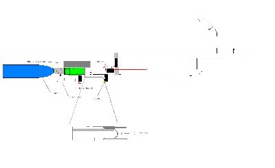

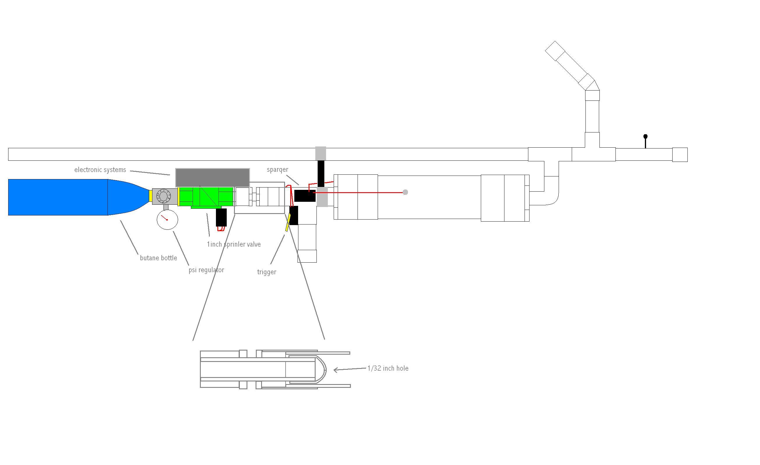

Ok, i made a plan of my electronic paintball project.
I would need your advice if it will work or any error in the design or things that i could fix.
Here is how it works:
1st: You reload with the bolt action mechanism( maybe not if i found a electrical piston to reload automaticly)
2nd: You press the trigger, wich activate a electronic system
3rd: After the gun is triggered, the solenoid valve opens and let the butane fill the chamber for approx 1-2 secs(i will have to make a lot of trial and error for this one)
4rt: after the filling is complete, an sparqer lights on and the paintbal is fired.
So its 1 shot at each 4 seconds.
For the one who will say that a sprinkler valve is overkill, i am obligated to do like that. If i get a 3/8 inch solenoid or something like that, the flow will make pop out the paintball out of the barrel. with the 1 inch one, i can reduce the flow up to 1/32.
If you have a better solution, plz tell me
I would really need reply's and your advice, because this will cost me i guess 100$, maybe more.

Looks like a solid plan, I've just been wondering:
How does the chamber get vented/refilled with air after each shot?
And don't you think 1 shot every 4 seconds would kind of put you at a disadvantage on a paintball field where people are walking around with guns shooting 24 balls/second?
There is a computer fan wich is also connectd to the prnted circuit board and that is activated before and after shooting.Looks like a solid plan, I've just been wondering:
Yea, it wont be a good idea to go on paintball felds, i will shoot my friends with it( they have airsoft)
Do you think there is an pc fan that can fit in a 2 inch pvc pipe?

There was a gun posted a while ago that had a pre mixed fuel tank eliminating the need for venting. Maybe you should go for that?

I wouldn't have thought that any commercial paintball site will allow you to use a homemade combustion gun....
It will not be allowed on the field.
Even the not-homemade tipmann c3 isnt allowed on most fields.
Sprinkler valves can NOT withstand alot of heat.
Metal construction is a must.
And last but not least:
Okay, so you will vent using a fan. But will you use a non-return valve or something like that?
Agree on the oxygen bottle.
I would indeed do it that way.
But oxygen comes with danger so be careful.
And ill just say it again: metal construction.
