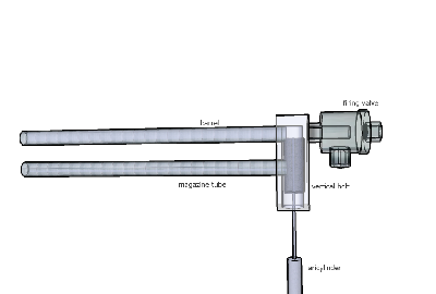

I saw the design listed here: http://www.spudfiles.com/forums/revised ... 17540.html and decided to improve upon it significantly.
It would use air as a power source and would probably shoot golf balls (unless I need to scale it down to marbles). Basically, each time the valve (trigger) is released, air forces the golf ball down the barrel and at the same time cause the bolt to move backwards and load a new round.
I may need to revise the design by removing pipe "3" and opening part of pipe "1" to have the air travel directly into the barrel, instead of in a complicated "U" shape.
The front of the bolt:

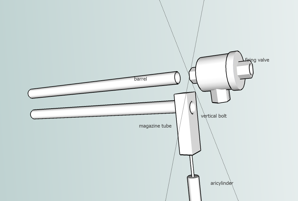

A view from the side. NOTE: numbers "2" and "3" are switched. It should follow the order in the first picture.
<a href="http://s614.photobucket.com/albums/tt22 ... annon2.jpg" target="_blank"><img src="http://i614.photobucket.com/albums/tt22 ... annon2.jpg" border="0" alt="Photobucket"></a>

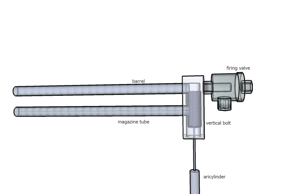

A view from above:
<a href="http://s614.photobucket.com/albums/tt22 ... annon3.jpg" target="_blank"><img src="http://i614.photobucket.com/albums/tt22 ... annon3.jpg" border="0" alt="Photobucket"></a>
Semi-Auto Pneumatic Design
Seems like a needless complication compared to the blow-forward bolt - unless I've completely missed the point.
That design involves a hammer valve that is triggered every time the bolt returns, so I don't really understand how you've improved it by removing this crucial element. Otherwise it would have worked just as well like this:I saw the design listed here and decided to improve upon it significantly.

@jsr
I agree it has nothign to do with the design he mentioned
but no, it's not a blow forward bolt (at least the way I see it)
it's just a little bit overcomplicated design which aims at using air pressure from the barrel to cycle the gun
basically it's the same thing as this ->> http://www.spudfiles.com/forums/gas-ope ... 17542.html
@PaulsAirsoftArmory check the thread mentioned earlier to see why it's not the best idea
if you want to do it you can use a simple T to do the job... Iam sure that JSR can provide you a pic of his attempt at a similar design

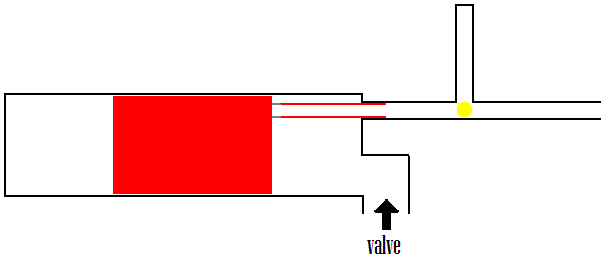

Have a simpler one:

Like this perhaps?POLAND_SPUD wrote:it's just a little bit overcomplicated design which aims at using air pressure from the barrel to cycle the gun
My design(or whoever came up with it before me..) revolves around the principle of using the motion of the bolt to control ammunition feeding and valve timing.
Still, it's a good design but as I understand it you would need a very uniform projectile that's an extremely good fit in the barrel, a very smooth piston et cetera.

well your design is superior to this becasue the piston is large.. whereas here it's smallish... obviosuly the design would mostlikely work better with a large piston
both of the designs are blow back bolts but yours is better becasue
if you want to experiment with designs go for it.. but if you want to build a semi that works then copy the design I (and several other members) built
I don't want to praise 'my' design and turn this discussion into something like 'mine is better than yours'... becasue it's all about improving things for the good of the community - not about competition...
if someone can design (and build) something that both:
offers better performance than the design I used and at the same time is easy to implement I'd switch to that design but so far 'mine' (I think that the first person who proposed this was al-xg but I am not sure) is still the best in both areas

Note the "Significantly" in the first sentence. The other design gave me inspiration for this design. Mine is a completely different design.
It wouldn't actually use the pressure from the barrel (as in a gas operated rifle), but two separate air chambers connected to a set of parallel valves, one for the barrel, and one for the guide rod. I know I didn't illustrate it, sorry. It is similar to the blow back design illustrated above, but more pressure/air is used for the actual propulsion of the round compared to the backwards motion of the bolt itself.
This design, if done correctly, would be more efficient than a normal blow back design, such as above. It could be even more efficient if I locked the bolt forward, used one valve to fire the round, unlocked the bolt, and then used a second valve for the guide rod. Almost like some sort of bolt action/semi auto design, with three steps. I know it sounds complicated, but I think I could get it to work.
so it's like mine.. but mine doesn't have two chambers for it, two 90 degree bends and two valves... one firing valve, one 90 deg turn and one chamber is enough

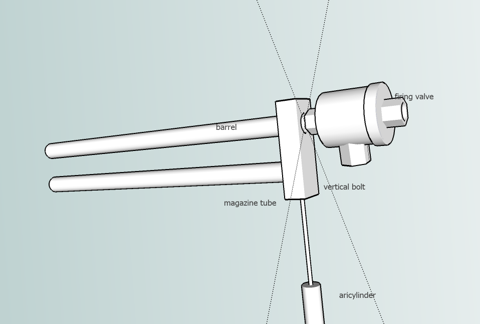

I don't agree that there has to be a 90 deg angle.. in fact with 'my' design you can both get rid of that and completely remove any obstruciton of the flow in the barrel.. you just have to put the air ram vertically and build a block with hole of the same ID as the barrel cut trough it... something similar was used on BTB's lever action gun...
there is another version of the same idea.. instead of moving the whole block you could have a solid bolt sliding in it and moving up and down
but I don't have enough time to build that...
EDIT
pics added
