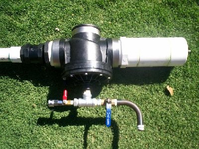

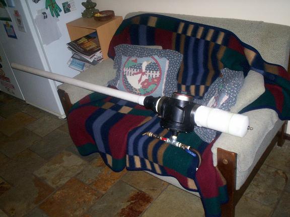

Gday ladies,

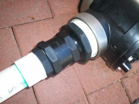

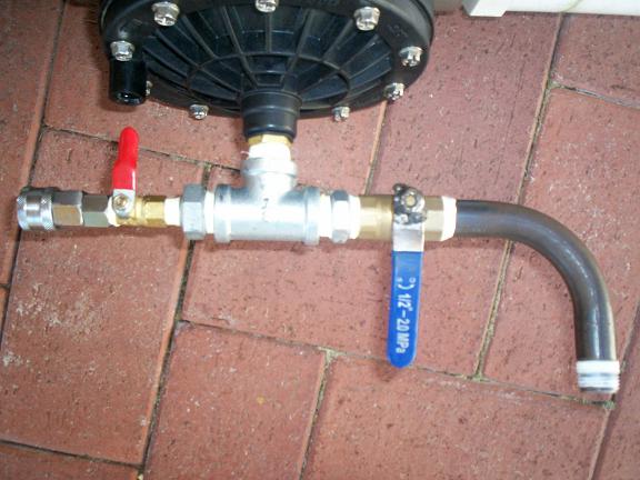

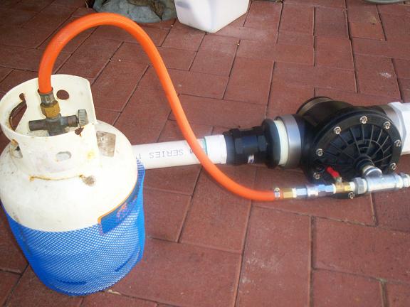

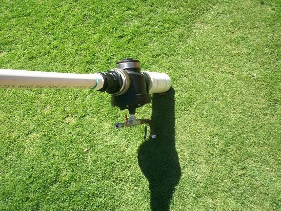

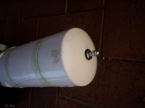

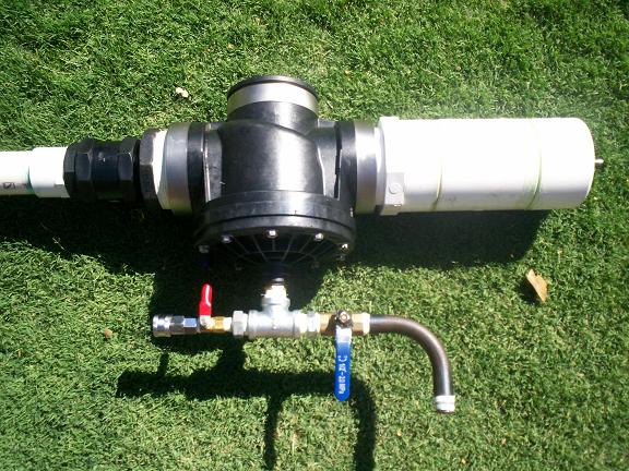

I have finished my new gun to the stage of posting it but it is far from complete. below are some specs and pics of the launcher.
Chamber - Double layered 3" chamber consisting of a 3" female slip to male threads adapter, 3" coupler and a 3" endcap.
Barrel - Multiple; 0.75", 1", 1.5", 2", 2.5".
Valve - Modded 3" Hunter commercial sprinkler valve rated to 220psi.
Pilot - 1/2" BV
Fill methods - propane and air.
Performance data will be available (damage pics and vids etc) as soon as i have time to go shoot the thing past 30psi (omg 30psi in this thing is like 60 in my 1.5" porter!).
Comments and critisisms (sp?) welcome and appriciated.

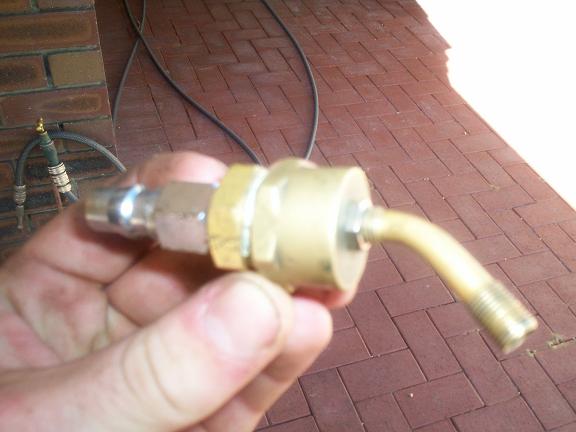

PS: i know the fill/pilot aint pretty and will be replaced will fewer specialty brass pieces.
Aussie spudders unite!!

That valve is so beastly! I can only imagine what it can do with a golfball at 100 psi. Or better yet, a frozen can of dogfood with a bigger chamber and 3 inch barrel.

Why use such a beastly valve on a portable cannon?
This valve deserves an huge cannon.

Think of it this way, I would technically get the same power out of a GB in half the barrel length than if I used a 1"
And as I said it will be made into a bigger gun with a bigger chamber when the space arises, at the moment it will stay as this except the chamber matierial. I will proberly make it twice the size and out of poly so the gun can be used at its full 220psi.

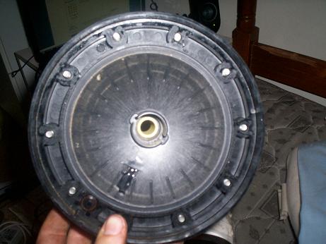

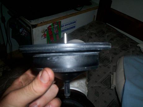

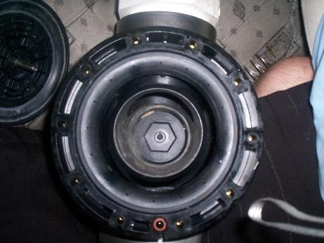

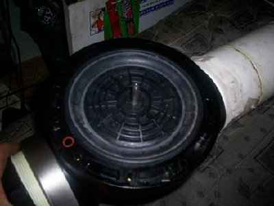

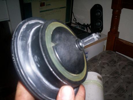

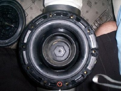

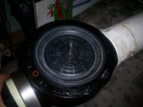

Speaking of which, have you taken apart the valve to look at how fully the diaphragm opens, the diameter of the porting, etc.?

Mark: yes i have taken it apart i will post pics in 10 or so ill edit ths post

mark heres the pics, i have now taken out the spring as i realised i would not need it, i think the sealing face moves about 1" up off the lip.
