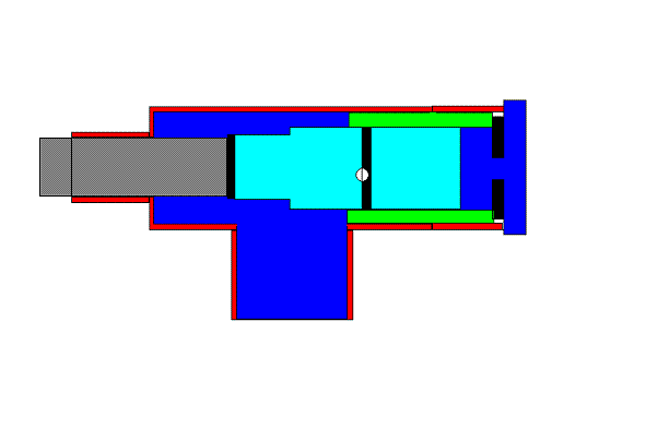

REAL bad paint drawing coming up...run while you still can! :lol:
The white circle shows where to drill the hole.

I'll give your concept a try tomorrow, how big should that hole be? like half way into my O-ring groove and halfway out like 1/8th size or smaller?

I used a 1/8" drill bit for the piston on the copper guns.
I only needed one hole, and will recommend you start with only one as well.
If the chamber doesn't fill as fast as you would like, enlarge the o-ring groove so that the o-ring fits looser before you drill additional holes.

That's what mine looks, did I go to big? I haven't tested it yet any input before I test it out.
Gippeto
Venezuela
Posts: 2506
Been thanked: 17 times
You went too big. :cry:
The hole is only supposed to go half way into the o-ring groove. This allows it to form a seal when the piston is being piloted.
With the hole going all the way through the o-ring groove, you no longer have any "check valve" effect.
But all is not lost.
If it was sealing as tight as you mentioned, you're probably okay still. You made an equalization port is all.
Your chamber should fill now, and flow back into the pilot area will still be VERY minimal. :D

The hole goes through the coupling wall only on one side, and it only goes halfway into the o-ring groove the pic distorts it for some reason. and the sealing face is on the opposite side.
