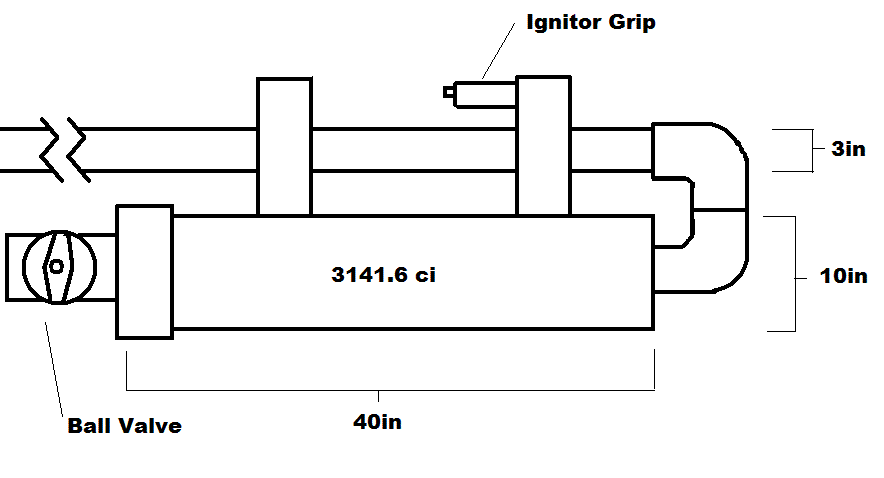

Hey all, I'm considering another cannon, a monster as is my specialty. I'm looking for PVC for my combustion chamber. I don't need 10ft of it and I also need it as cheap as I can find it. I'm looking for a 10in pipe at least 4 ft long at sch 80, I also need fittings. I have a rough sketch to show what I'm trying to build. I'll give details as asked.
This is the structure I'm trying to aim for. Some details aren't certain like barrel length.

A 44 gallon drum is huge, its, well, 44 gallons :shock: . But yes it could work. But I'm actually trying to make this a carry under over. Something similar to the drawing. I want to bring it to a gun range and scare the crap out of people who use over rated gunpowder :lol: :wink:

jook13 wrote:10 inch is WAY overkill for a 3 inch barrel, dont you think?
Eh maybe, but I want the biggest thing for a 3 in bore as possible. I don't know of any bore sizes larger than 3 that have commonly found ammo

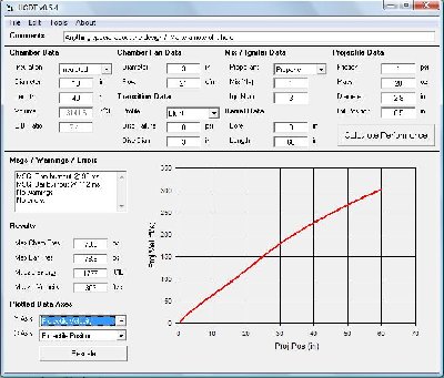

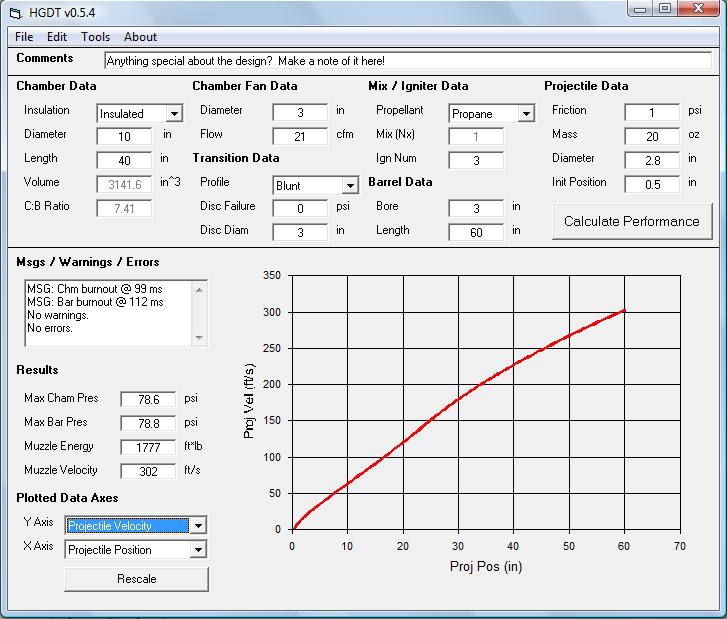

Mother of God! I just put the cannon into HGDT. If the barrel is at the right length (20ft :shock: ) a 20oz beverage container will have a muzzle velocity of 600ft/s! With the barrel length I can ideally add (5ft) it'll reach 300ft/s. I'll load the data in a sec.
Here is the cannon in theory
