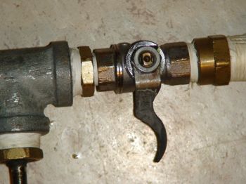

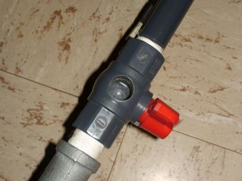

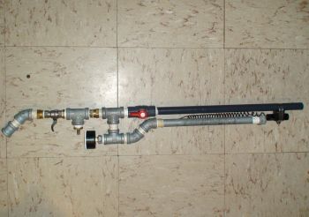

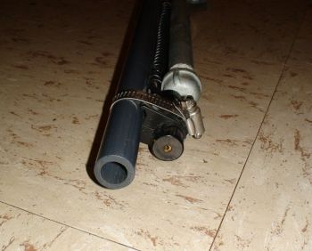

This is my latest project please leave comments likes/dislikes. The gun is all metal with some brass fittings. I choose PVC for the barrel because the inner is smooth. the whole length of the gun is 2feet 9inch and not that heavy, it's easy to carry around. This is by far the most powerful gun i've made :twisted: .
the trigger
the trigger
ammo loader
ammo loader
the barrel with laser mounted on
the gun
the gun

How's the ball valve trigger? Looks like you hip-fire this cannon with the trigger being at about your hip or maybe slightly further back?

I like it, but dislike the enormous pilot chamber volume.

You don't need the extra T in the pilot area if you fill through the handle.Just make sure you remove the schrader valve-stem.
If you made your piston right, it will surely actuate ( via bv)through an empty schrader.
Copper and aluminium are very suited to be used as a barrel.
The pvc ballvalve breechloader is very nice, but I'd go high pressure with this one ( effectively a sawed-off) so out with the PVC, in with metal!
