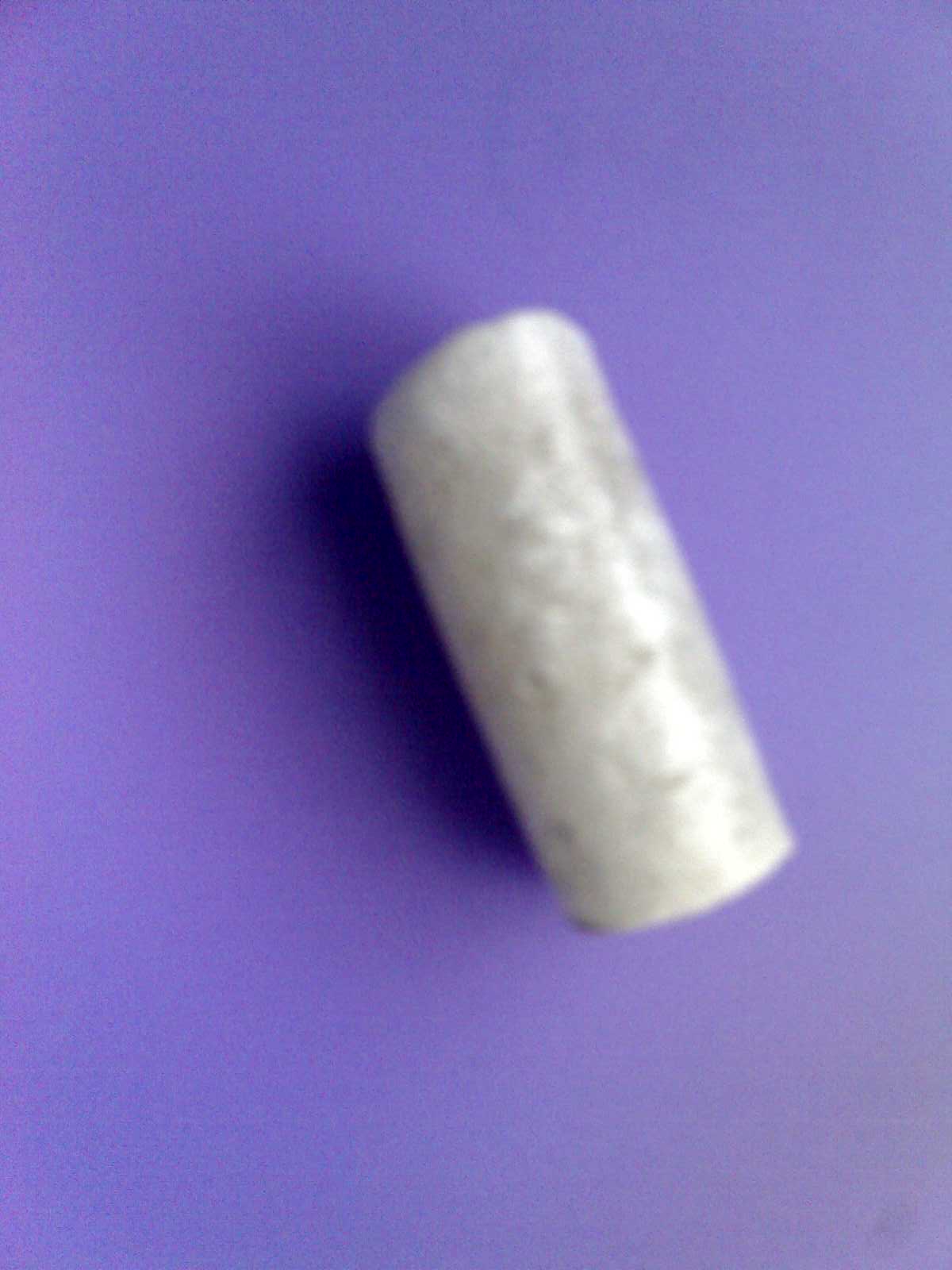

Well, I was planning a mini pneumatic coaxial gun, but I didnt know which material use for the piston. Some weeks ago I made a Polystyrene catridge, and its very strong and light.
I wanted to know if it would be used for a mini pneumatic coaxial gun piston, piloted by a schrader valve, something like jackssmirkingrevenge´s (http://i164.photobucket.com/albums/u28/ ... 512443.jpg).
It would go with some neoprene or rubber in the sealing face.
Please sorry my bad english, I´m spanish :)
Here´s the catridge. It fits great in 3/4" pipe

I think you should shorten it a little
euskalspud
Posts: 11
Joined: Tue Jan 06, 2009 12:45 pm
The plastic in the photo isnt the piston, is the ammo for my pneumatic rifle. I want to know if this material can be used in a piston.
Or are you telling me to cut the CATRIDGE? I´m new on piston spudguns.
Gaderelguitarist
Posts: 580
Location: Columbia, MD
It should work for a piston, provided you machine/cast it correctly and give it a decent bumper.
I'm not sure how impact resistant polystyrene is.
What pressures where you planning to run the co-axial at?

I´m going to use it at 90-120psi, but I´m going to make the chamber and the barrel longer than the gun shown in the photo.
EDIT: Sorry but could you explain me what the bumper is? Or post a link where it is explained.
ramses
Posts: 1679
a bumper is a piece of squishy material that keeps the piston from slamming into whatever is behind it. stuff like nerf footballs, pool noodles, etc. have been used. a good test is to put the bumper on a piece of wood and hit it with a hammer. It shouldn't be too loud, and the bumper should spring back up quickly.

Oh, Ok. Thanks! So, It may be something like a sponge or a spring.

Then, that material can be used as a piston at those pressures?

By polystyrene you mean expanded foam used for packing?

No, I take polystyrene (expanded) and pour it in big quantities in a container with some acetone. The plastic "melts" and gets "compressed". So that big quantity of expanded polystyrene became into a much smaller mass, and when it gets dry, it is very very strong. Similar as polycarbonate (which is stronger than methacrylate).
I´m going to shoot it with my rifle at high pressure against a rock. Then i will see if it is strong or not. im going to record it.
Has thanked: 581 times
Sounds good :) personally I think epoxy resin is more convenient but this is definitely a cheap and practical way of casting, I would think it would make good material for a piston as long as there was some rubber added as a sealing face.
