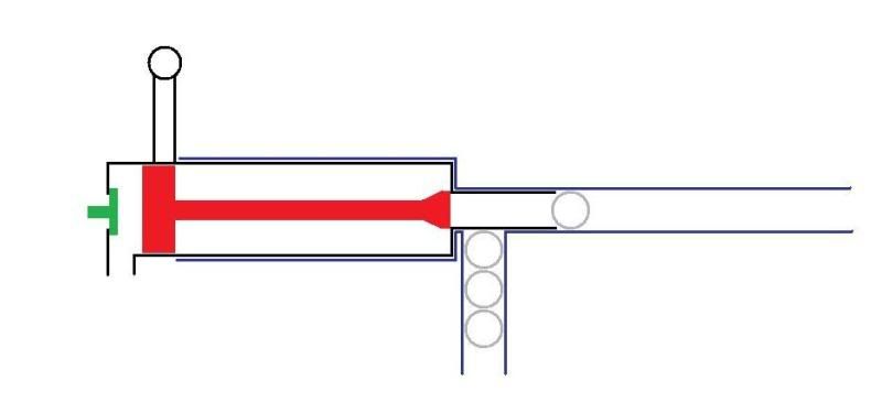

a bolt action piston rifle is exactly what i plan to do. this is just a quick mock up of the co-ax bolt. the co-ax is the bolt and the piston has been changed a bit. i'm also gonna install a hammer valve so i can use a real trigger system to pilot (give it the real feel of firing a rifle). i'm pretty sure that most of us know how a mag works so i didn't put much effort or detail in illustrating it. i'm open to any suggestions.<a href="http://s90.photobucket.com/albums/k273/ ... onbolt.jpg" target="_blank"><img src="http://i90.photobucket.com/albums/k273/ ... onbolt.jpg" border="0" alt="PISTON BOLT"></a>

if u do some planning u'll probably find that u don't need to make the coax huge. just make if the right volume for the barrel. i think u should stick with the idea. also the piston in my pic is actually easier to make than the usual coax and will seal better. it will also eliminate the deadspace that everyone complains about. keep the idea alive.
