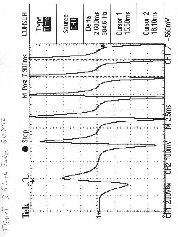

In theory, a 2.5 inch barrel over 20 feet long would do best with the 700 cu in tank. Less than 10 feet worked better when tested.
T shirt test showing terminal velocity in the 2.5 inch barrel  Rising zero crossings on the waveform are the center of the 1 foot pick up coils on the barrel.  60 PSI 700 cu in tank, 2 inch QDV valve.
