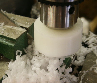

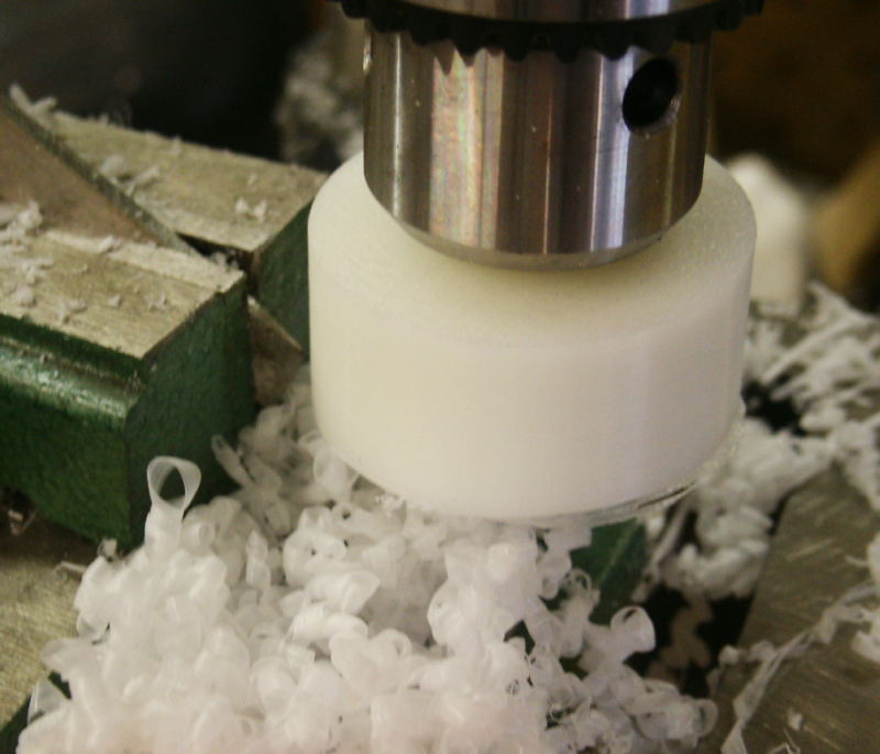

A good drill press with a good drill vise can be used for machining some simple parts and can be purchased within budget. I cut my pistons on a drill press.
Think on spending a couple hundred on a really good drill press and another hundred on a reasonable drill press vise to hold machining tools. An X-Y vise is worth the investment.

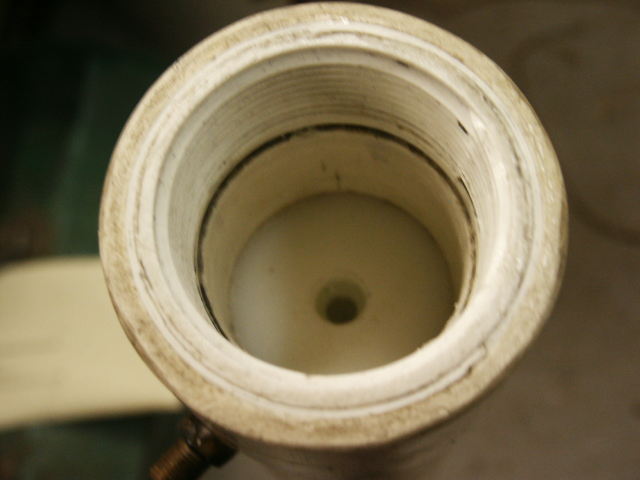

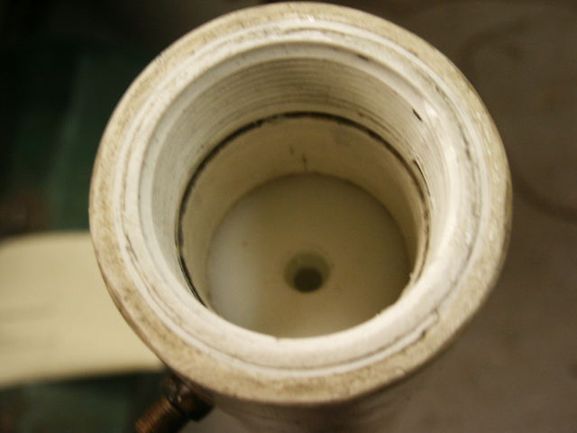

Maybe my lack of skill is showing, but this size fit is hard to achieve on a wood lathe. The valve doesn't stick and uses no o rings.mark.f wrote:Take a look at LaunchPotatoes. Every component is made on a wood lathe.Technician wrote:Hand held on a tool rest is ok for decorative woodwork, but not for precision piston faces. The vise is the tool stock when using a drill press to machine pistons and pop off valves, hammer valves, etc.
