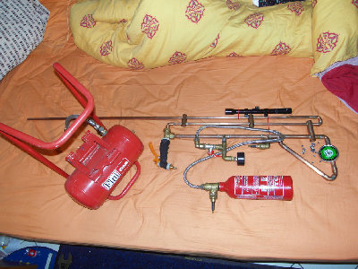

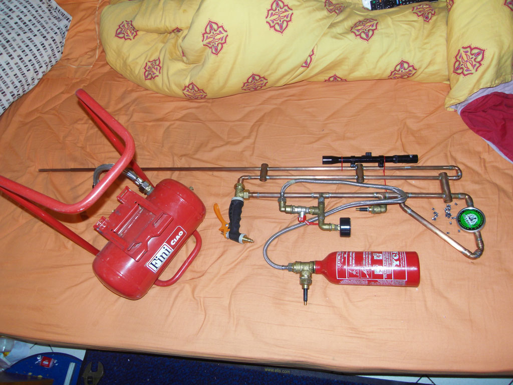

Hello , I'm french. Sorry for my English but I use the voila translator therefore I hope that you will understand the bulk.
Total length : 1m20
Weight : 3 or 4 Kg
Caliber : 5.5mm
Pressure : 1bar to 25 bars / 15 to 360 psi
Speed : 175m.s-1
Power (J)] = 8J with a 5.5 projectil
Loading: Bolt action
Valve : Homemade 3/4 Qev
Barrel : 1m 6mm
Chamber : 1m 16mm
With 6 liters chamber = 30/35 fires
With 1 liter chamber = 5 fires

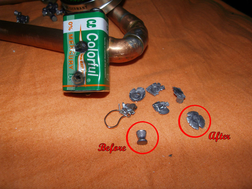

Ammo before and after fire :p

hey nice canon you have
so with thews pellets how is the accuracy ?can you hit 5" target from 50 meters ?

It does look unnecessarily complex but plenty sturdy and well constructed, especially for being soldered copper. Some action video is always appreciated.

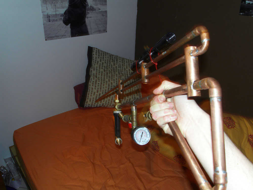

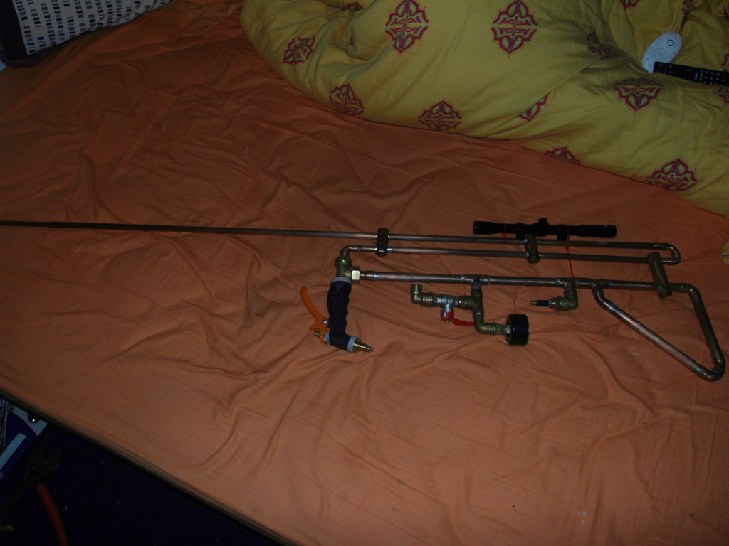

Does it really have a length of pipe and 180 bend between the QEV and barrel? How much dead space does it have between the valve and projectile? :?: Looks nice. I haven't seen the larger pipe used as barrel supports like that. Nice.

Interesting build. Next time I think you should try to get a little less space between the piston valve / QEV and the barrel, it'll improve performance I promise :)

Asides from trying to reduce some dead space this is a nice, well constructed and impressive cannon. It will be good to see what you can pull off in the future.

as everyone said before.. reduce the deadspace.

Looks like a great plinker. What sort of accuracy?
You need to mount the scope better but looks like you have it all set up for good fun.
I like the baby bottle setup. allows for a few shots before refilling. I got sick and tired of constantly pumping up my pvc gun with a hand pump.
