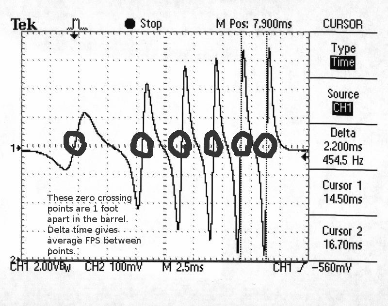

It was hard to tell with the digital scope. It was within +_ 2 counts on the scope. Measurement margin of error was masking the actual launch margin. It was pretty tight on the foam ball. Our sample size was quite small when we found this and moved on to graphing the pressure/mass/speed and spent less time on repeatability. I would take a rough guess at repeatability of close to 2%. The older scope doesn't have that many horizontal pixels to measure, so the bit to bit measurement error is large. It was fun playing in the reigon of does not launch to just launched. The launch distance in this riegon is highly variable as the vacuum pulled and friction makes this region the most difficult to predict the launch velocity if any. Small parameters make large distance changes. Trying to repeat a 25 foot 45 degree launch is very hard. Friction variables are a large portion of randomness. High pressure is very repeatable.jimmy101 wrote:How consistent is it? 1%, 0.1%, 5%?Technician1002 wrote:Yes. On the t shirt cannon when scaling pressure/ speed and distance, we have lots of in barrel acceleration data. The variability is very little.
The shots became about as predictable as shooting the same rock over and over from a slingshot.
When plotted, the pressure/speed showed the curve often seen in GGDT. When trying different barrel length/diameter combinations we started testing for just the minimum operating pressure to eject the projectile and a couple top pressure graphs for distance, a couple Rose Garden Arena distance prediction tests and didn't bother to fully fill in the spaces because of the high predictability and my shirt catcher was rapidly disintegrating. With the data, we could pretty much put a shirt anywhere we wanted to at the game including tagging retired numbers above the 300 section and the back row.
We first started testing at 10 PSI increments. Once we had a baseline, we didn't test outside our area of interest and focused on performance in a narrow band. We tuned to launch T shirts into the 300 section at the Rose Garden Arena and for Distance. Launch speed was good. We needed to focus on flight dynamics. Hitting 400+ feet with a rolled up t shirt is not easy. Doubling the pressure changed the landing zone by an average of 25 feet. 30 PSI and 60 PSI gave very close to the same range even though the launch speed was vastly different.
