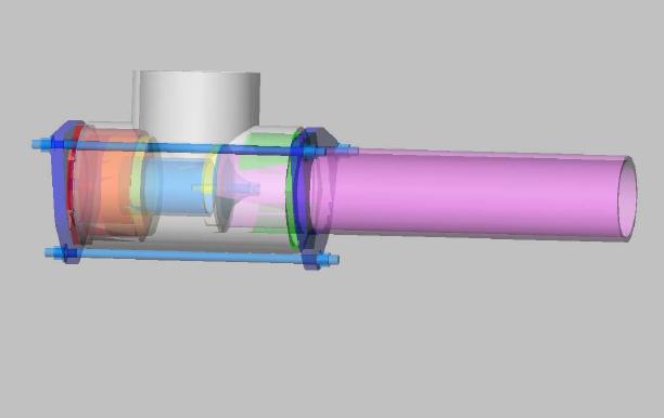

my uncle and i designd this, all the parts are built, and just need to be assembled. its nothing special in terms of design, but it IS one of few 4" pistons, and is pretty nicely detailed. pictures and videos to follow after saturday (i only go to my uncles place on saturdays)

That's a great idea to use an external bolting system, although a little cumbersome. What pressures are you planning on running this on?
Good thinking in designing the piston face. Few piston guns have the cone and it improves performance by directing air flow into the barrel more.

Sweet. :D 4 inch, is that the piston OD or is that the valve seat orifice? :?:
I'm asking to compare to the 3 inch QDV I 'm working on. If you have a 4 inch orifice, watch the recoil. :shock: A 2 inch valve with a 3 inch barrel left me a nasty bruise and about knocked me on my butt. A 4 inch will need a better anchor at the same pressure.

the housing is a 4" PVC sch40 T, the piston is made out of PVC sheet turned round (coud have used rod but we didnt have any) connected by 2" PVC. the cone on the front is aluminum, and the external plates are also madu out of CNCd aluminum
grock wrote:the housing is a 4" PVC sch40 T, the piston is made out of PVC sheet turned round (coud have used rod but we didnt have any) connected by 2" PVC. the cone on the front is aluminum, and the external plates are also madu out of CNCd aluminum
So it is a 4 inch with 2 inch porting or for flow about the same as my t shirt cannon... It looked bigger on paper. :( On the bright side, the 2 inch kicks butt. :D I gotta get my 3 inch finished.

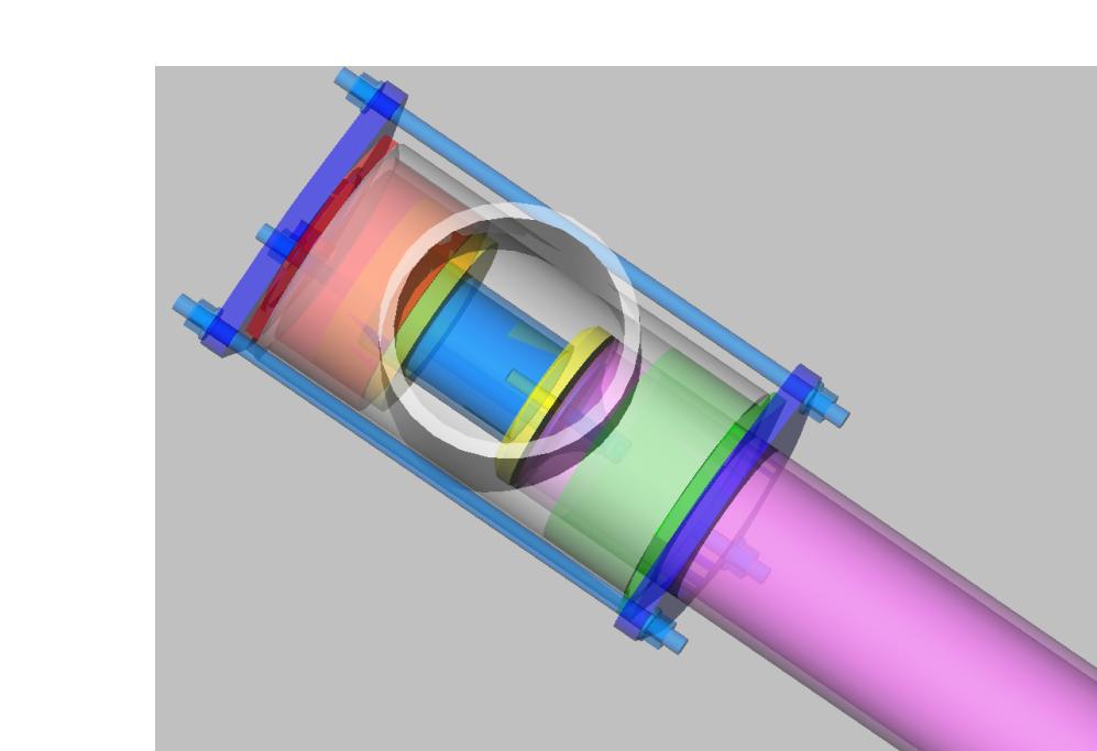

I think it is actually 3" porting 8) , the 2" PVC I think he was talking about is the section that joins the piston face and the piston in the pilots area (the yellow parts)

What size is the magenta barrel, the restriction in this valve?

subsonicspud is correct, it is a 3" porting. the magenta barrel is 3"
