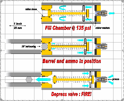

Following my Kick’n’Blow concept and after computing a few values for spring forces and playing more with GGDT, I finally concluded that a spring will never be able to reach some interesting power with the short overall length I seek for my project. So I’m back to the drawing board, with my first idea as a PCP six-shooter (or five ;-) !)
I have learned a bit about the existing chamber concepts, thanks to the great Wiki.

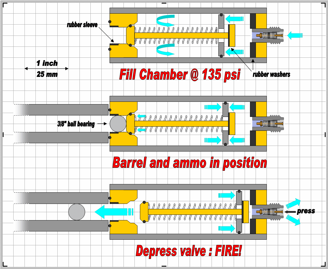

My idea is finally a mix with an oversized Brocock cartridge, a sort of barrel seal but with direct flow and no vent hole so I guess it is more like a Chamber seal in term of efficiency. I would like to use the Schrader valve both as an intake and as a trigger.
I designed it to be easily machinable, there’s no real difficult piece there. And I guess it can be easily oversize to fire some spuds :-D so you may find it interesting enough.

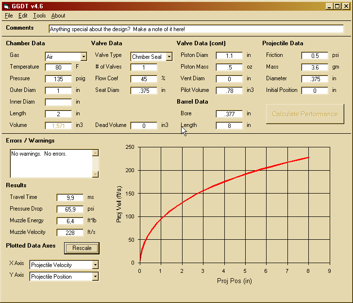

Also, I have difficulties to estimate GGDT results for potential damages :-)
I intend to fill the chambers at 135psi, which is the power my workshop compressor provides. What do you thing of those results, a 3/8 steel ball bearing at 228 ft/s and with a kinetic energy of 6.4 feet-pound. Is it serious, average or weak?
Of course, the same with a 3 or 4 foot length barrel become even more powerful, and thinking about it, it would not be the first gun that can be transform to a rifle ;-)
Colors identify yellow for brass, gray for aluminum, and black is rubber (O-rings or washers)

first comment yay, nice design its kinda like a mini toolie piston you could attach a mini qev popoff and make it full auto, again nice design, when i first saw the name it sounded like something bad but its actually something good
Reminds me of an idea I once had ;)
Looks good, but you really should consider ashock pump to go to higher pressures. 6 ft/lbs is the legal limit for air pistols in the UK, not bad in terms of power but you can do better ;)

I'm not familiar with those items: Shock pump. I read a bit about them through the forum. I am guessing they are capable of high pressure, a tiny amount at a time. Right? How much time do you think would be needed to go from 135 to say, 300psi on my 1.5 in3 cartridge?
300 psi would double the muzzle energy, and increase by 50% the velocity. Just like having a 3 foot long barrel at 135psi :-D
And 300psi + 3 foot barrel is really nasty... 30 ft*lb and 490 ft/s
I really have no clear idea about what pressure my cartridge could take. The good thing is that it I want to do more, I'll just have to pump. I'll make sure to oversize the attachments, just to be safe. How much do you think it could take, reasonably? I intend to attach the brass to the aluminium cylinder with several steel spring pins, and a 1" diameter O-ring to seal it.
LeMaudit wrote:I'm not familiar with those items: Shock pump. I read a bit about them through the forum. I am guessing they are capable of high pressure, a tiny amount at a time. Right? How much time do you think would be needed to go from 135 to say, 300psi on my 1.5 in3 cartridge?
Have a look here (second one on the list is brilliant :D), cheap and for small chambers it doesn't take long to get to high pressure.
For smaller calibres, higher pressures really make a difference, especially if you're limited in barrel length and chamber size.
I really have no clear idea about what pressure my cartridge could take. The good thing is that it I want to do more, I'll just have to pump. I'll make sure to oversize the attachments, just to be safe. How much do you think it could take, reasonably? I intend to attach the brass to the aluminium cylinder with several steel pins, and a 1" diameter O-ring to seal it.
If it's an all metal cartridge would say it should take 300 psi easily, even 400 if the wall thickness of the chamber is big enough. In my cartridges I was using a PVC body (with a 3.5mm wall thickness) and they take 400 psi without problems.
One word of warning which I found out with my prototypes, with pressure the cartridge tends to expand slightly, so if it's a tight fit in your breech when empty it might get stuck when under pressure.

LeMaudit, it's an interesting proposal, and definitely do-able.
I will tell you from experience though, that the o-ring on the sealing plug will depart down the barrel with the first shot. :(
Consider machining a teflon or delrin seal, and attaching it with a small counter sunk screw.

I will tell you from experience though, that the o-ring on the sealing plug will depart down the barrel with the first shot. Sad
_
You think so? hmmm... I think you're right. I have very little experience with O-rings. Well, machining a washer seal is not a big deal. Thanks I'll keep that in mind.
