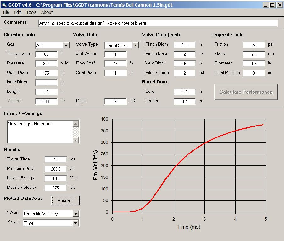

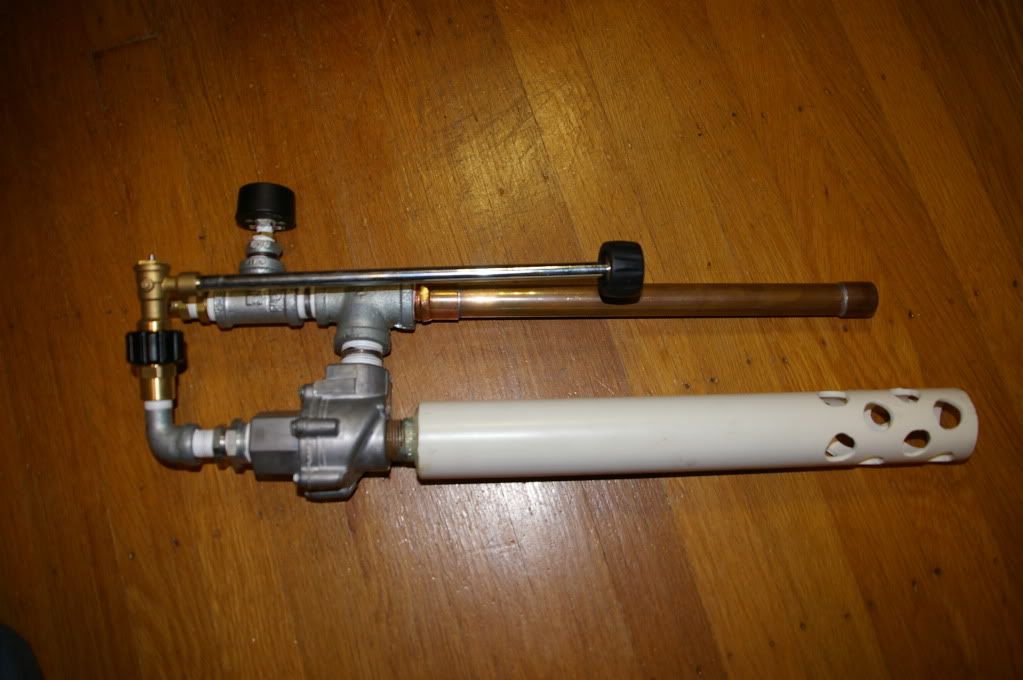

Well I made the prototype, using a 1.5" barrel for catnip tennis balls.
The chamber is 12" of 3/4" copper (cheaper than making it out of iron, for some odd reason...)
Here is the GGDT model:
When I actually fired it though, I didn't get near as good of results. Any clue why?
250psi, I got 200fps
300psi, I only got 220fps. That is drastically lower than the predicted 375fps

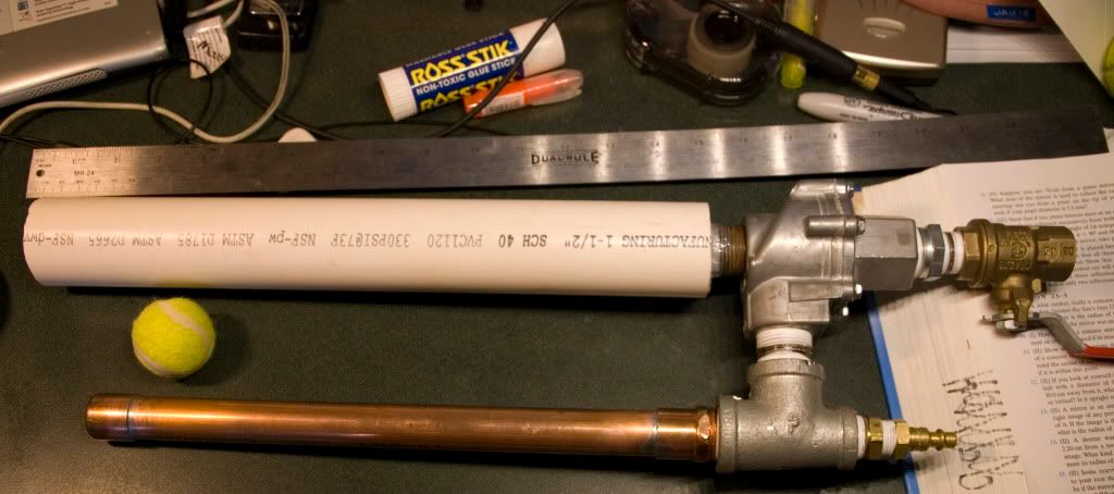

Alright, here it is, posing next to the 1.5" tennis ball. There is a 2' ruler behind it for scale.
My guess, after discussing with Davidvaini and ilovetoblowthingsup is that the flow coef that I used was too optimistic, so I am actually pulling a vacuum by the end. I am going to drill so wholes in the end of the barrel, to effectively shorten it (as well as for my future suppressor.)
Any other advise is gladly welcome.

The main problem I see is you modeled a barrel sealer valve and are using a 3/4 inch QEV as the main valve. It's a whole lot smaller than using a QEV on a barrel seal piston valve.
The 3/4 inch measurement on the QEV may be just the pipe size, Open up the valve and measure the actual size of the valve seat orifice and plug this new much smaller value into GGDT.

I did. As you can see from the photo, I am using a McMaster 3/4" QEV, and the seat diameter is 1", while the piston itself has a diameter of 1.9". Is there something else I should have been measuring, other than the diameter of the part of the piston that "sees" the barrel, rather than the chamber?
One clarification though, is "Vent Diameter" supposed to be the diameter of my pilot valve?
Lentamentalisk wrote:I did. As you can see from the photo, I am using a McMaster 3/4" QEV, and the seat diameter is 1", while the piston itself has a diameter of 1.9". Is there something else I should have been measuring, other than the diameter of the part of the piston that "sees" the barrel, rather than the chamber?
What is the SMALLEST restriction the flow goes through getting out of the valve. The 1 inch piston seat is not the right measurement to use if it has to exit through a 3/4 inch pipe. Use the smallest diameter as the seat size which may be the ID of the pipe screwed into the valve or the hole in the seat which may be smaller.
Having a 3/4 inch pipe with a hole in the middle of 1 inch is a pretty good trick. :)

Even when I lower the flow coef to 35%, and the seat diameter to .7", I still get velocities in the order of 300fps, not 220fps. In fact even if I lower the flow coef to 20% it is still at 250fps...
Lentamentalisk wrote:Even when I lower the flow coef to 35%, and the seat diameter to .7", I still get velocities in the order of 300fps, not 220fps. In fact even if I lower the flow coef to 20% it is still at 250fps...
Part of that is the valve type you picked is one assuming the piston is "in" the chamber. The over/under QEV has more plumbing and bends to get to the valve which creates a ton of turbulence before it reaches the valve. As the flow tries to approach supersonic, it can't negotiate the corners without a lot of friction.
I don't have GGDT on this computer. Check your valve type selection. You may find a better match as some popular vavles are modeled in GGDT.

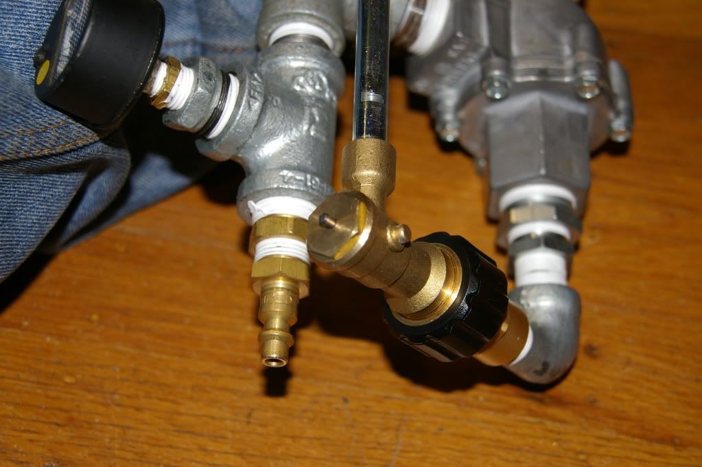

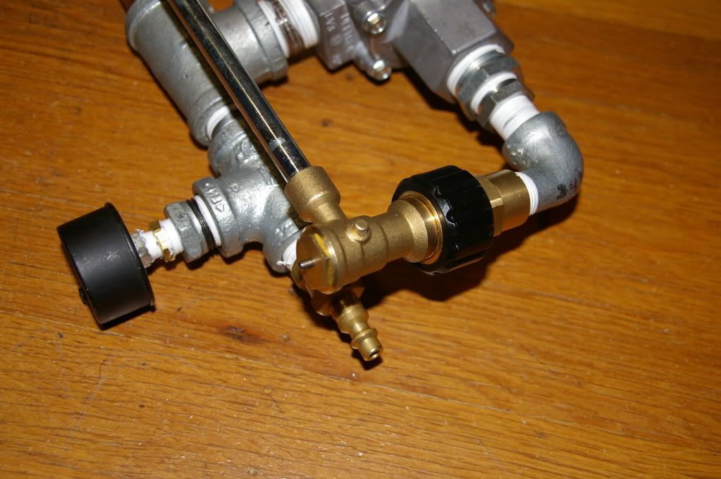

OK, double post, but man up and deal with it. I switched over to CO2 today, and ran into some serious problems. When I empty out the canister into chamber, it gets so cold that it actually freezes over. I tried pouring hot water on the canister to heat it up, which worked for a few more PSI, but when I gave up and unscrewed the inflator, I found a huge chunk of ice attached. Needless to say, the pressure I am getting is dismal... Only about 250psi, and I /NEED/ at least 300. I am considering turning the inflator upside down, to spit out liquid CO2, since I can't over fill the chamber, and that way the entire chamber could be a heatsink/radiator rather than just the cartridge.
This is definitely making a full paintball CO2 setup look a lot more attractive...
Any suggestions about making a heatsink or something will be greatly appreciated!
btw, the inflator is this one:
notice: the CO2 cart in the last photo was actually put in the inflator backwards, so as not to puncture the seal.
edit: videos up in a little bit... Youtube is down for maintenance.
On the CO2 the only comment I have is getting dry ice snow from releasing liquid CO2 is normal. Inverted or not, you will have to wait for the gas to warm to get normal pressure. Pre heating the cartridge is dangerous and doesn't work.

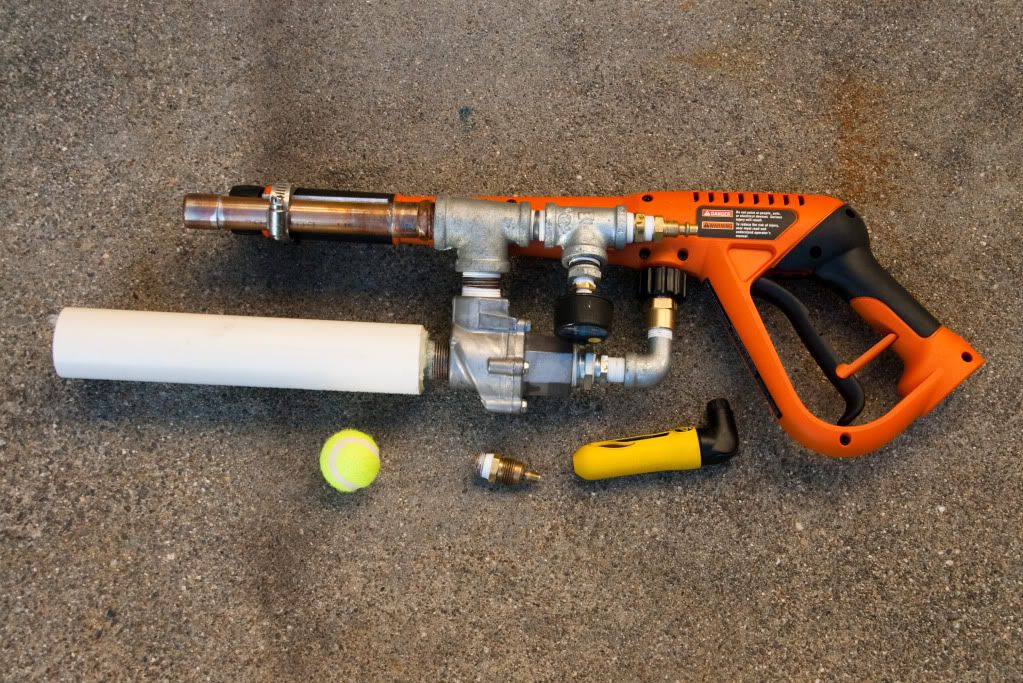

Alright everyone, another update here.
My most recent setup:
Notice the current setup is for use with my fridge compressor, but the fitting underneath is for use with the CO2 inflator, also shown under the cannon. For ergonomic issues, the barrel is on the bottom, though that may change in the future.
I need to get rid of the whole plastic junk around the pressure washer handle, because it is a good 6 inches of hollow plastic, tanking up space, and compactness is my highest priority. I am considering using BtB's new valve guy, because of how simple it would be to use, and I could do with out the billion fittings needed to convert from pressure washer fittings to NPT.
I am getting 160fps pretty consistently with 350psi (what I get from a fill with a 12g CO2 cart). I was really hopping for better, but it may be somewhat caused by my largeish pilot volume, and small trigger, because I was getting more like 250 with a 1/2" ball valve. We will see when I try the new valve system.
I had a serious freezing problem with the tire inflator, but turning it upside down while filling fixed that. Now the large metal chamber serves as a heatsink/radiator for the boiling CO2, so that the temperature doesn't drop as much in the cartridge.
I think I am just about ready to demonstrate this to the people interested in a cannon like this...
