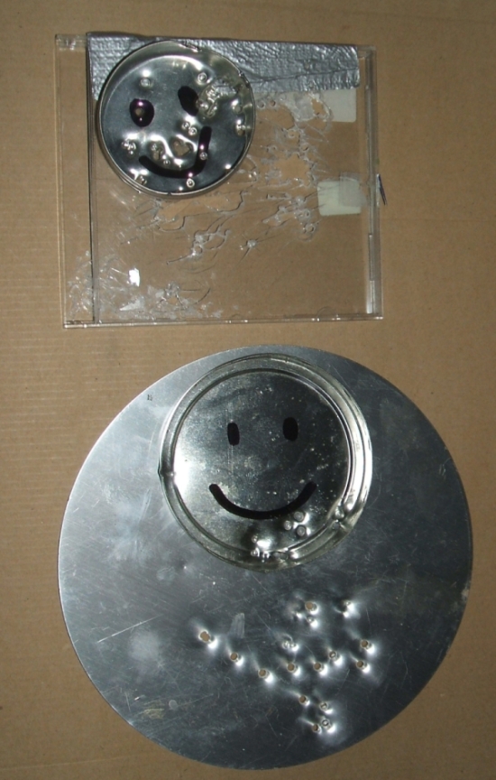

Following these thoughts, herewith a 3mm high pressure BBMG prototype:
Did some testing at 500 psi, pretty impressive stuff:
steel pellet tin lid with 0.5mm aluminium backing
steel pellet tin lid with CD case backing
Same as above, but with ball detent restriction removed.
Here's what's left of the targets, love the clean individual holes as opposed to the "rips" which ordinary BBMGs usually provide :)

did each burst use up the whole tank ??
POLAND_SPUD wrote:did each burst use up the whole tank ??
On the contrary, the videos were made from one fill, but I was only loading 20-30 BBs at a time.
so it seems that air consumption improved...
still I would like to see it using 6mm BBs (or .177 / 4.5mm ones) but even now the power is impressive
that's not the final version, is it? there are no final versions... :wink:
it could be turned into a pretty good gun with a better, more ergonomic and sturdy design as well as loading port... oh and larger ammo capacity so that you could hook it up to the larger tank to wipe out those bastard smileys
POLAND_SPUD wrote:still I would like to see it using 6mm BBs (or .177 / 4.5mm ones) but even now the power is impressive
That's the idea, I'm working on a concept for a larger calibre version, to be posted soon.
Just a small calibre prototype I always wanted to build, unfortunately over 500 psi the blowgun leaks. With 3mm BBs what I want to move on to is a burst fire version, with a pengun style piston valve feeding into a small 20-30 round cylindrical magazine that I can charge to 850 or so psi.

Obvious but important question: Do you feel the detent helps?
ilovetoblowthingsup wrote:Question...
Answer...
It helps if the air input is at a tangent to generate the circular motion that promotes reliable feeding.
Amazing, the world's fastest firing kitchen worktop off-cut!
Deceptive, isn't it :P
Certainly, it seems to reduce ROF and increase power as intended, though with too many BBs in the chamber it seems to affect feeding.

Awesome performance, makes your trek for a proper mechanism seem...ehhh.
alwinovich wrote:it sais N so i guess it must be nitrogen
It must be ;)
inonickname wrote:Awesome performance, makes your trek for a proper mechanism seem...ehhh
Aye :) high pressure makes all the difference. I would have loved to try it out at 850 psi but the blowgun seems only to be good till 500.

Another question..did you keep your barrel flush with the inside of the pipe?
I'm almost certain but I can't really tell from your picture..If it wasn't it probably wouldn't even fire...
That must've been tricky to secure inside there? to keep it flush... Oh well i guess with epoxy all things are possible
