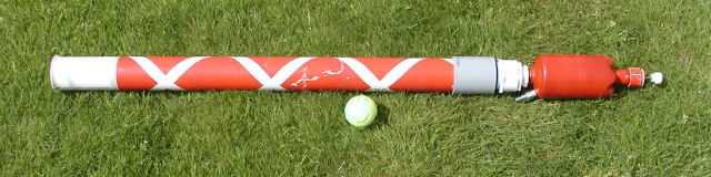

Sometimes it is easier to build from scratch to meet your needs. I did that with this TB cannon.
Marshmallow cannon with TB barrel.  100 yards on 60 PSI.
Tennis ball barrel1.jpg (36.58 KiB) Viewed 4014 times

Nice video. I don't have a easy source of high pressure air, so I built to match a typical bicycle pump or shop compressor. For that reason I have a larger diameter valve and larger chamber.
That is a very nice unit and well made. At that operating pressure, it uses almost the same volume of air per shot as mine by using much higher pressure in a smaller chamber.
