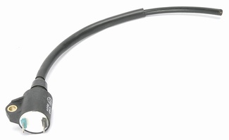

Hi
I recently bought an ignition coil
http://www.thansen.dk/product.asp?c=286 ... 1681984759
a 12 volt scooter battery and a spark plug.
but i cant get the spark plug to light.
can someone draw or explain to me how i have to set it up to work.
i have seen other drawings of how to do it but that was with a different ignition coil :(
Thank you
From Esben, Denmark
the ignition coil
the ignition coil

You might just try it with a 9V battery. Just touch the battery's posts to the two spade plugs on the coil. Stick a piece of wire into the end of the high tension wire and bring it back around near one of the two battery contacts. Rock the battery on the contacts so the electrical contact is made and then broken.

jimmy101 wrote:You might just try it with a 9V battery. Just touch the battery's posts to the two spade plugs on the coil. Stick a piece of wire into the end of the high tension wire and bring it back around near one of the two battery contacts. Rock the battery on the contacts so the electrical contact is made and then broken.
What is that coil for? There isn't much info on the linked page and the only Swedish I know I learned form the Swedish Chef on the Muppets show. :D
jimmy; my best "edumcated" guess would be the brass colored mounting hole is actually the ground for the HV side, the blue marked tab is the battery +, and the other terminal is battery -. The connection between mounting hole and battery may not be internally connected. These two connections are definitely connected when mounted for it's original application.
I could be wrong, depends on how it was manufactured.

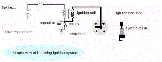

For how to use it, infomation on kettering ignition see, http://en.wikipedia.org/wiki/Ignition_system
Transformers are not compatible with DC. To use them a pulse is needed. Either a high voltage pulse from a camera flash is used (call Capacitive Discharge Ignition DCI ) or a current of low voltage is allowed to build in the inductive windings and a high voltage pulse is generated when the current is suddenly interrupted. To properly form the pulse a capacitor is needed in addition to the points (Switch).
Even though the low voltage side is fed low voltage DC a high voltage spike is created when the switch is opened. Don't get your finger on it because it is very unpleasant.
Leaving DC connected to the coil will burn it out if a current limiting resistor is not used.
Kettering ignition

Most auto ignition HV coils are "autotransformers". That means they are three wire devices and the primary and secondary coils share a connection. You hook up voltage to the two primary connections. The HV connection (the one with the big fat cable) is one side of the secondary. The other side of the secondary is one of the two lugs on the primary.
I would guess the copper pipe looking thing in the mounting hole is just so you don't collapse the bracket with the mounting bolt. But it could be the other HV lead. So, see if the HV lead sparks to it as well as to the two spade lugs.
You don't necessarily need a signal generator. An ignition transformer will usually give a decent spark if you just hook it up to a voltage source (on the primary), wait a moment then disconnect the source. That's all that a set of mechanical points does, though the points do it repeatedly.
You should be able to just wire a pushbutton switch in series with a battery and the coil. Push the button. When you release the button you should get a spark.
The "condenser" in the old style auto ignition circuit actually does a couple things. Besides protecting the points from the coil's back EMF it also contributes to the pulse shape. If you omit the cap the pulse shape isn't as nice and the spark energy decreases.
