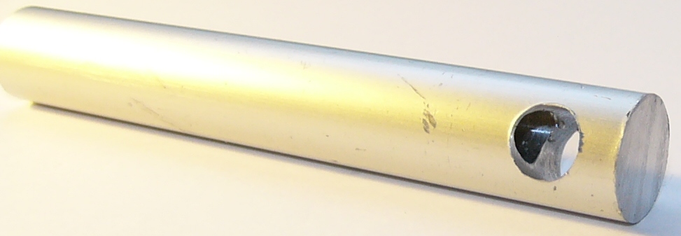

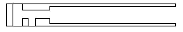

I'm trying to drill a rod out to the shape below, and having trouble keeping the bit perfectly centered on the long one. You can see how far off it is after 4". And the problem will be amplified when I make the wider pass.
I realized after I should have tilted the table 90 degrees, and clamped it along the length. But any other tips for making a more precise hole, or how to line it up with the bit? Should I drill the wide or narrow part first?

Always drill the more narrow part first! This ensures that the two different diameter holes are true to one centerline.

Maybe you should look into making the "complicated" part (on the left in the diagram) out of massive material, and the long, hollow part out of a tube which you connect with bolts, epoxy, threads, oring, whatever.
That way you do not have to worry about going off-center and having variable wall thickness.

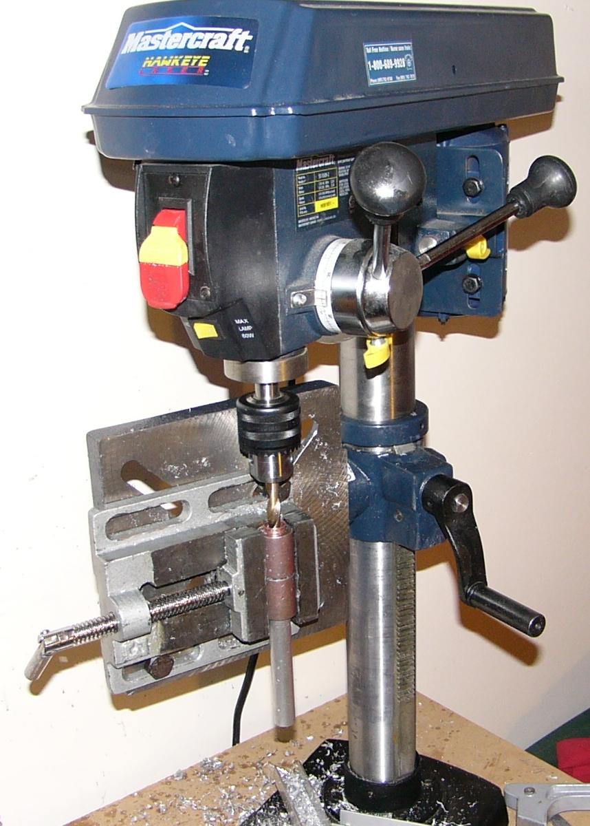

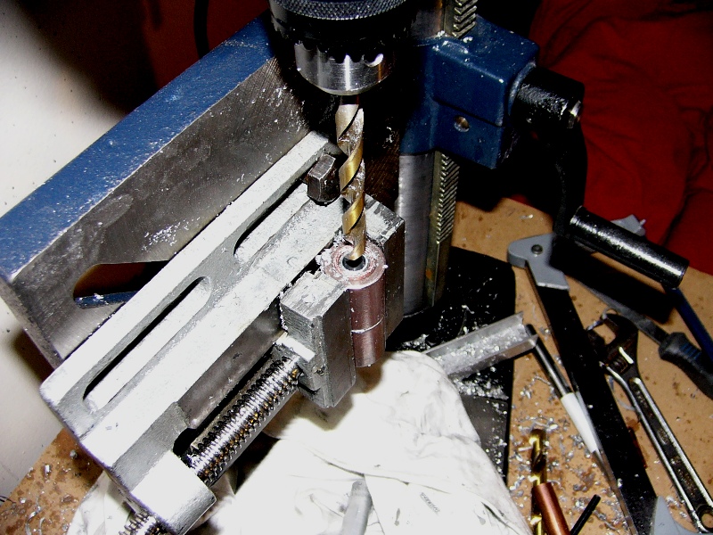

There was a lot of good suggestions here, but I thought I'd try the simplest with what I had at hand, and work up from there. I don't know what they are from, but my dad gave me these two short sections of thick metal tube from work a while back, and they happen to have a 5/8 inside diameter, so I was able to use them, with several diminishing sizes of tube inside for the drill bit, as bushings (correct term?). One will also form the outside of the valve eventually.
I left the bit (3/8") in the chuck, because it is only 1/2". The tube bushing kept riding out, and I didn't have any blocking under the stock, just held it by hand, but slowly managed to make it through. Shortened the bore hole to 3.5".

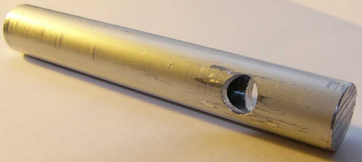

I think it may be as good as I will get without buying more stuff. It's off by .004" at the start and .014" at the cross hole. I suspect there may have been some luck involved :P. Still have to drill the wider pass, because it got too late (no I don't have a curfew, I just don't want to piss off my neighbours - joys of apartment living), so we'll see.
