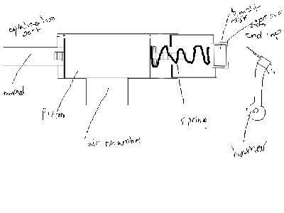

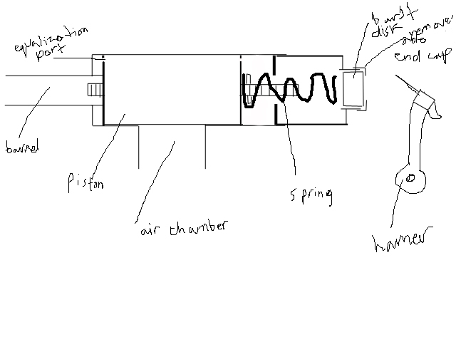

Hello,I will be leaving for my family cabin in Montana this Friday instead of being cooped up in darn ol' london, so I will have plenty of space and time to build a more powerful air gun. The following drawing is my first attempt at creating a piston valve air gun. Please add constructive criticism, tell me if it would work. Basically its a piston valve actuated by a burst disk. Hope my drawings clear enough! lol.

ummm yeah but you have to know a little about both valves before you try it first of all shrapnel from your burst disk can be very dangerous at close range sometimes they will imbed themselves in a target(so towards your face or body isn't a good idea). but if you really want to have a hammer actuate it i would make a push button valve put it in place of the burst disk. what i would do is get rid of the spring and make one that uses a normal pilot but thats just me :wink: ps: there is no need for the equalization port

thanks but my mechanism to actuate it is a little different now. you have a threaded endcap filled with dried glue. you pull back the hammer behind it, pull the trigger, and the needle on the hammer puntures a small hole in the cap. This releases a small stream of air, not to explode the cap. When shot, unscrew cap, screw in new one etc.

If you're going to go to the trouble of using individual burst disks for each round then why not use a burst disk as a main valve?
Porting a piston with a burst disk will give no performance increase compared to say a QEV.
Edit: By the way, the scale of your gun is massively out of whack.

Exactly. A hammer valve to port it will work just as well depending on size.
As a note for the scale, the barrel needs to extend well over the chamber port.
