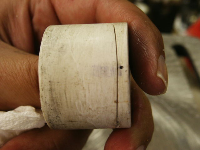

Been there done that.. My Dragon 2.5 inch coaxial used that. Short story, it's brittle. It cracks, It shatters, It's only good for a couple shots. That is why my breech photos posted elsewhere don't have a piston. It's long retired itself. I do not recommend PVC pistons. They don't last.mark.f wrote:If you are making a 4" piston, I would use 3" SCH-40 PVC fittings, with space between them to sandwich 1/4" O-ring stock. It's worked for me excellently for smaller pistons (2" diameter made with 1-1/4" fittings and off the shelf o-rings), so with a little tweaking (and gluing your own o-rings), it should work for much larger ones.
The Apple cannon is my longest lived PVC Piston. It uses a foam football core that is as long as the piston for a bumper and the PVC is double layer thick except for the o rings.
If you used them for smaller pistons, how did you get them to survive? I went through 4 pistons on the Mouse Musket before I retired it. It used a 1 inch pipe cap for a piston.

A sufficient bumper and limited piston travel.Technician1002 wrote:Been there done that.. My Dragon 2.5 inch coaxial used that. Short story, it's brittle. It cracks, It shatters, It's only good for a couple shots. That is why my breech photos posted elsewhere don't have a piston. It's long retired itself. I do not recommend PVC pistons. They don't last.mark.f wrote:If you are making a 4" piston, I would use 3" SCH-40 PVC fittings, with space between them to sandwich 1/4" O-ring stock. It's worked for me excellently for smaller pistons (2" diameter made with 1-1/4" fittings and off the shelf o-rings), so with a little tweaking (and gluing your own o-rings), it should work for much larger ones.
Most of my bumpers consisted of 1/4" of plumbing rubber, and less than an inch of piston travel. I've never had a PVC piston crack or deform in any other way.
