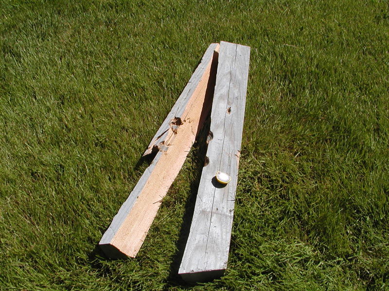

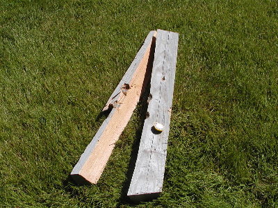

Other than a larger dead space, you are right on. It is the reason I am building a 3 inch valve as my next project, even though the goal is supersonic marshmallows and golf balls. The dead space volume is larger, but the opening speed factor and flow restriction when open is what it's all about. Well done. I get fantastic speeds on jawbreakers using a 3/4 inch barrel on my 1 inch valve cannon.
2X4 split with jawbreakers

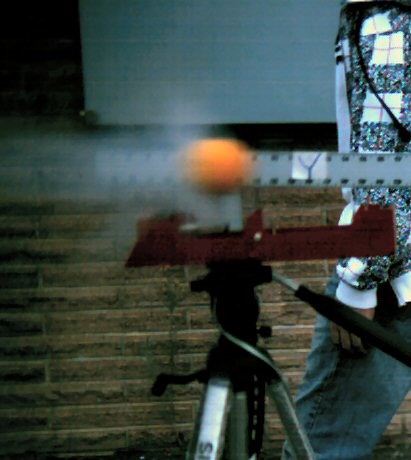

In testing we got this shot of an orange we launched. How fast does an orange have to go to have a shock wave? :D
High speed orange.
High speed orange.
