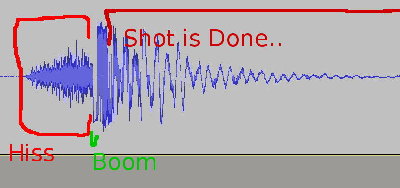

You are correct. There's only 6.0 in3 of pilot air volume (holding back 14,000 in3 of compressed volume). Original, I did need the fast pilot air release to break a vacuum forming at the piston face seal. After doing some corrective machining (larger bore around the forward piston body), fast pilot air release is no longer necessary as the piston can now be released with not much more than a thought. Now I keep the trigger and linkage because I like the mechanical appearance.
spot wrote:I think there's not much pilot volume at all, and he uses the spring loaded ballvalve to dump it as fast as possible. If I recall correctly, his valve didn't actuate very fast when he was using a smaller pilot valve. He needs that much pilot volume for it to not constrict flow.
This is a common misconception. It ignores the fact that;
1 air is compressible.
2 when a narrow ratio valve (diameter to seat) is used, the valve remains closed until the pilot pressure is very low.
As a result, a slow pressure drop due to a huge pilot space only creates a delayed opening, but when it does open, the air pressure rise between the projectile and piston face does indeed get it the he*l out of the way. Even the mass of the air in the barrel and the flow resistance is enough to make them pop open.

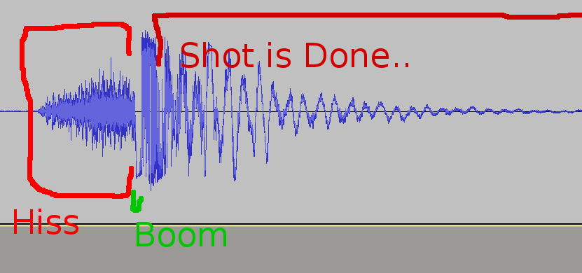

I understood the theory and had to test it myself. It is the primary reason the Mouse Musket was built. The Mouse Musket does use a small pilot valve. It does have a delay from the trigger to the main valve opening, but that main pop is impressive. This shot is a dry fire with no projectile. Opening times are faster with a projectile present.
Picture added of the Mouse Musket sound waveform at 30 PSI with small pilot ball valve. Audacity, a free audio editor was used to view the waveform. http://audacity.sourceforge.net/
In conclusion, there is nothing wrong with using a ball valve on a proper narrow ratio piston valve.
EDIT I almost forgot the most important part.
:wav:
Well Done velocity3x
Sound waveform of the Mouse Musket.  The hiss portion is with the piston closed while the pilot pressure bleeds off.  The slow rise in hiss it the manual ball valve being opened.  I was in no hurry for the test.

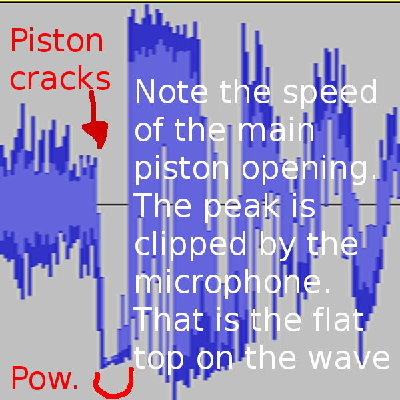

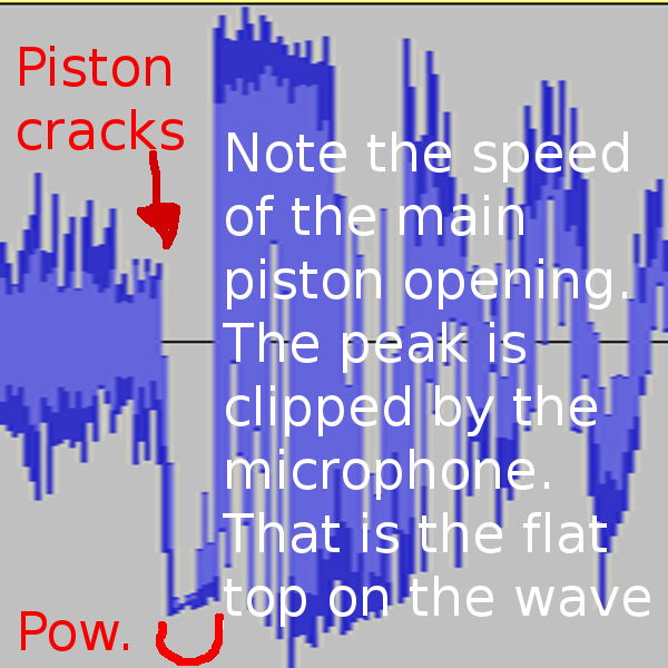

Crack to full open time is very short.

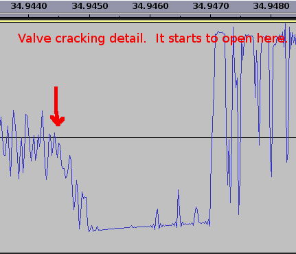

Valve cracking open expanded with the time line above.  Flat bottom is due to the sound system clipping.  Note the duration of the main wavefront is only about 3 mS long.  In contrast the Hiss is 200 mS long.
